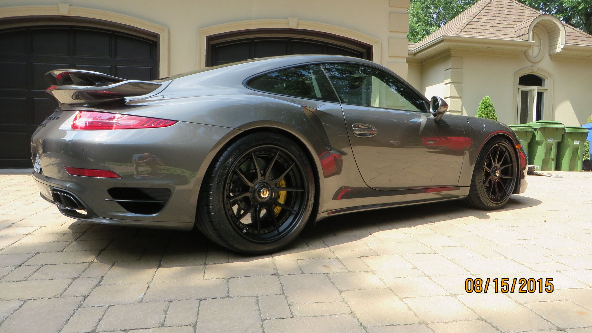

I run Michelin PS2 335/30/20 on ADV 12.5 x 20's. Would work much better for the OP since he's trying to get a higher profile, which this is. 265's might rub on the front, depending on the offset. I run 255's with a 30mm lowering and have no issues.
At the OP...here's shot of my 335/30/20 rears on 12.5's. You could also go to 325's and you'd have a slightly lower side profile.
335/30/20 on ADV1.5 12.5's...

now we're talkin those look awesome! Any issues at all with RWS, speedo, pasm, pdcc? Who spec'd the offsets?
Old Nov 16, 2015 | 06:10 PM
BLOWN SRT's Avatar
Joined: Jun 2015
Posts: 409
From: Quebec
Rep Power: 80
BLOWN SRT Is a GOD !BLOWN SRT Is a GOD !BLOWN SRT Is a GOD !BLOWN SRT Is a GOD !BLOWN SRT Is a GOD !BLOWN SRT Is a GOD !BLOWN SRT Is a GOD !BLOWN SRT Is a GOD !BLOWN SRT Is a GOD !BLOWN SRT Is a GOD !BLOWN SRT Is a GOD !
Not a single issue and in fact, a very nice/ smooth ride. ADV1 spec'd the offsets. You could call Wheels Boutique and speak to Ben. He'd know or could find out; they came from him.
