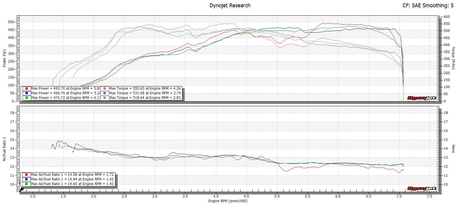

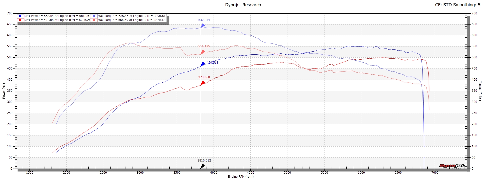

Yeah I have to agree with this because I had Cobb measure my car with bolton's only which included FVD exhaust, headers, IPD Y-Pipe, IPD Plenum and ByDesign IC's. In that config it measured 502 whp which compared to 493whp with the FVD piggyback, headers and exhaust back in September. Without the piggyback in September the max hp with boltons only in sport plus was 474 hp and in normal mode it was 466. So I think the ECU will allow for airflow to make more horsepower as long as the safety parameters are not exceeded. The data I have seems to suggest that is the case. In the top graph the blue is Cobb Stage 3 before custom tuning and the red is boltons only. In the bottom The red is with the FVD piggyback, FVD headers and FVD exhaust. Blue is normal mode without the piggyback and green is sport plus without the piggyback. Point being that with the ICs and Y-Pipe there was an additional 26whp added. I don't know what my car is without the exhaust but I believe it would be less because it has 200 cell cats along with that exhaust.

Both are correct. There are limits that get hit and corrected for, but it takes a few hardware mods to get there. So bolt-ons help by increasing efficiency but their max potential can only be realized if the car is calibrated. Above that you can dial in or even custom tune further to take full advantage of the hardware changes. This is true on any tune factory or aftermarket depending on what it's calibrated for.
