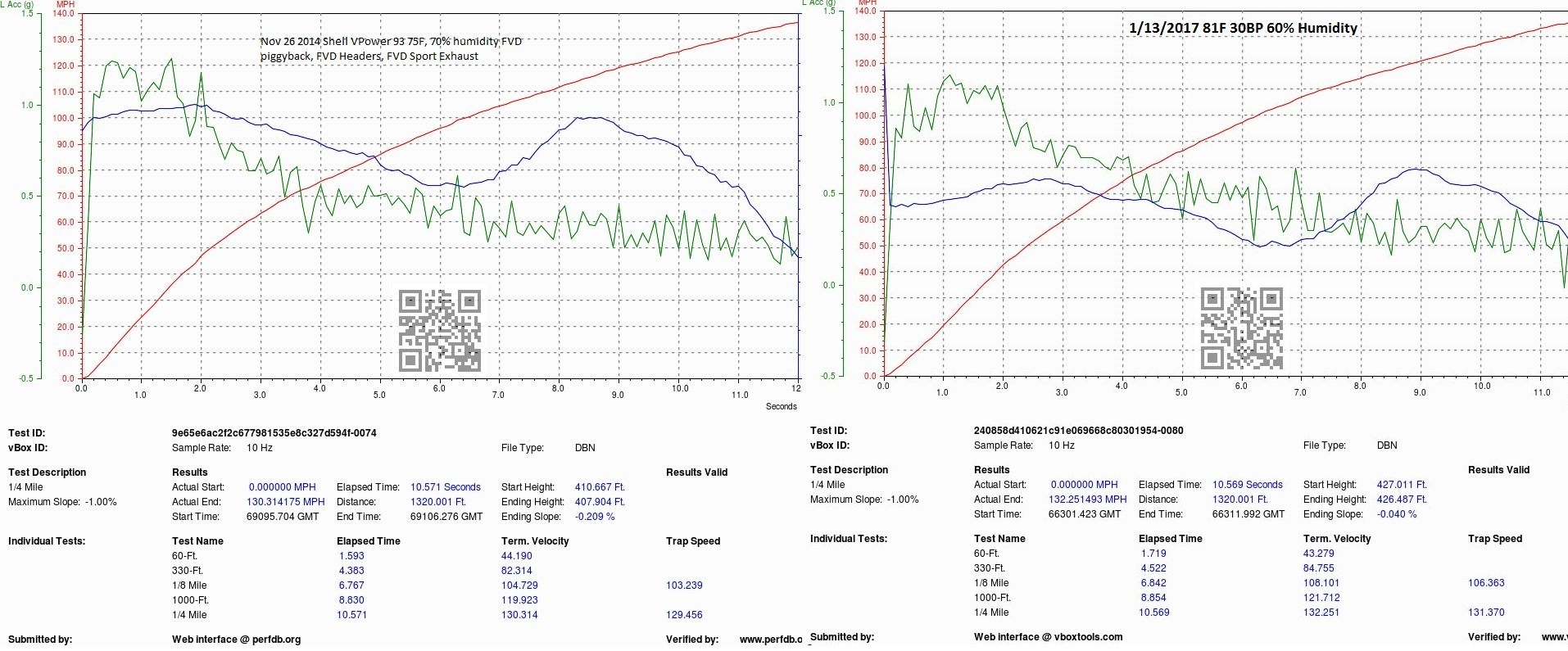

SO here is an interesting comparison. The left graph is with a new set of PZeros back when the car only had 4k miles on it. They were the original tires except the right rear was completely new since it was replaced under tire warranty a week after I got the car. This was the first run I made with the FVD piggyback and I cut a 1.59 60ft on the county road at 75F. The second graph is two years later with a set of PZeros that have two track events on them and about 6k miles or so. The temp is 81F and so I should get good grip but the car spun like crazy and I got a 1.72 60ft. Still the ET is better than with the piggyback and the tires are probably pretty hard due to the vulcanization but the 60-130 was 7.48s compared to 8.09s with the piggyback and the trap was 131.37 vs. 129.45. After the initial traction advantage the power of Stage 4 shows up but it still potentially has traction issues which could be the reason the rev limiter is coming on. The Porsche tech thinks that is possible, Carlos does too. I am waiting to be convinced, hopefully the car is available tomorrow and I can get out to the CR in some 60 degree weather which is ideal.
Assuming this is traction, I should see 10.3 @ 134-5 on pump gas.
Here is my run from this weekend with 50 degree weather which was a bit over a -1000 DA . Amazingly despite the cool temps it hooked extremely well with the N1 Pzero 35 front/ 41 rear hot pressure. With a good DA I would think high 130's on 93 octane for your stage 4 setup.

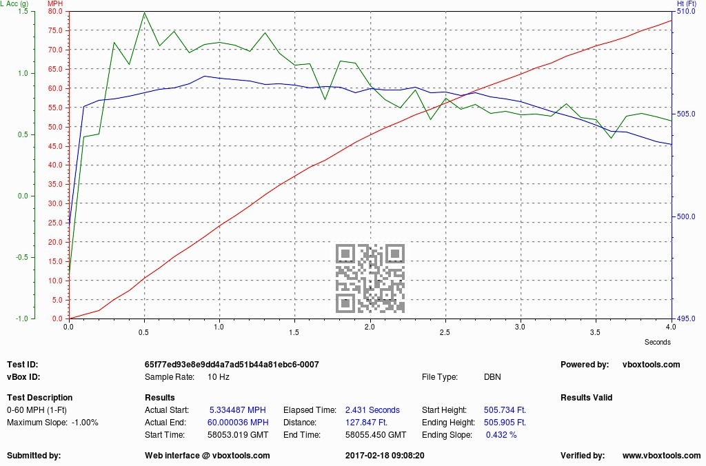

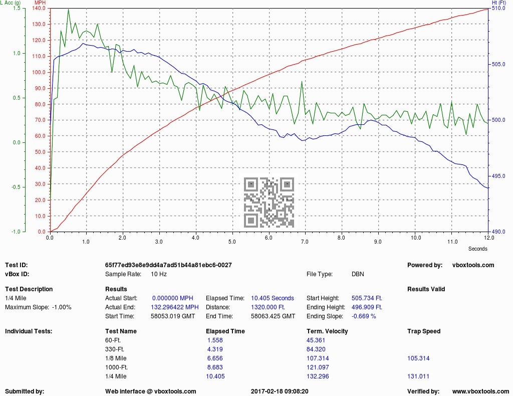

1.55s 60ft 0-60 2.75s and 2.43 with 1ft rollout, 1/4 mile 10.40 @ 131 on 93 pump gas
Since this is about tires, here is what I did with the new PZero N1 on stage 4 hardware but Stage 3 map on a county road. I had a modified Stage 4 map that didn't pan out but I am putting the stock stage 4 map back on now. I will report when I get those results.
