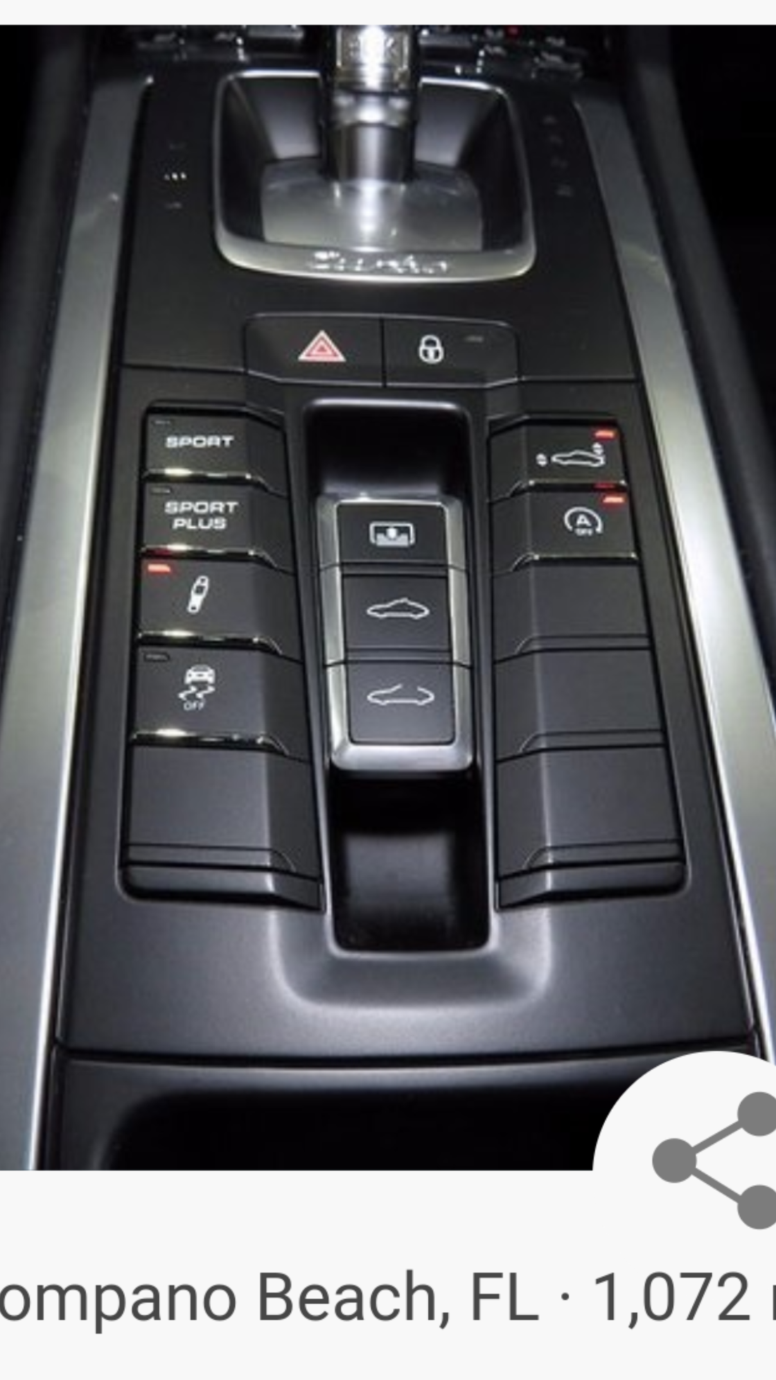

My only other question that I can't seem to figure out is the button that is the pdcc ... I have attached a picture. The cars i'm finding that do not seem to have that option still have that button with that picture of what looks like I'm guessing a shock??
If the car does not have pdcc then what does that button do? Also how much of a must have option would you guys say PDCC is? I know t
he sports Chrono seems to be the real must have option from the research I've done so far.
thanks again

The button changes the suspension between comfort and stiff/racing. If the car has PDCC it will say it there. But don't confuse the button with PDCC. PDCC is always on when the car has it. If it doesn't say PDCC on the button the car doesn't have it. It came standard on the S but not on the Turbo.

If you're going to track the car or drive it spirited in corners PDCC is a must have. If you drive like Miss Daisy don't waste your money.

The button with the shock is PASM on/off (Porsche Active suspension Management) 10mm lower ride hight or SPASM the Sport version which is 20mm lower. The ride hight is not adjustable through the switch by the way. It is an electronic continuous damping adjustment that will adapt to Sport Chrono settings (normal, sport, sport plus).
