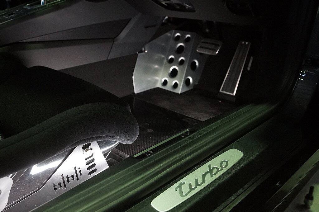

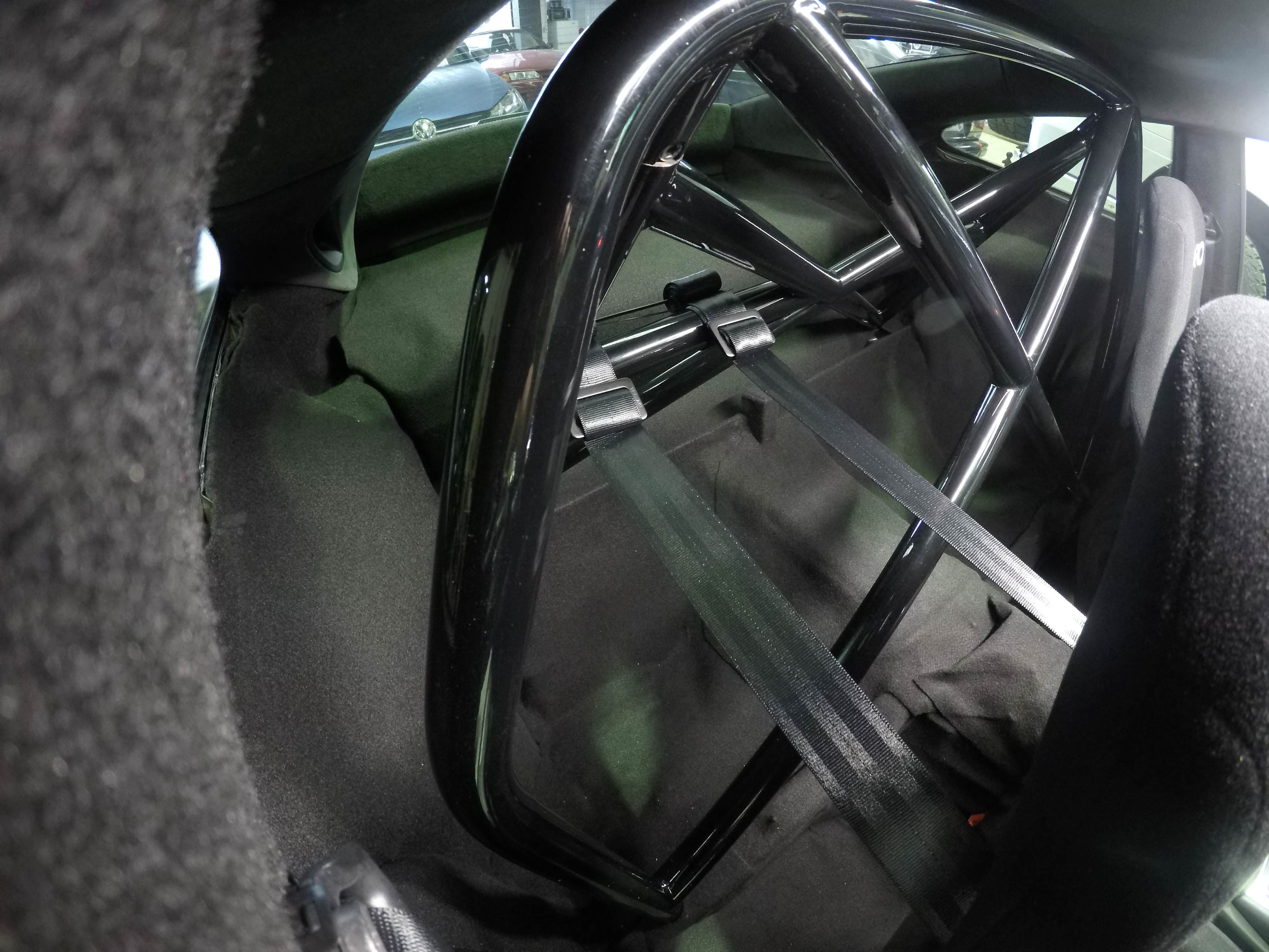

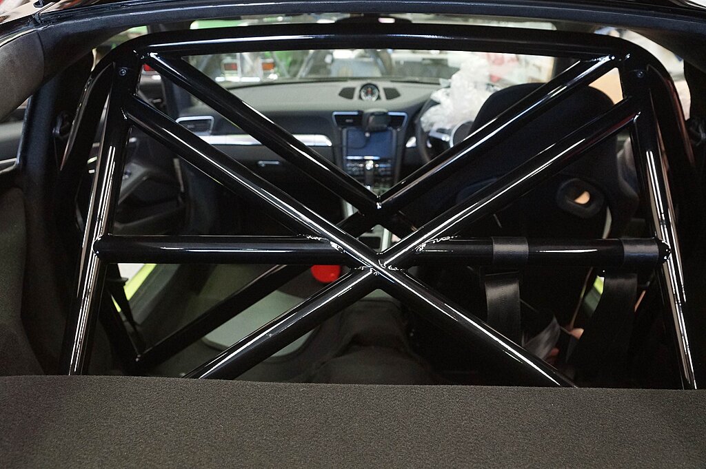

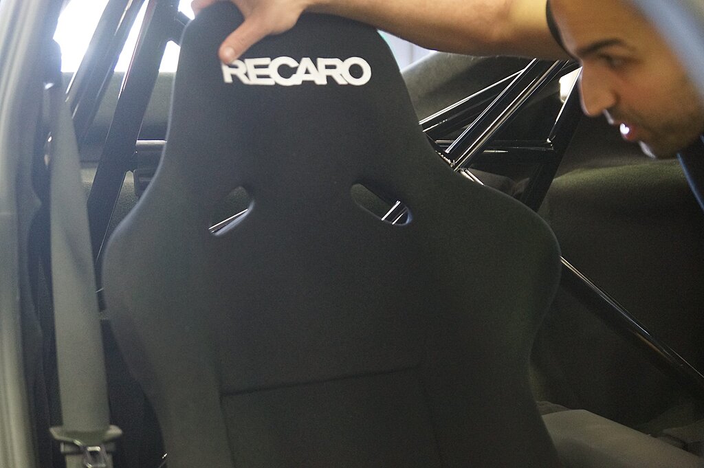

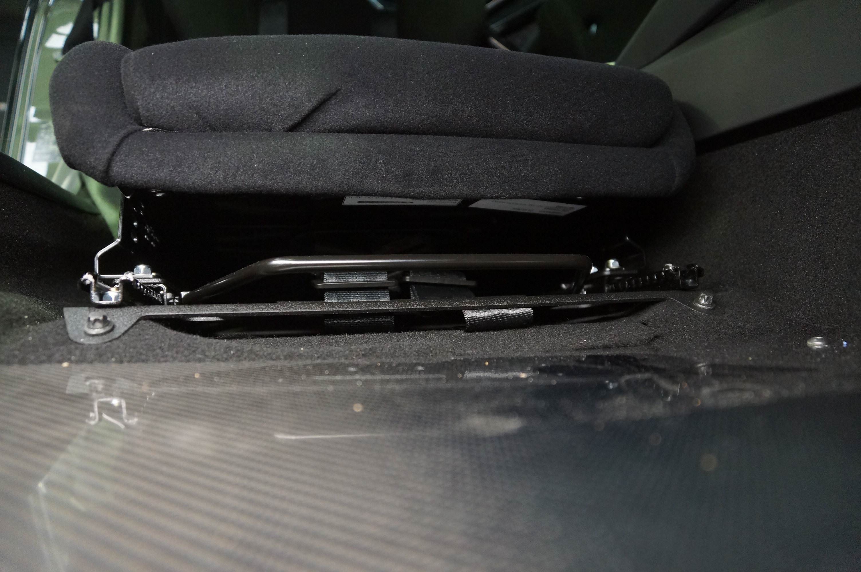

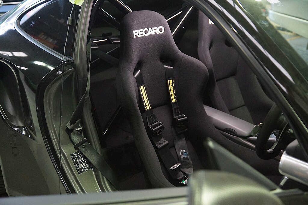

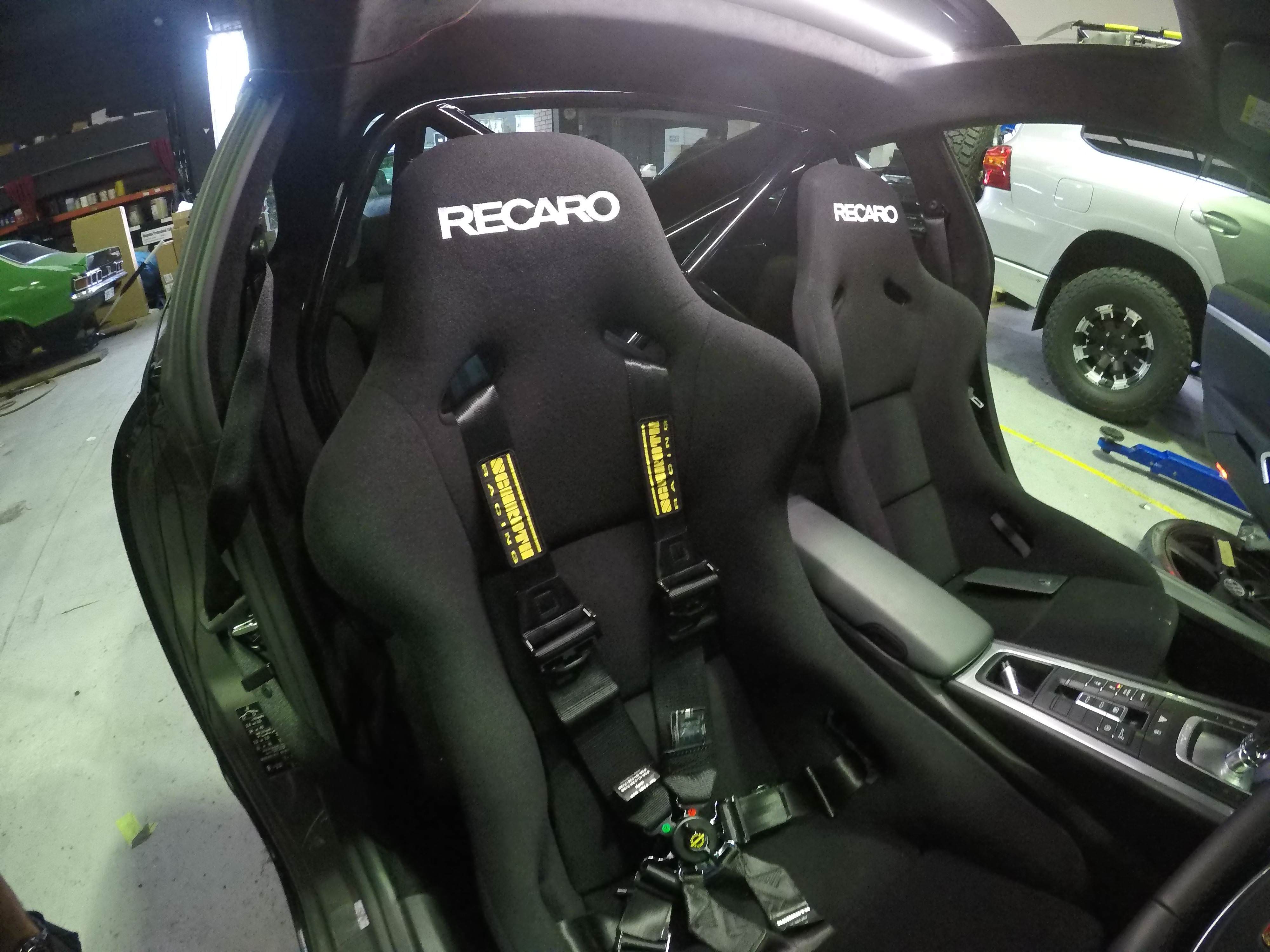

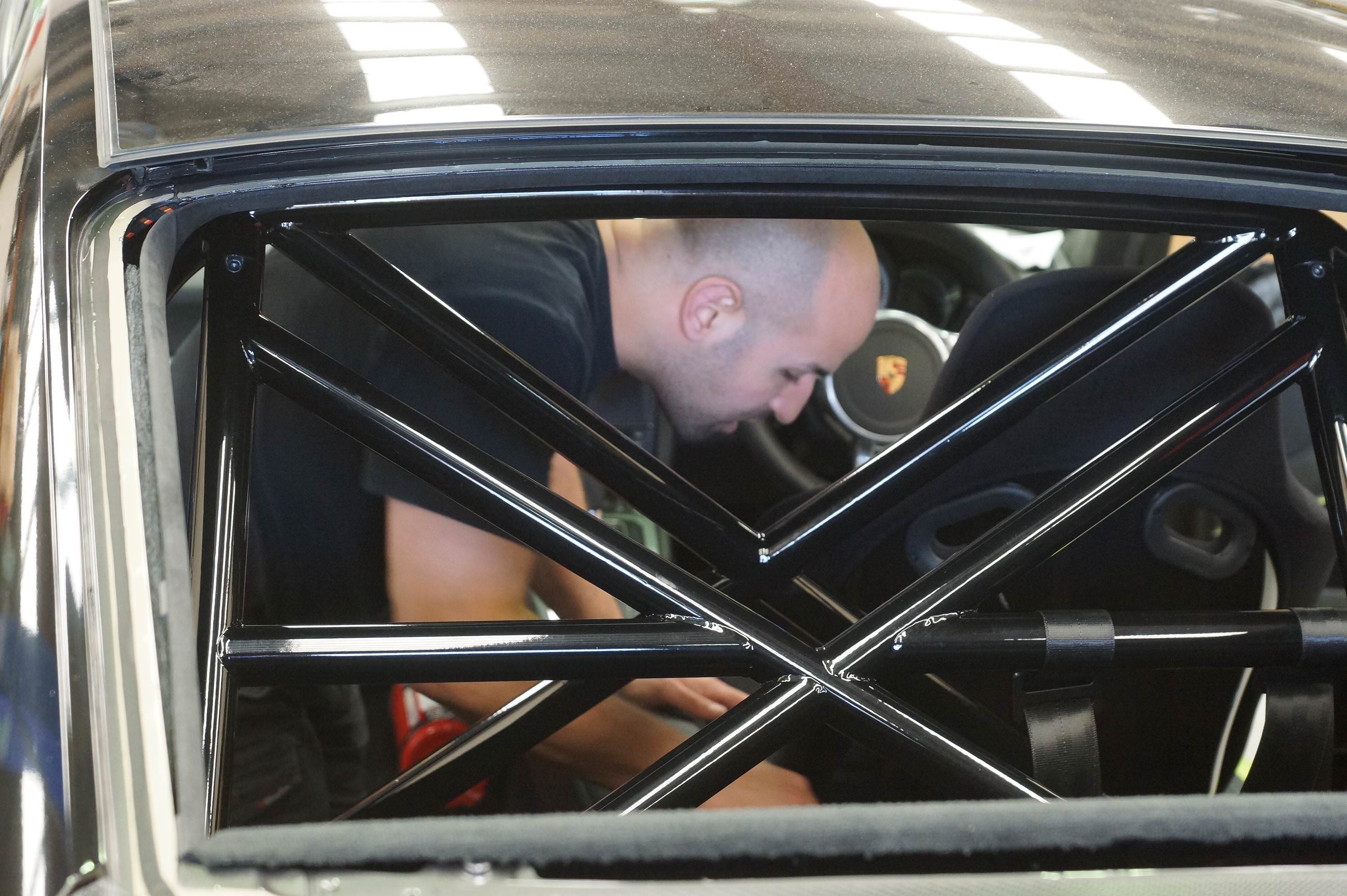

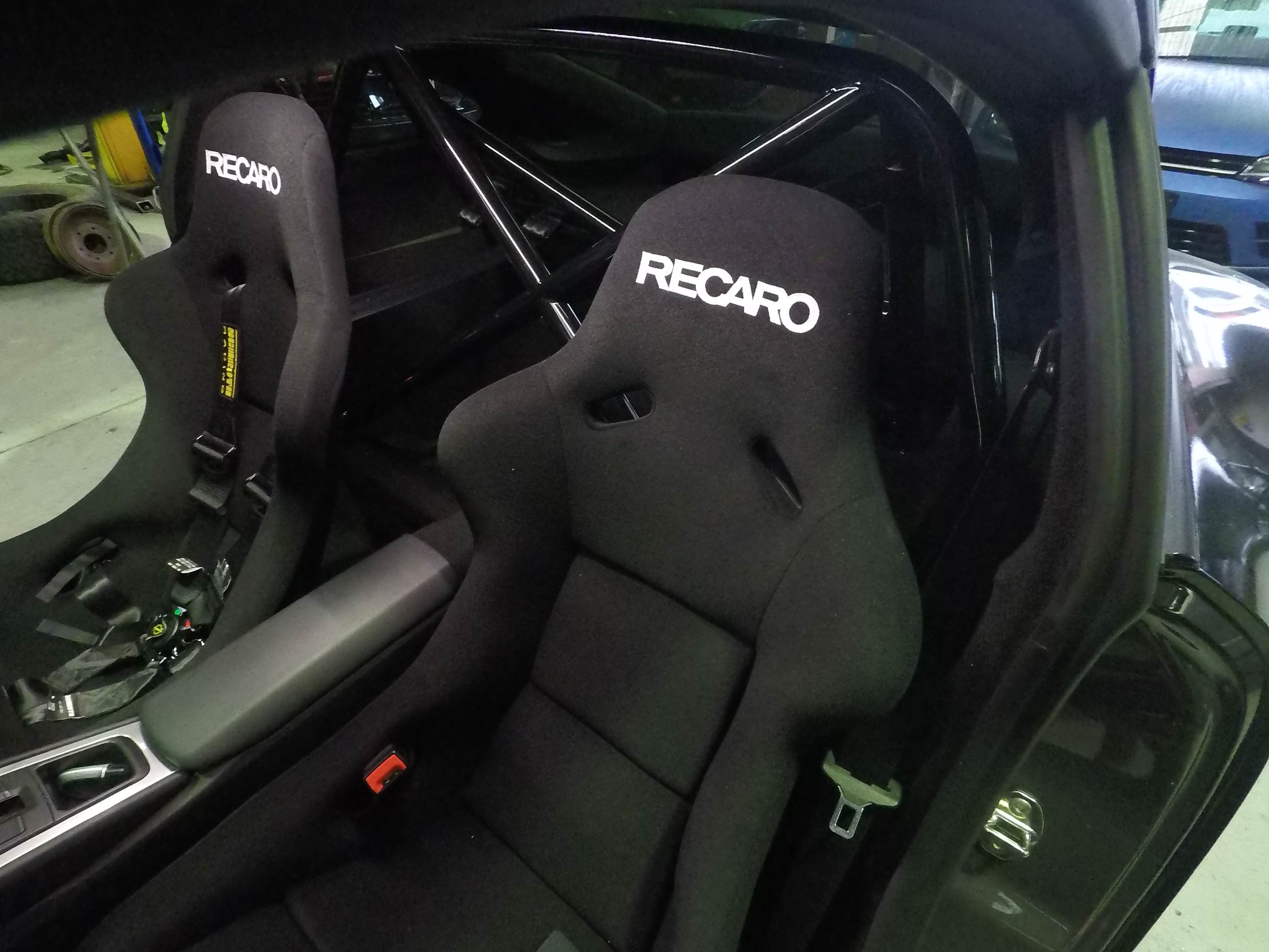

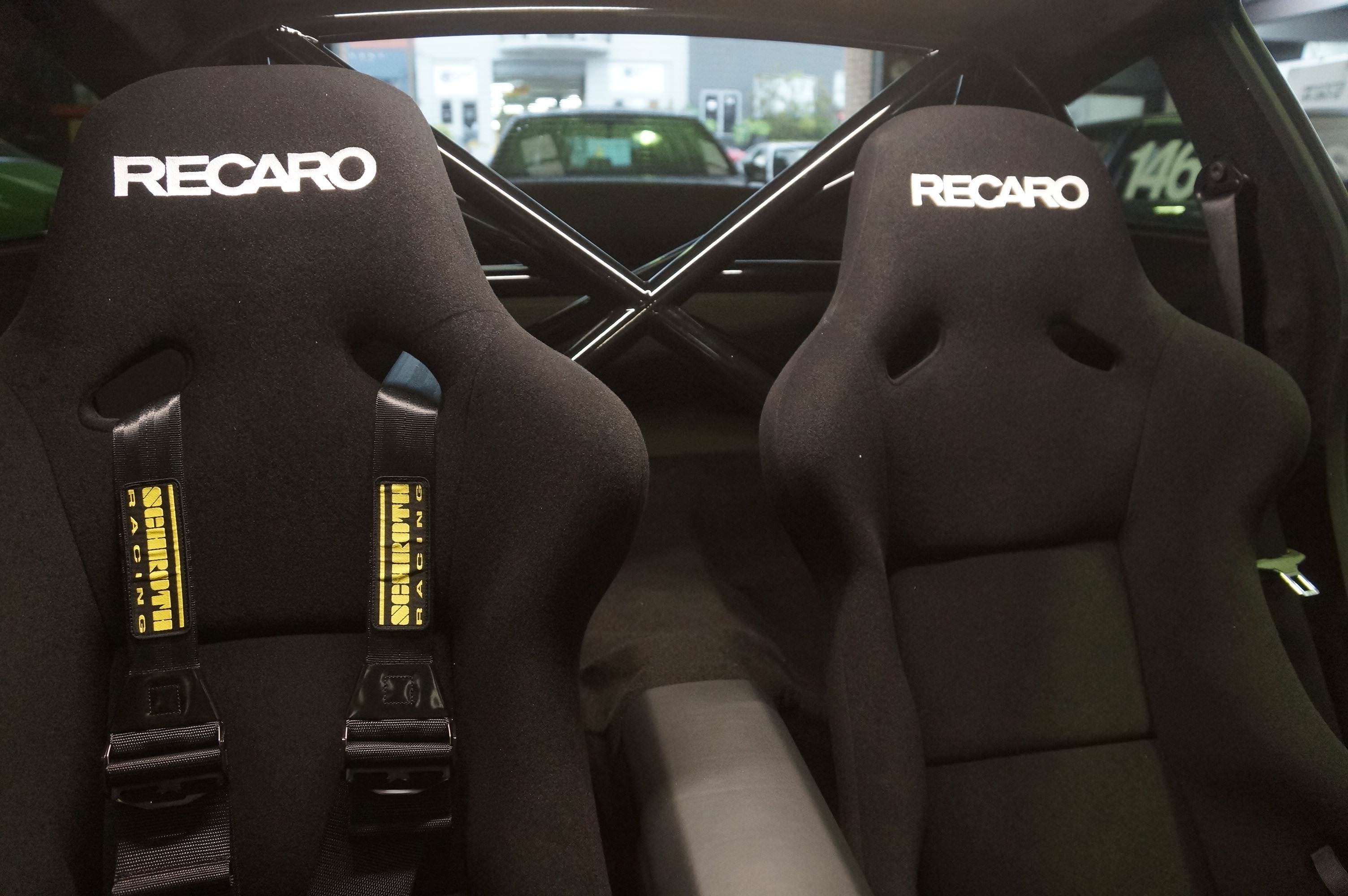

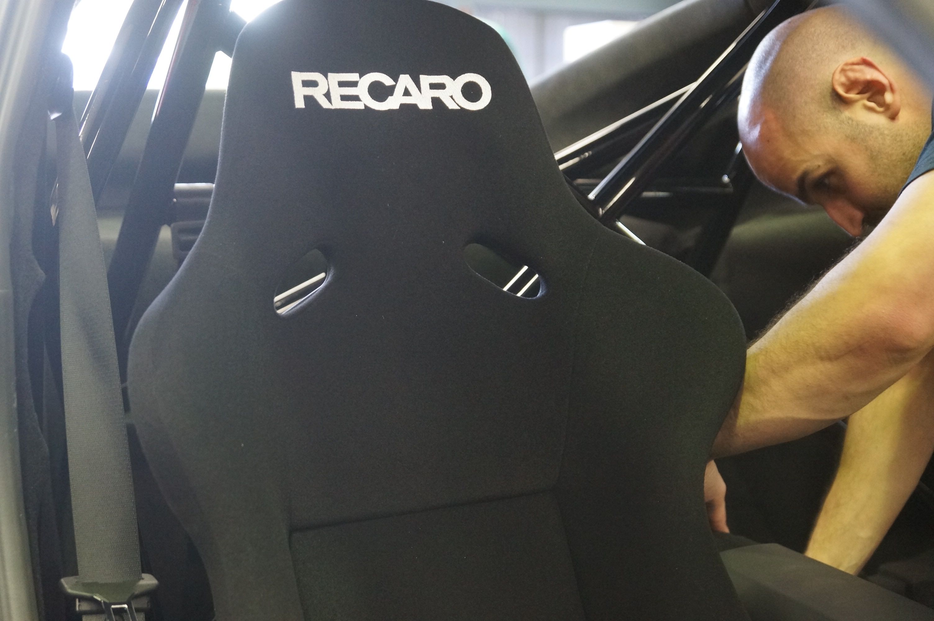

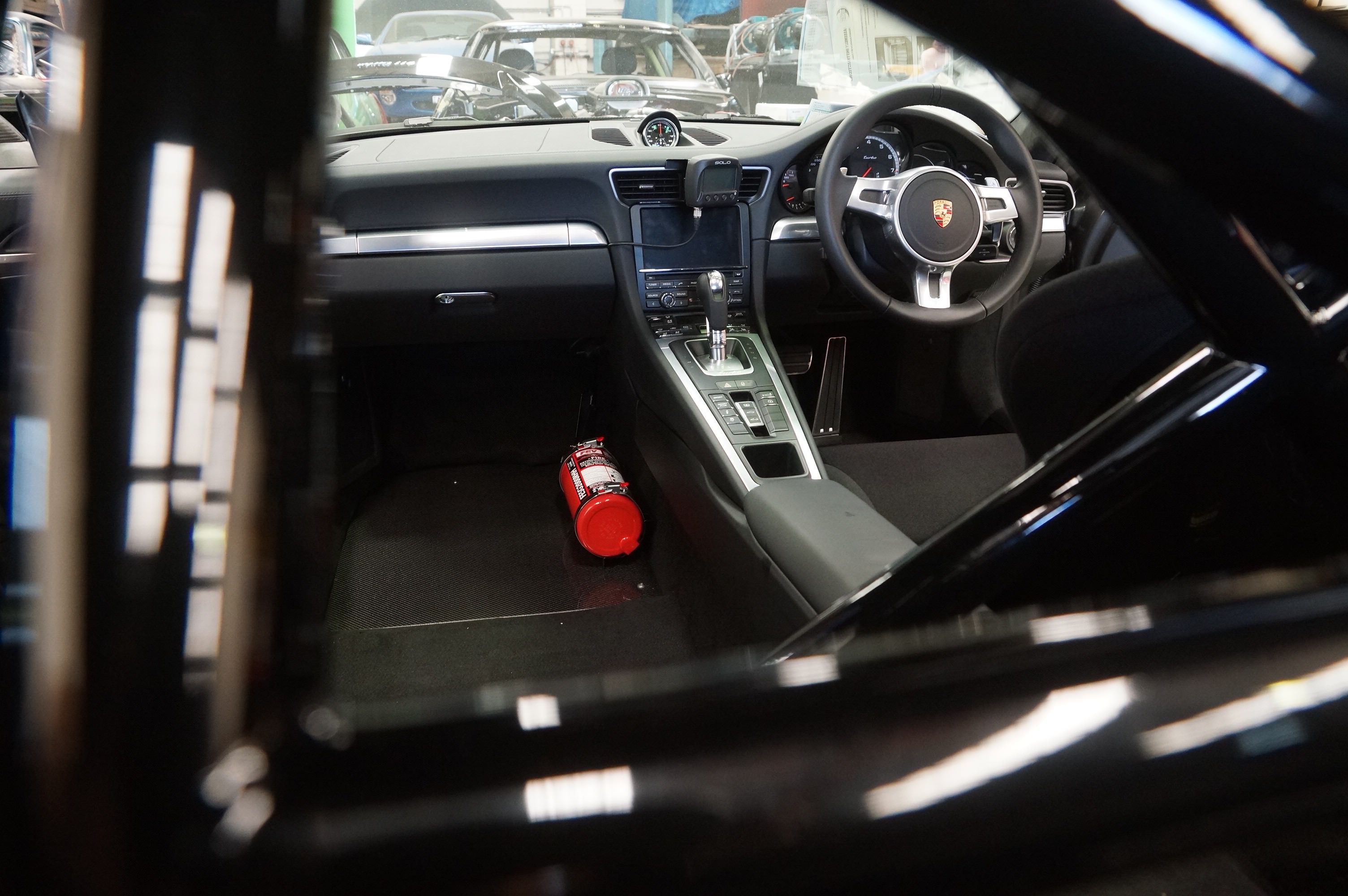

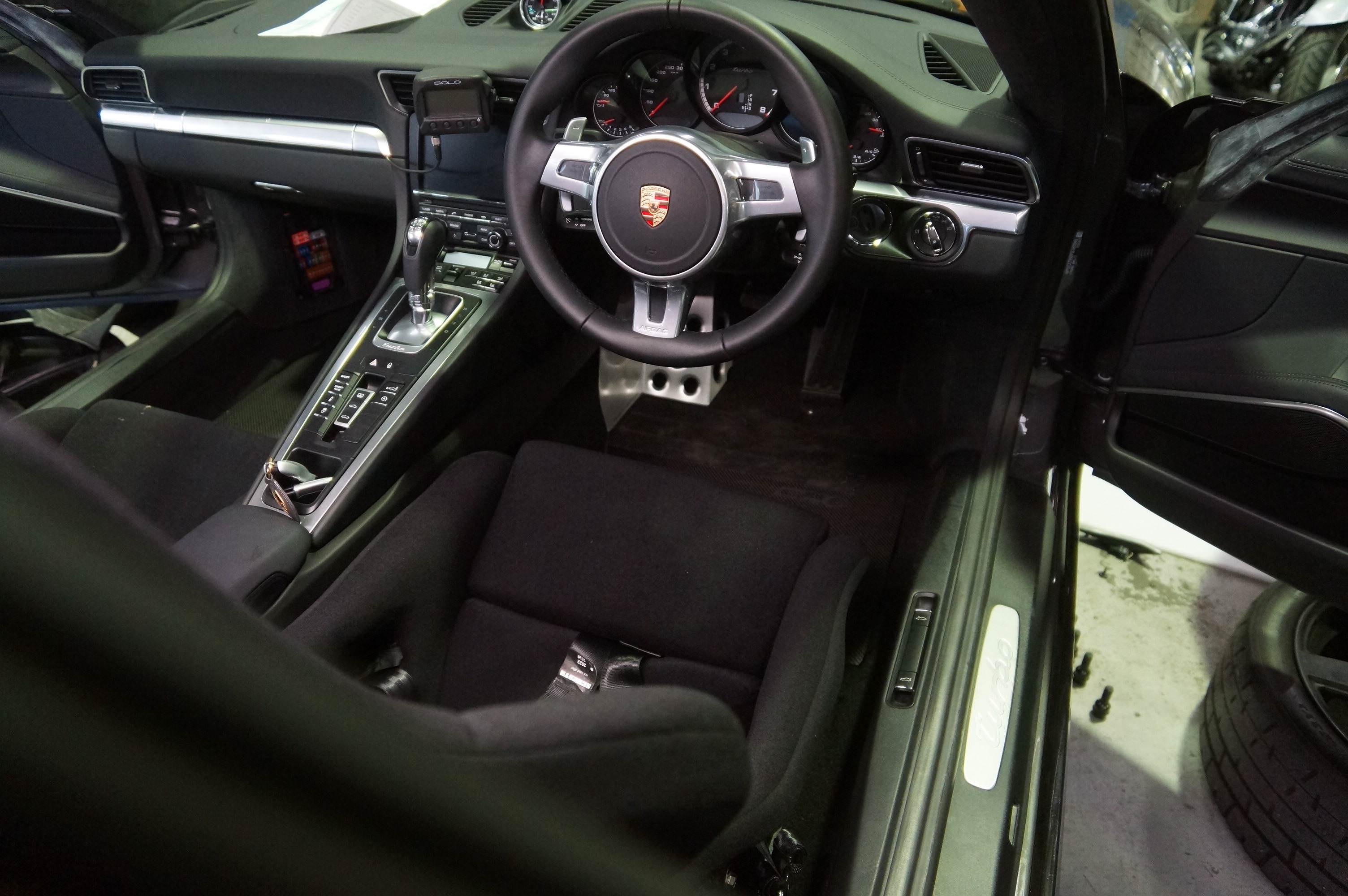

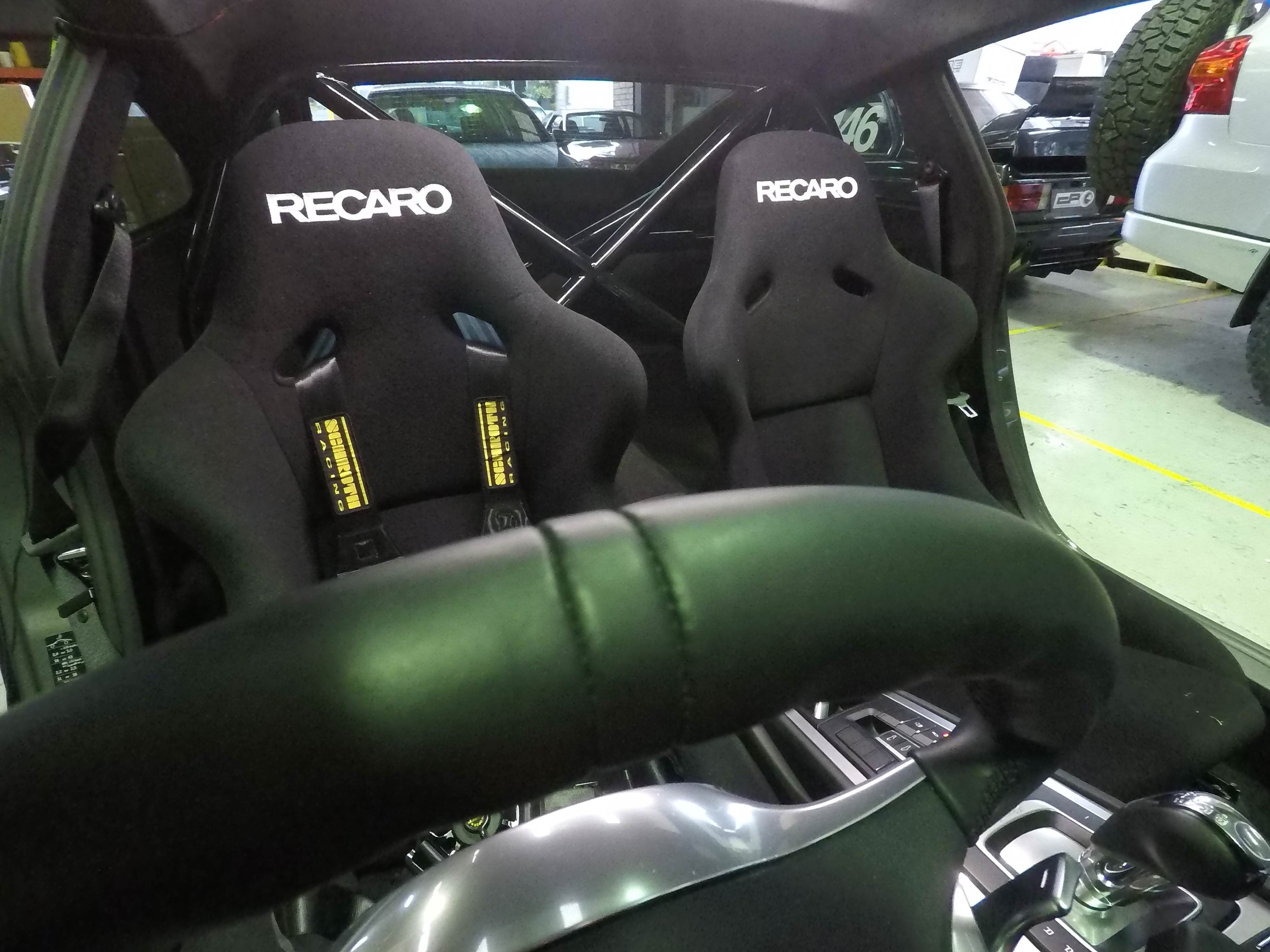

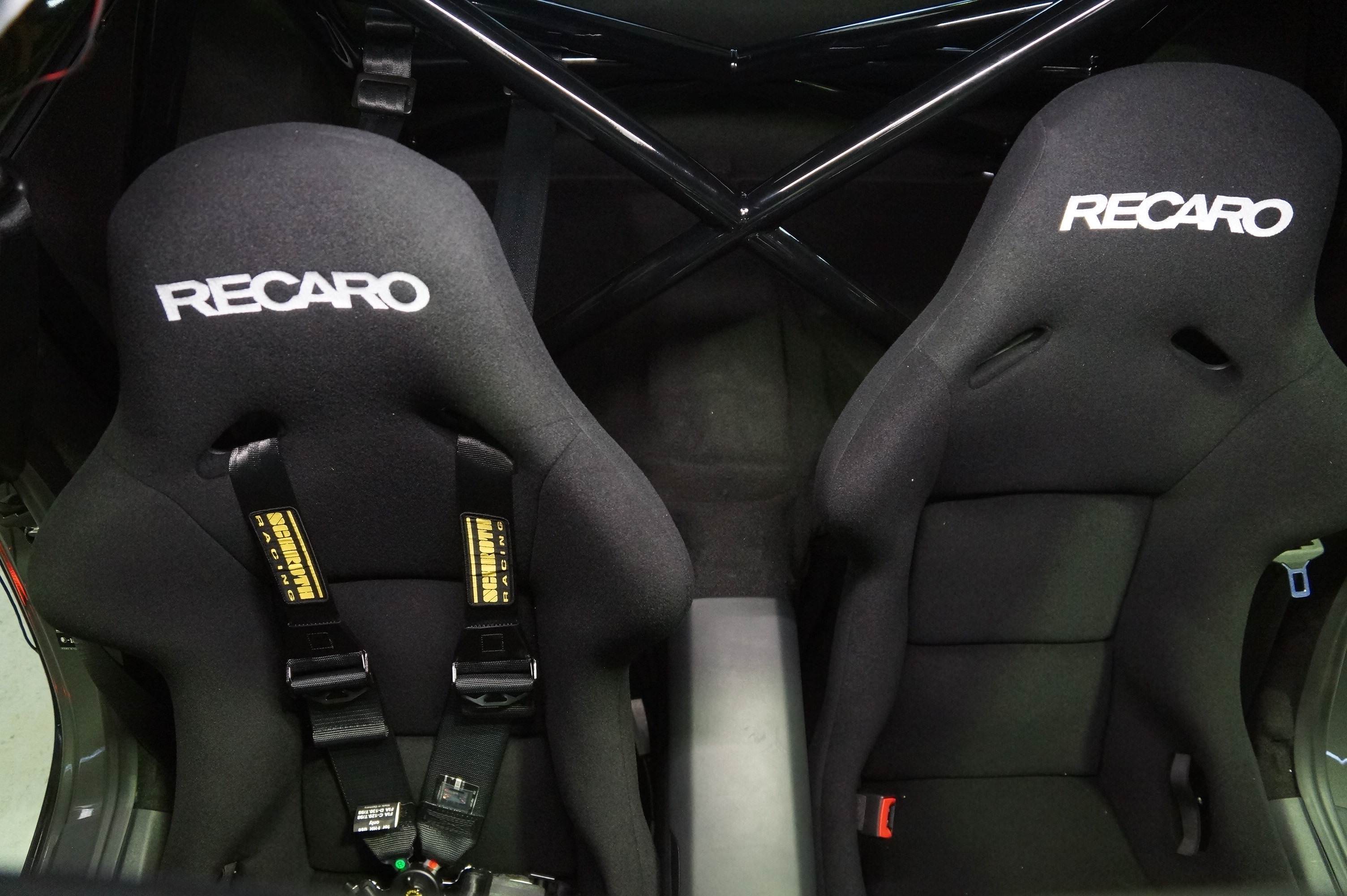

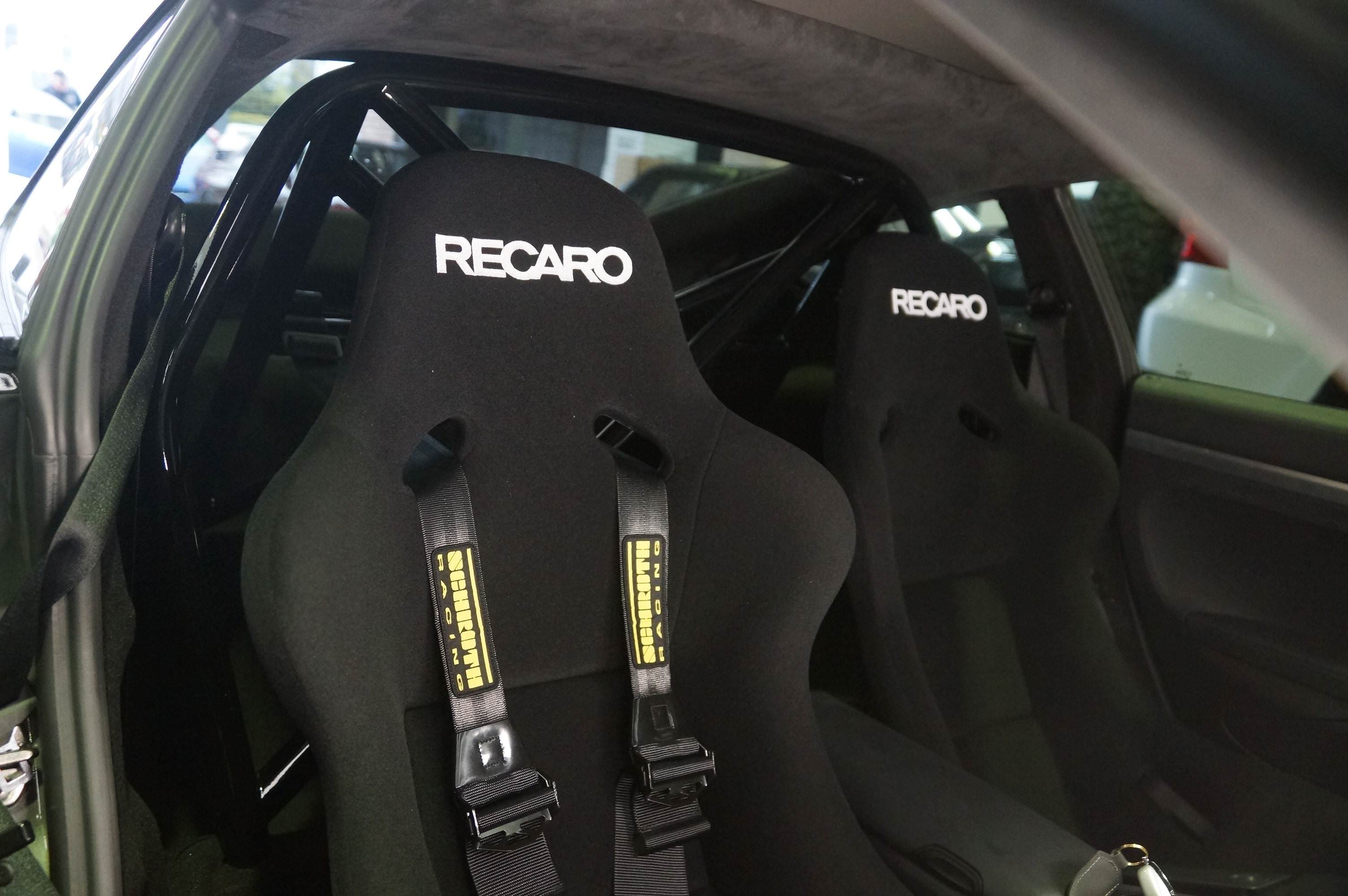

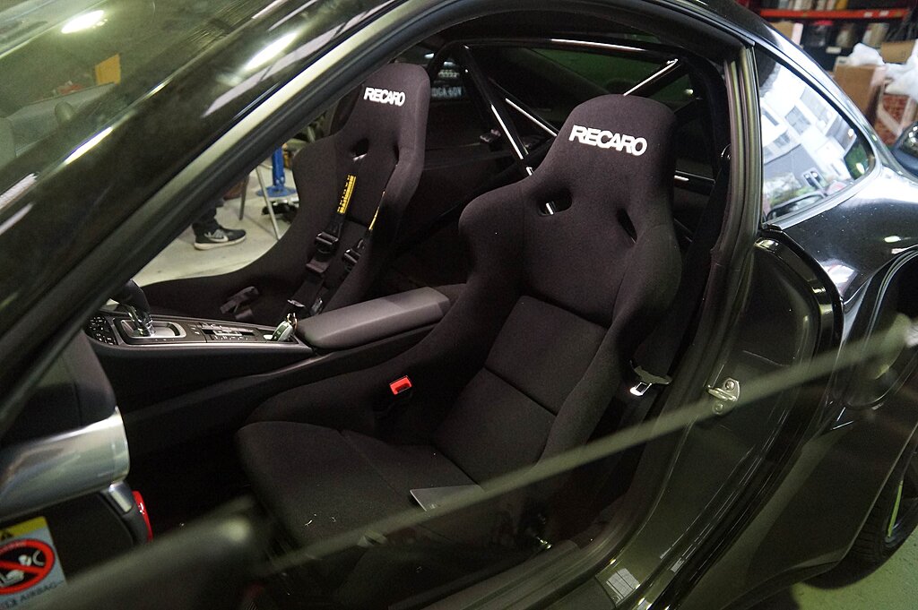

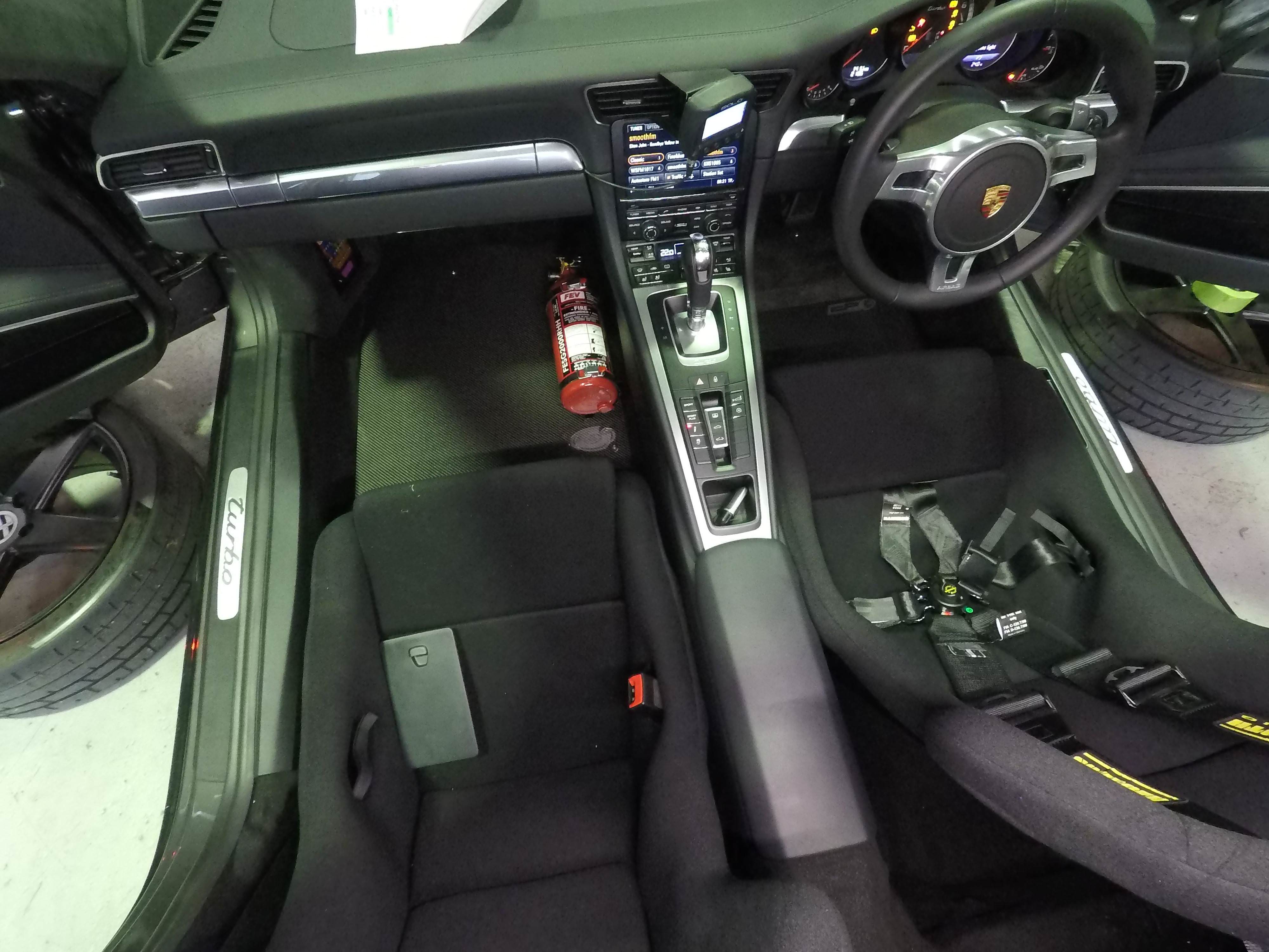

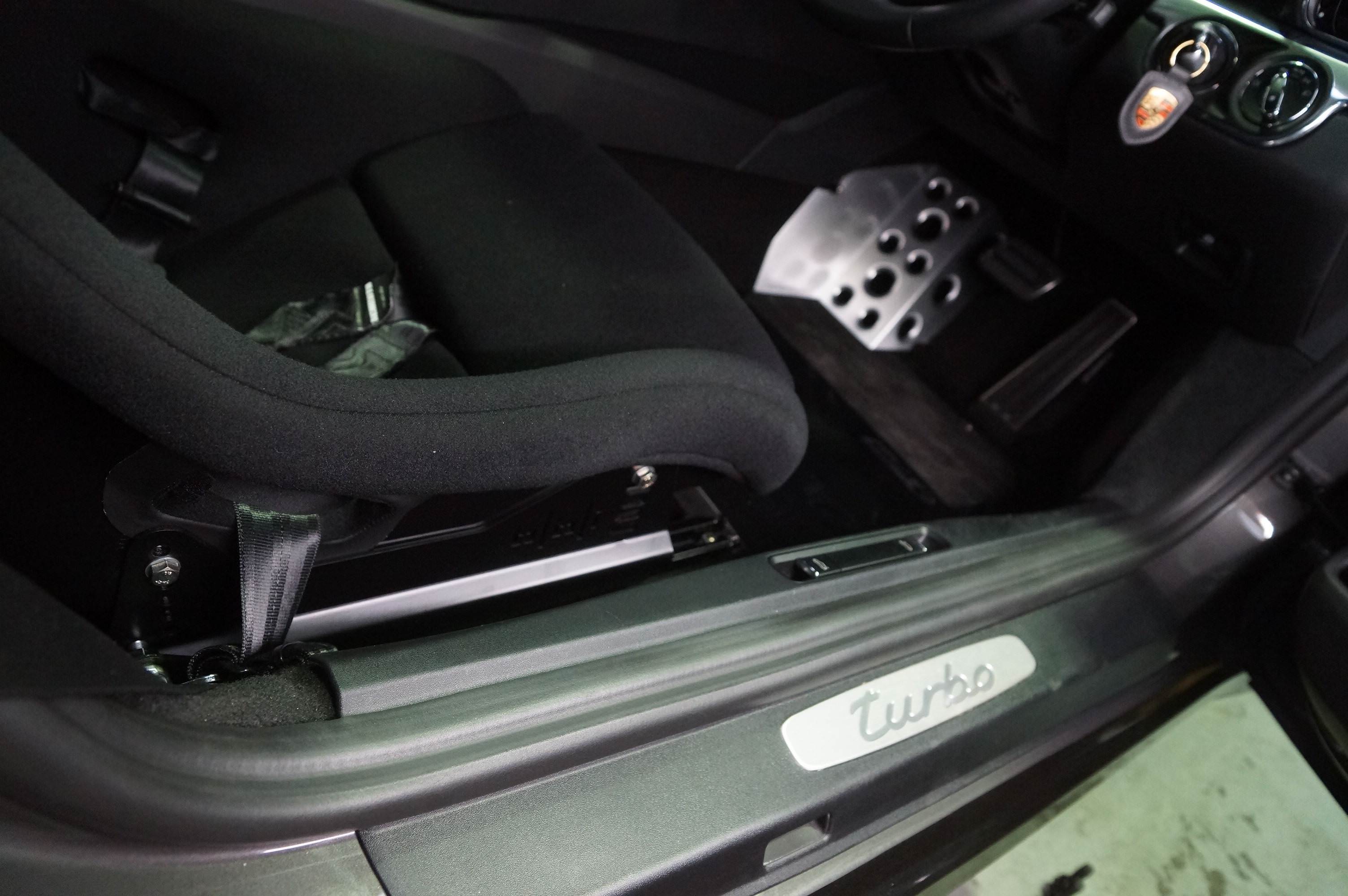

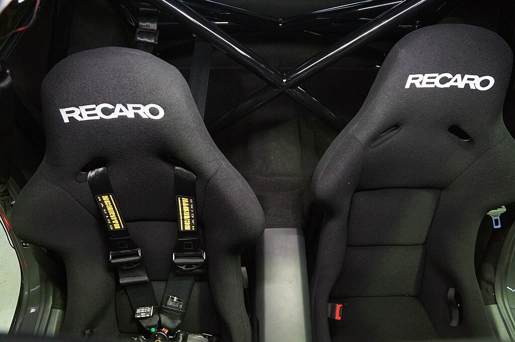

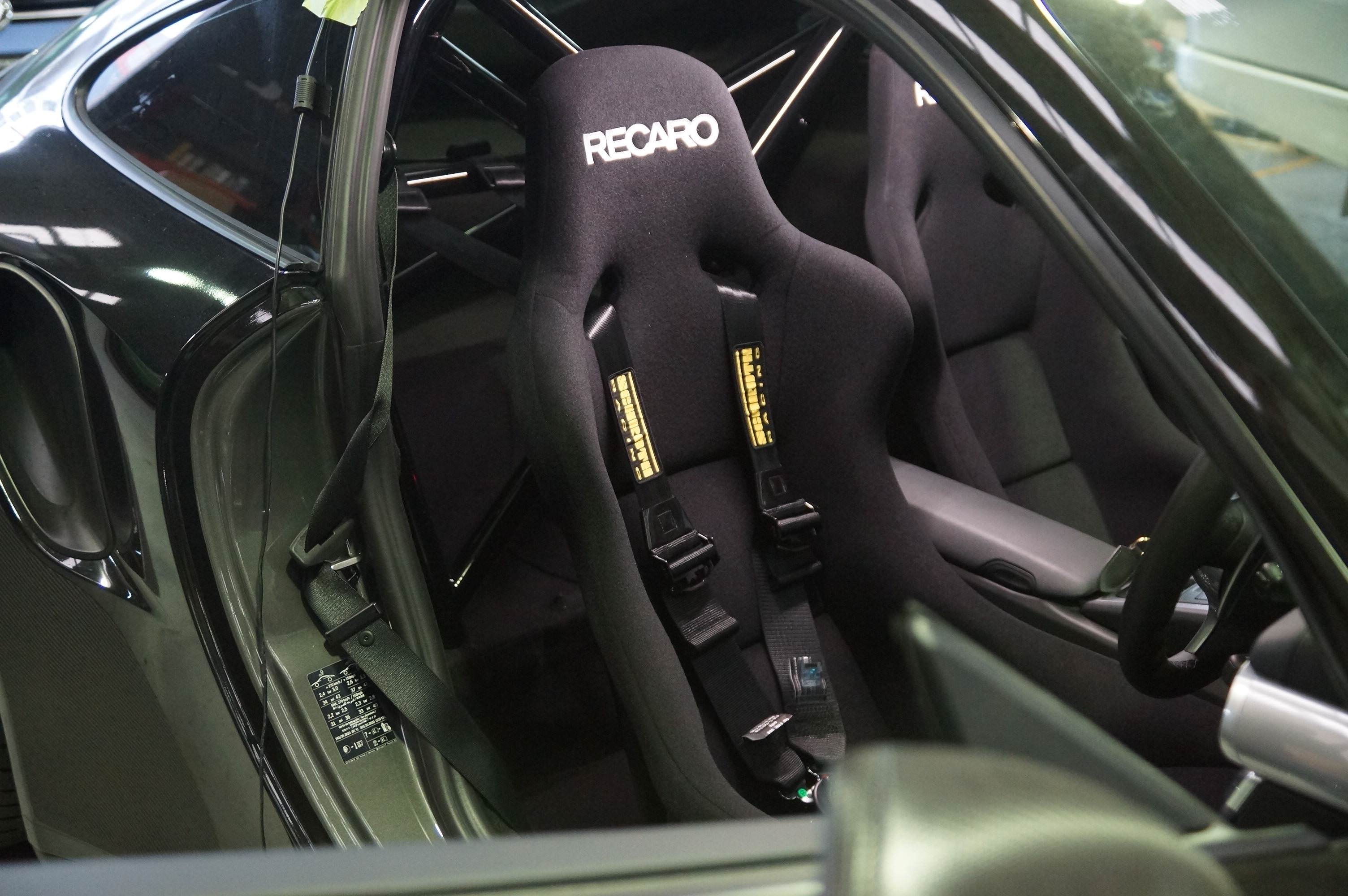

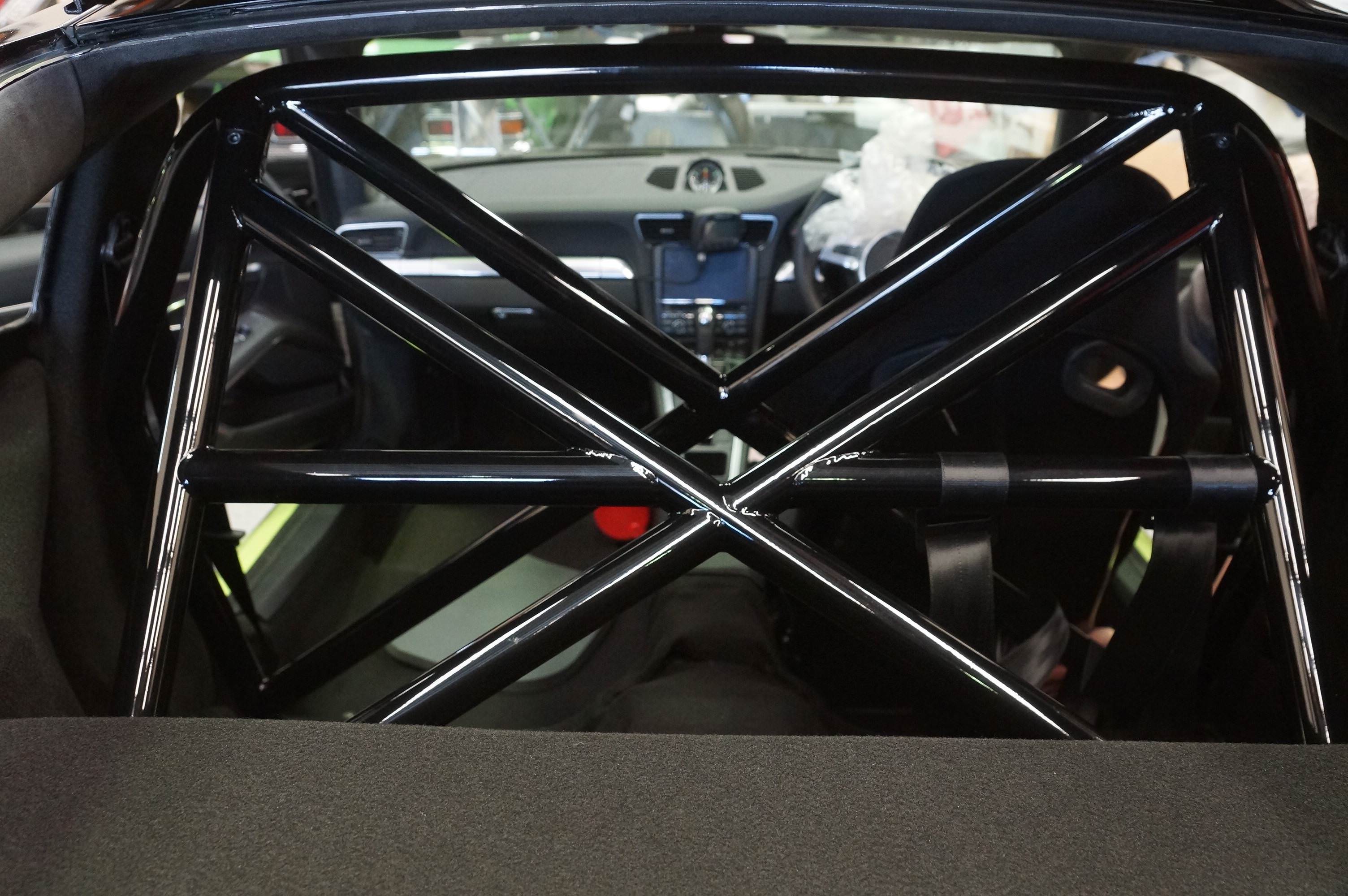

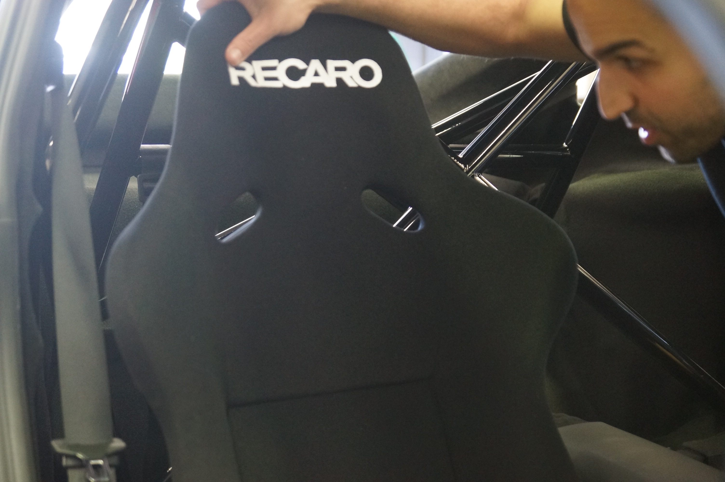

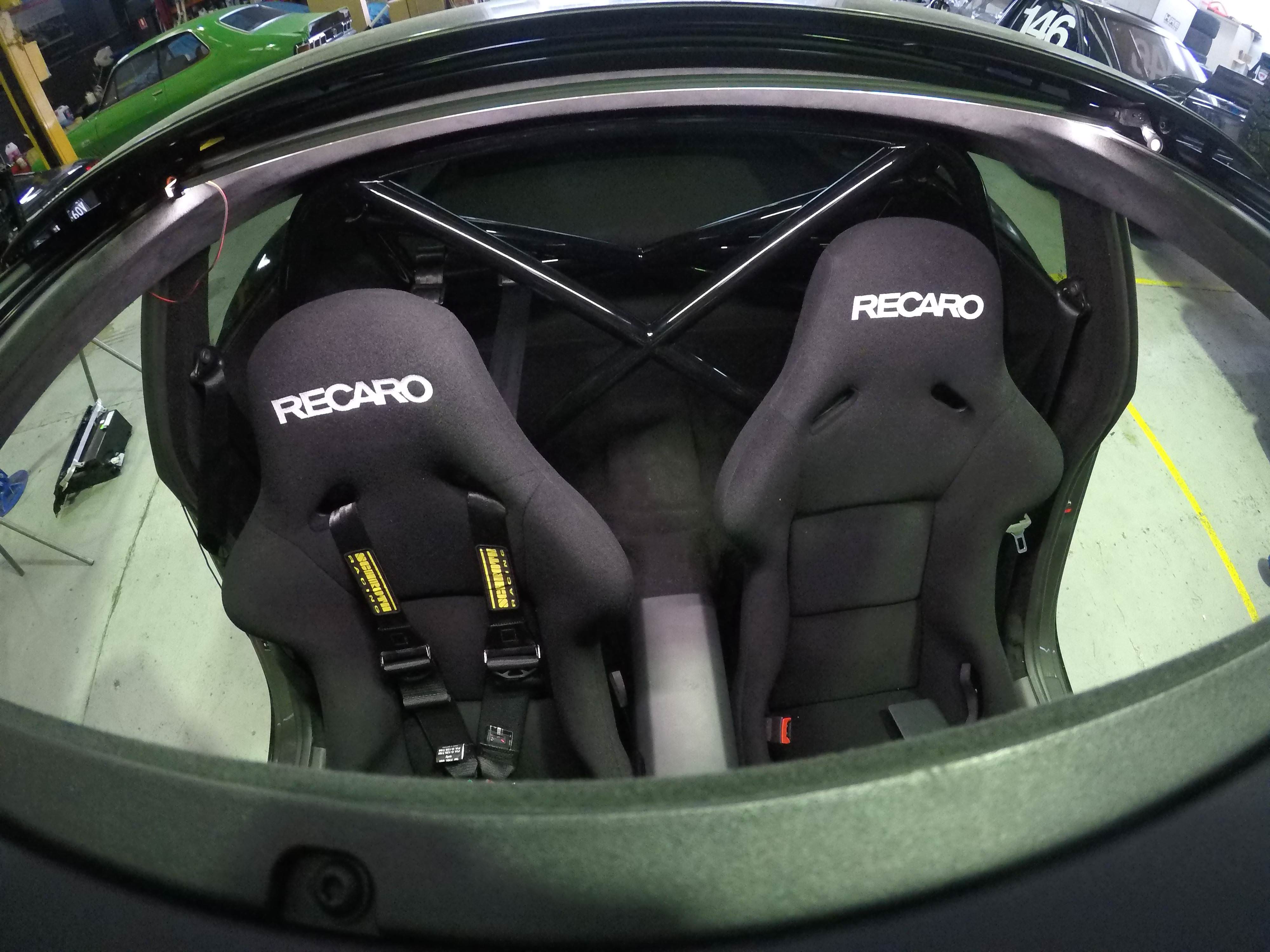

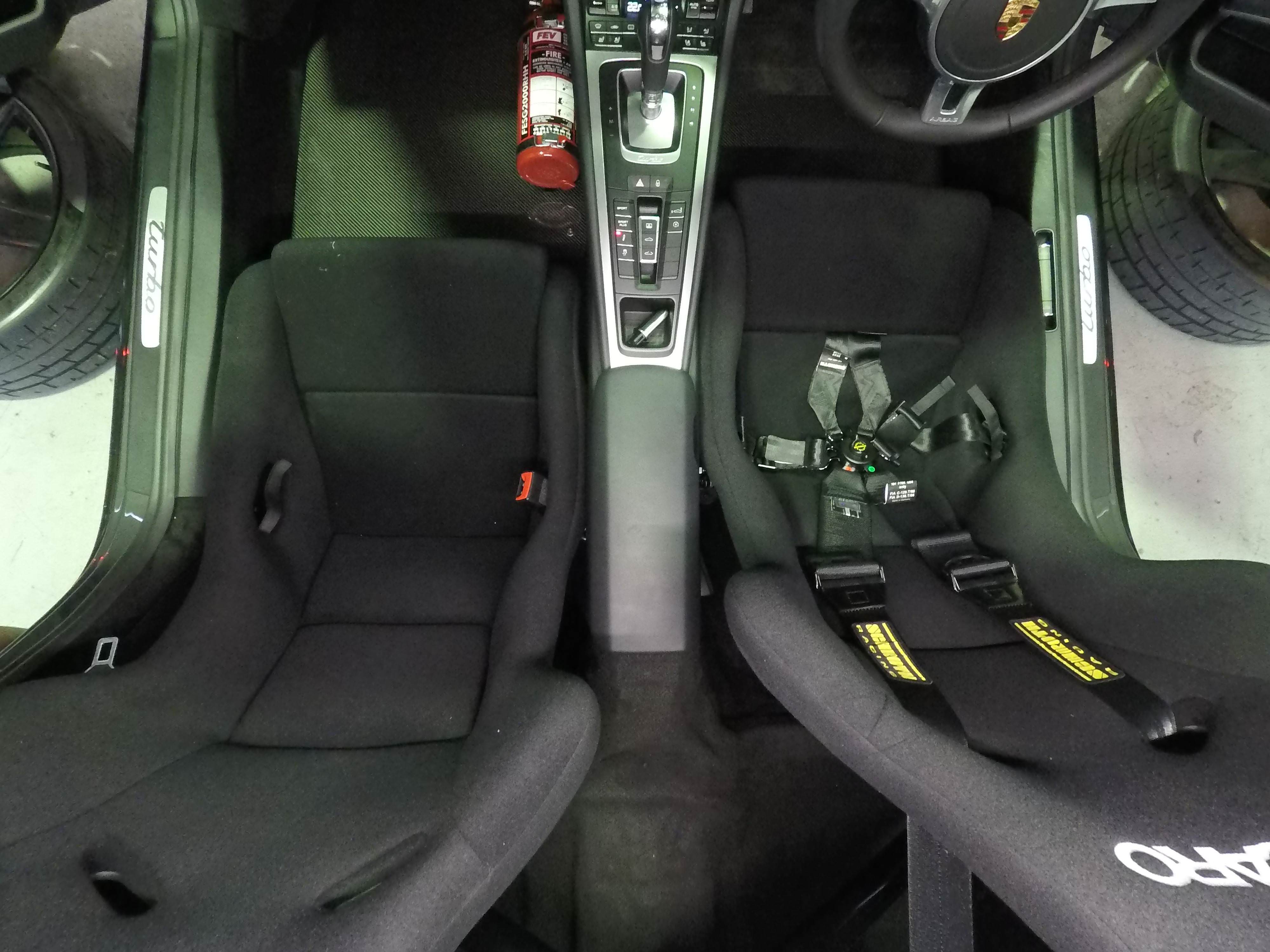

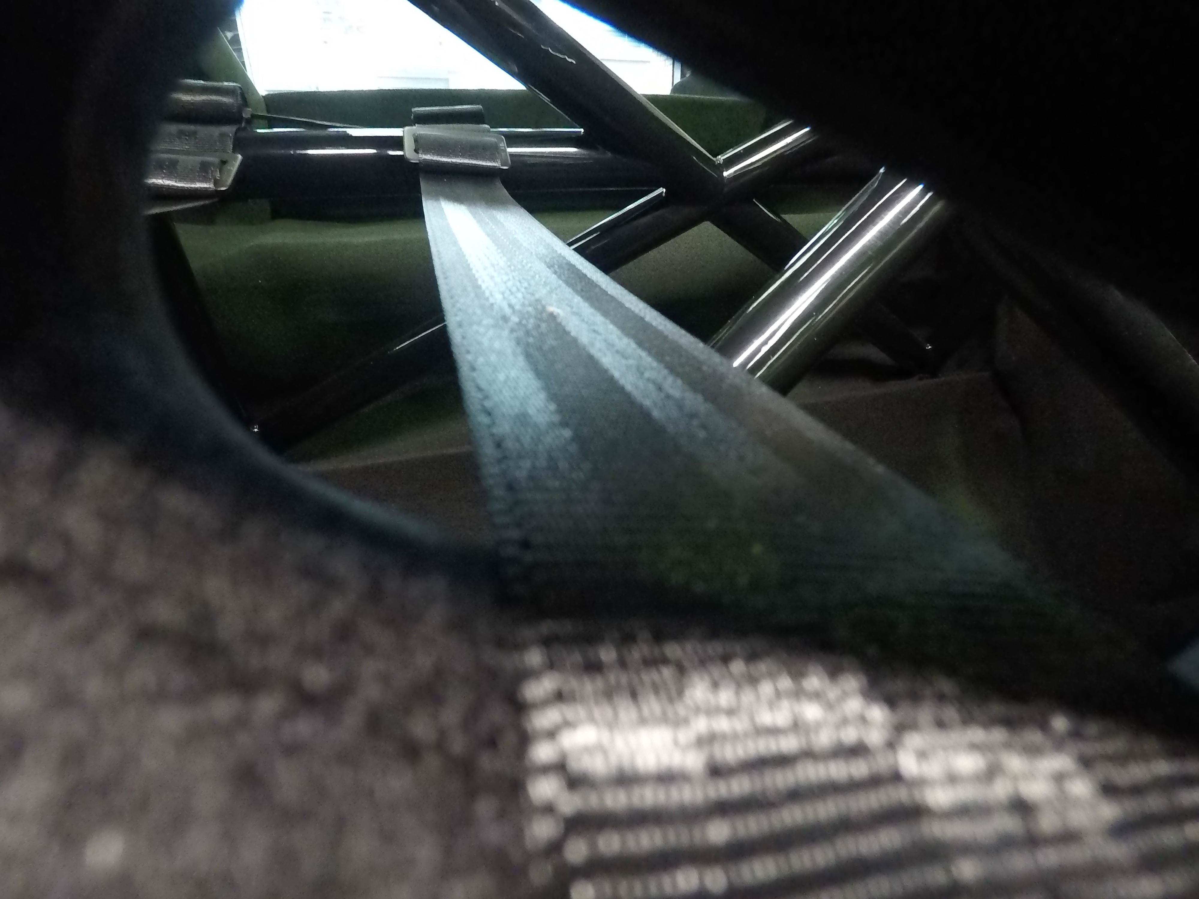

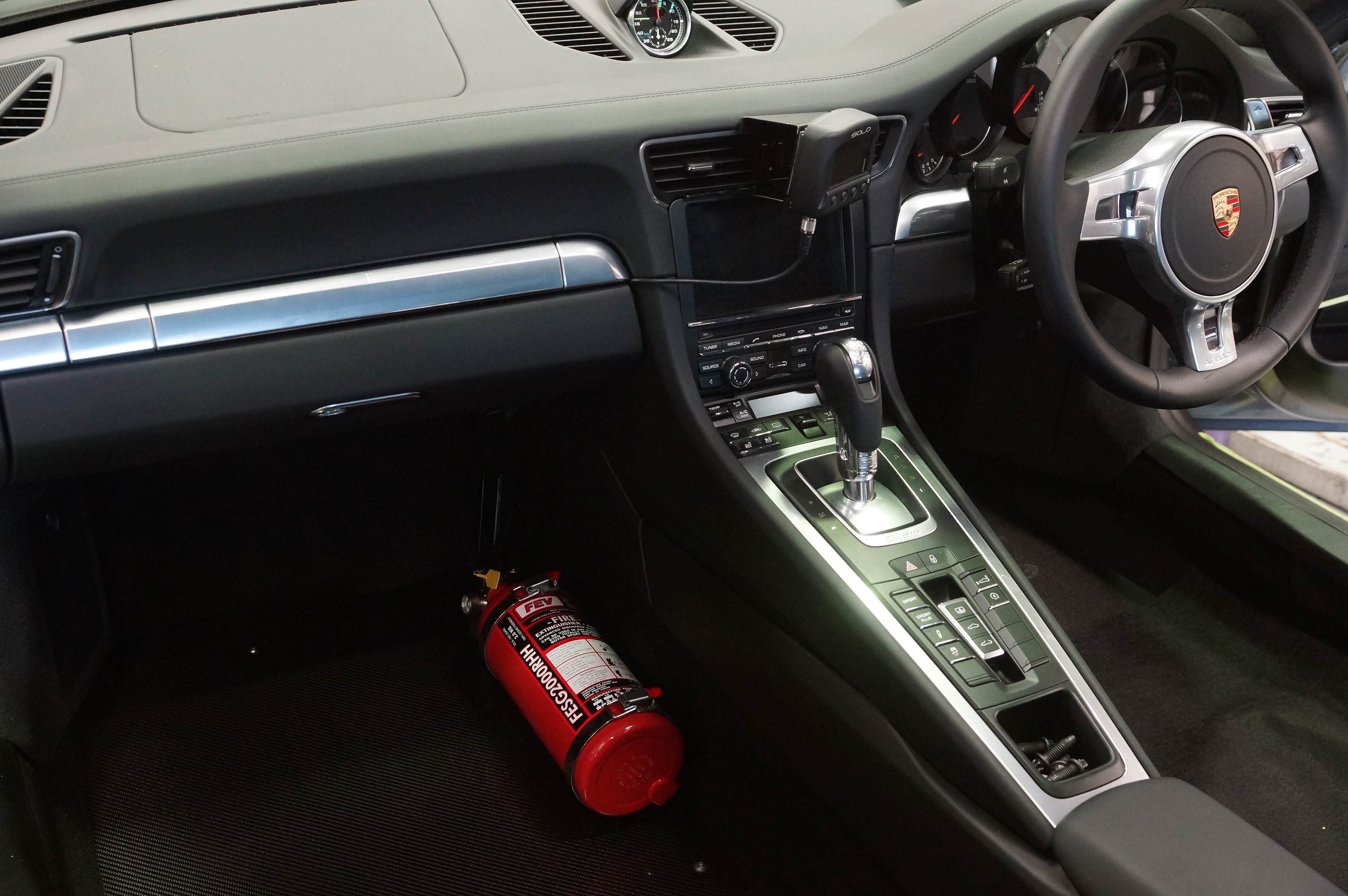

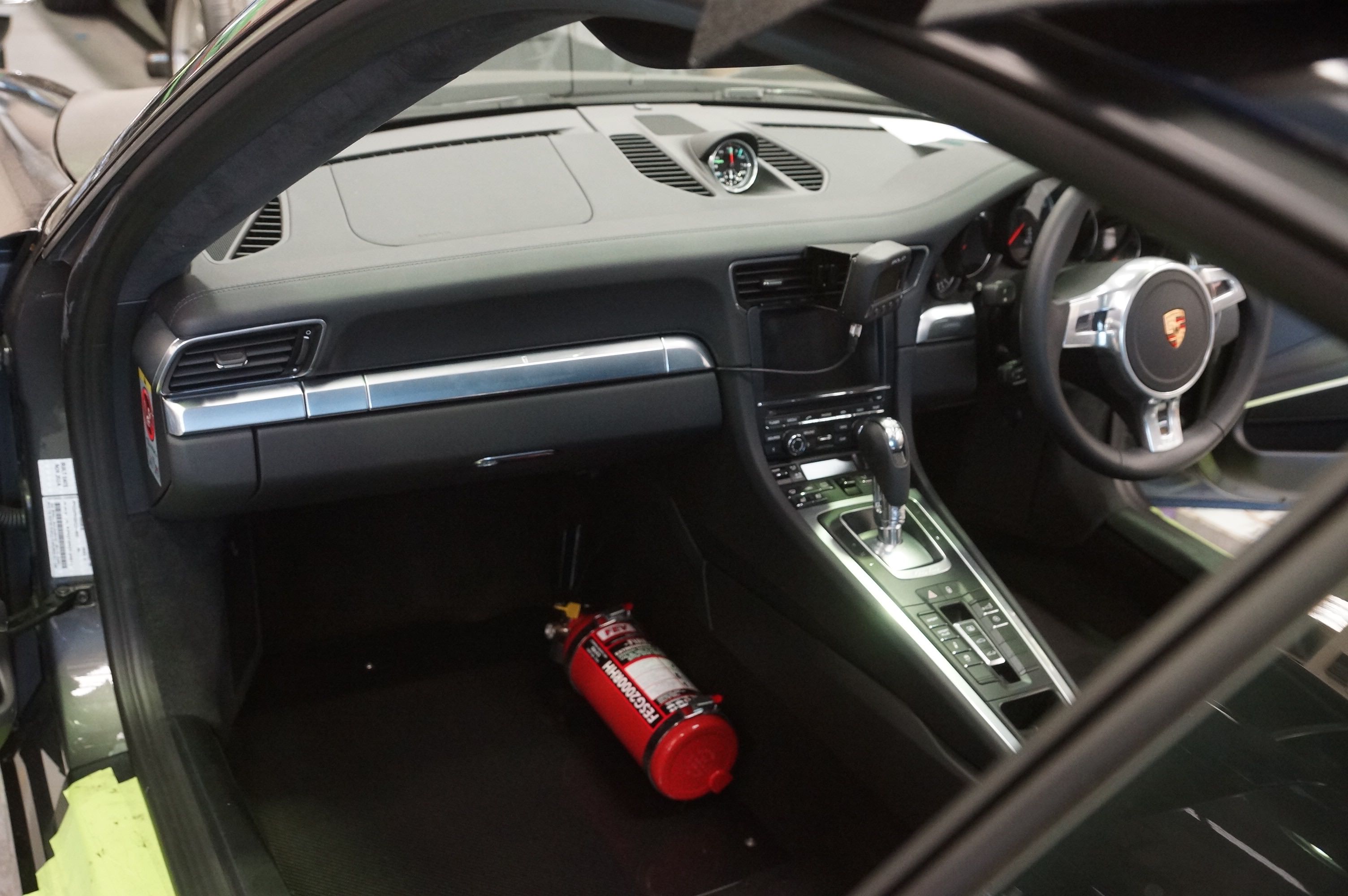

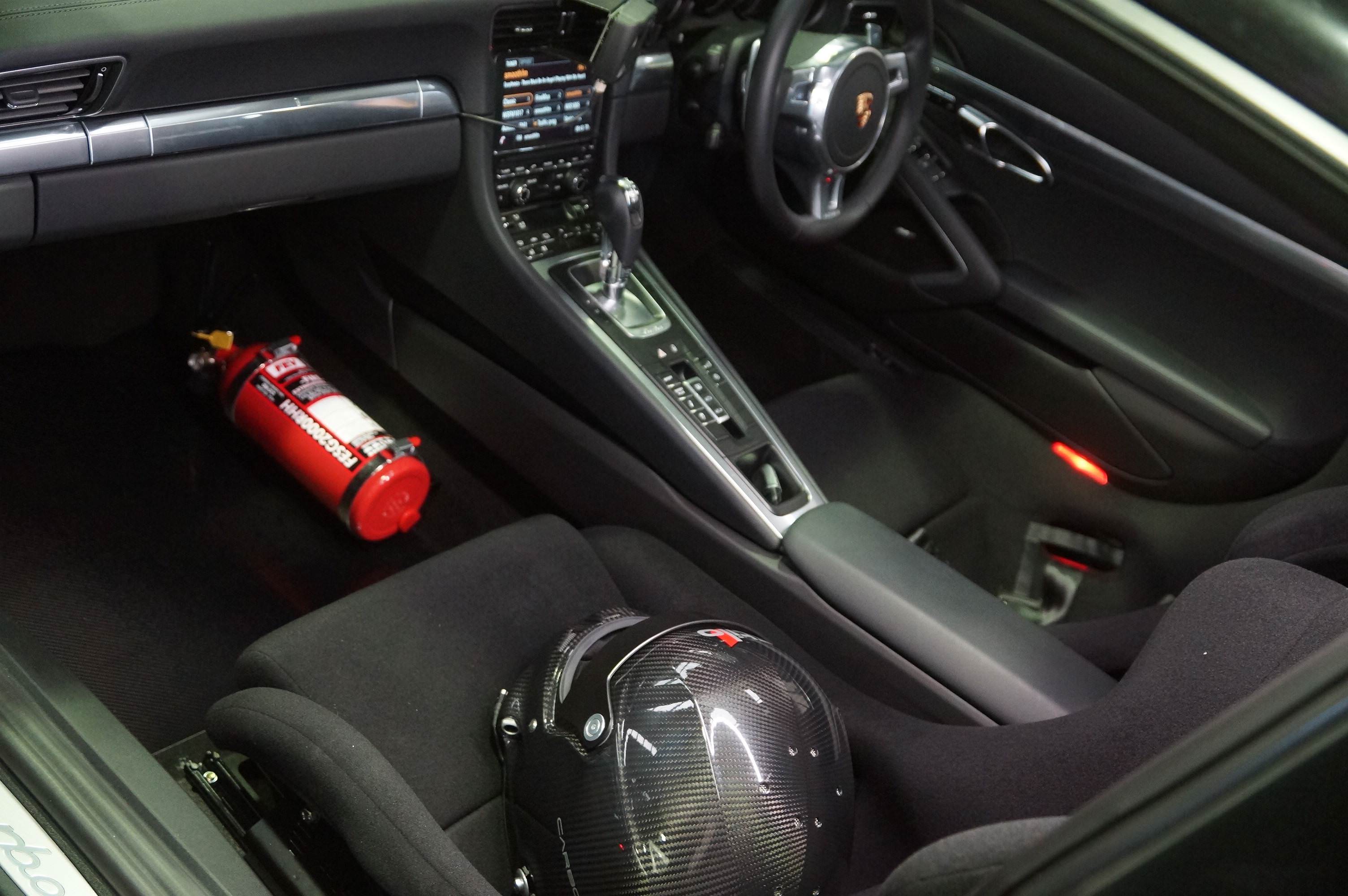

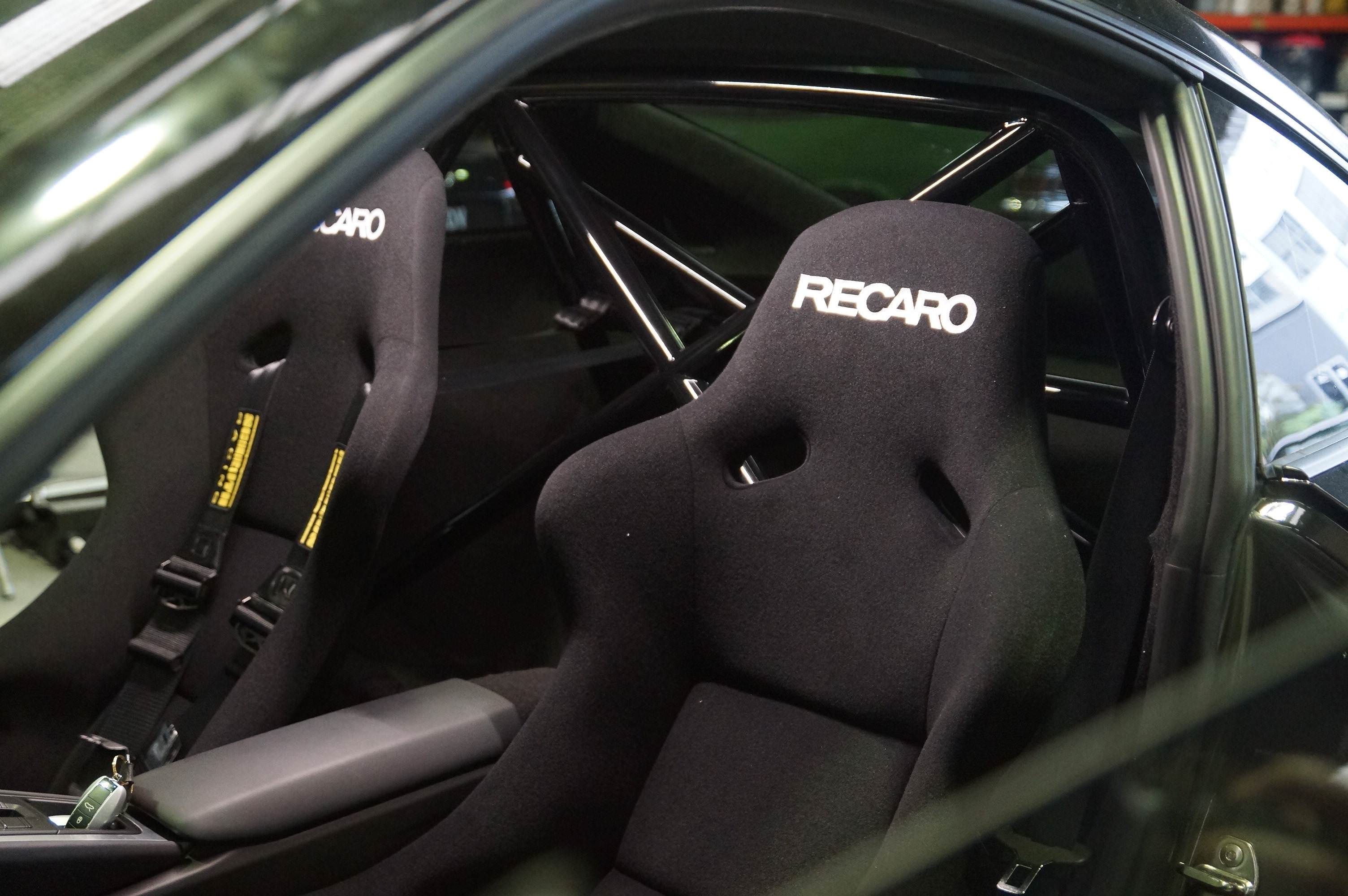

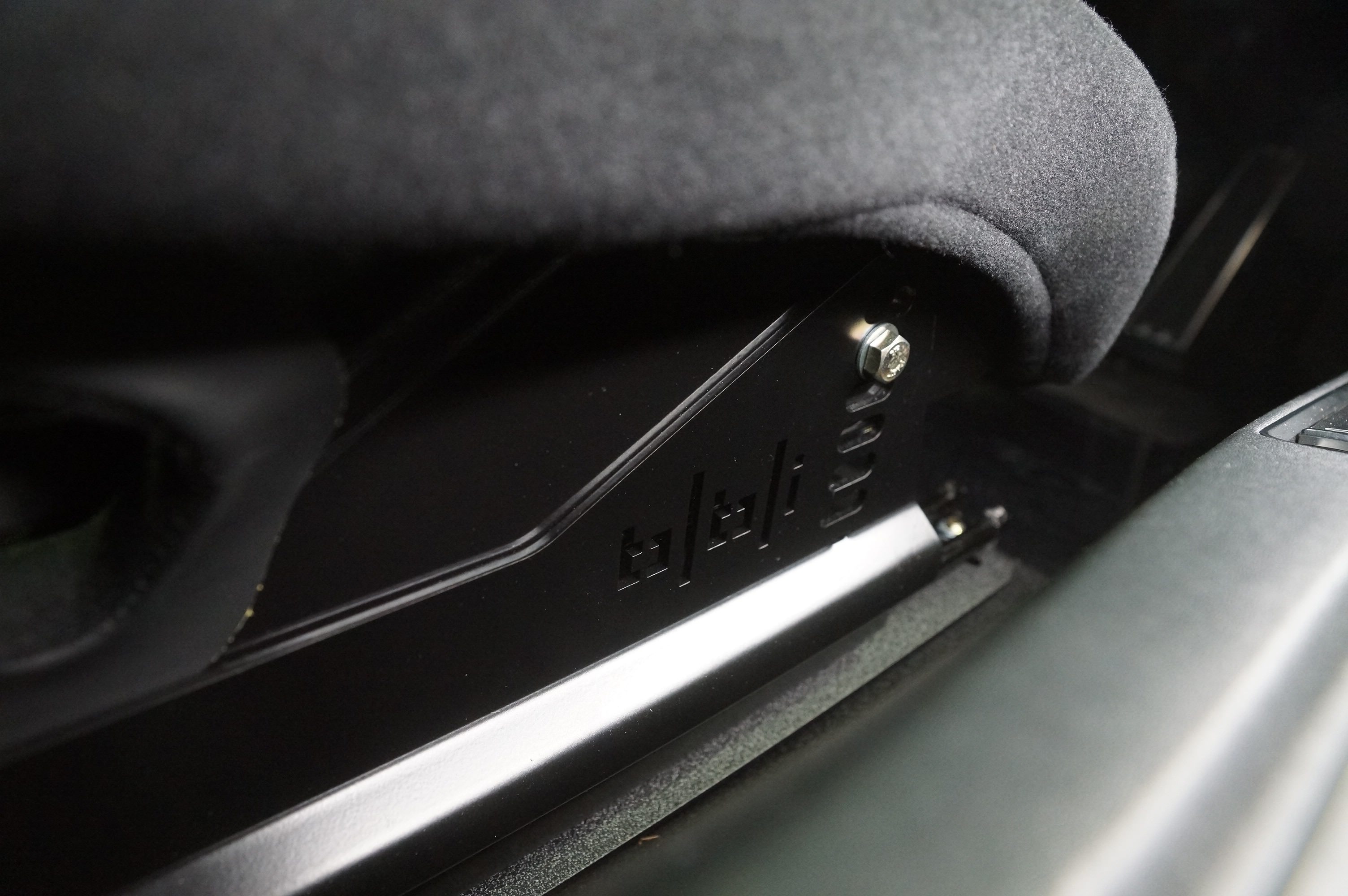

Another Porsche 991 Turbo getting the BBi treatment from down under over at City Performance Centre. It is getting our BBi Autosport StreetCup Roll Bar, RECARO Pole Positions mounted on our BBi Seat Base Kit, and a set of Schroth Racing harnesses. Located in New South Wales, Australia, we are proud to have City Performance Centre as one of our new international dealers representing our complete line of performance and safety upgrades. Here are some detailed pictures of the build process that we would like to share below.
Safety Upgrades
  • BBi Autosport 991 Turbo / Carrera Roll Bar
  • BBi Seat Base & Slider Kit
  • Recaro Pole Position Seats
  • Schroth 991 GT3 HANS Harnesses

BBi Autosport Porsche 991 Turbo & Carrera Bolt-In Roll Bar
Features
  • 1.625" x 0.095" 4130 chrome moly steel tubing utilized for excellent strength to weight ratio
  • TIG welded and utilizes "X" braces on front and rear sections for superior strength and rigidity
  • Mounts to frame structure (utilizing factory bolts) to provide strongest mounting points and maximum protection
  • Utilizes laser cut mounting plates & inner diameter tube clamps that are CNC turned and milled for a precise fit
  • Designed to work with stock seats or any aftermarket seats on the market
  • Allows full seat travel to accommodate taller drivers
  • Can be used with stock seatbelts or 6 point harnesses for track use
  • Designed to work with wrap-around style harnesses while optional eyelet bolt provisions are available for clip-in harnesses
  • OEM fit & finish. The main hoop contours entire arch of the roof with an even 3/16 inch gap
  • Finished in satin black powder coat. Other colors available Bolt-in installation requires no drilling and minimal carpet trimming
  • Made in USA

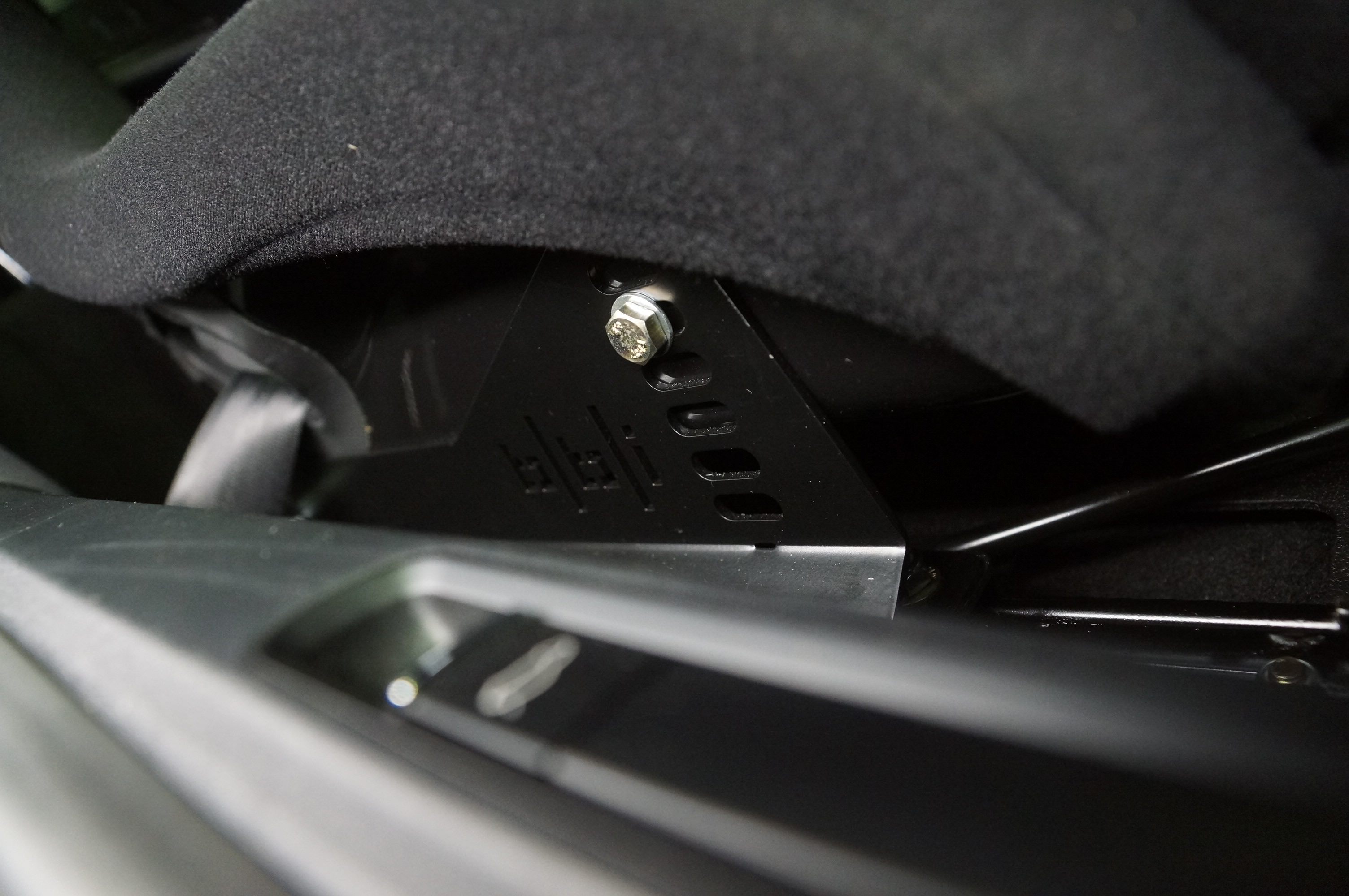

BBi Seat Base & Slider Kit Porsche 996/997/991/987/981 Seat
Features
  • Precision CNC laser cut and bent from one piece of 1/8” 3mm carbon steel (base & side mounts)
  • Multi way adjustability
  • High strength sliders, mounts to base with 4 bolts per slider
  • Integrated 5 and 6 point sub belt mounting locations
  • Stylish design with laser cut BBi logo and durable satin black Powdercoat finish
  • No modifications to vehicle or any seat mount components are required for installation
  • Uniquely designed for Porsche vehicles for the best possible fitment
  • Mounts to factory bolt locations with precise factory fitment
  • Fits all major FIA/SFI approved seats up to 17”
  • 14-3/4”¬(375mm) to 17-1/2”(445mm) width adjustments (standard side mounts)
  • 16”¬(375 mm) to 18-3/4”(445mm) width adjustments (optional wide side mounts)
