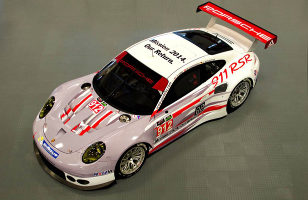

Don't miss Rolex 24 at Daytona this week end
Porsche has released the livery of the factory team cars:
Nick Tandy, Patrick Pilet and Richard Lietz in No. 911, Joerg Bergmeister, Patrick Long and Michael Christensen in No. 912. They are going to kick @ss.
If you check the lineup there are a LOT of 991's

zomg, I may have wet dreams tonight
