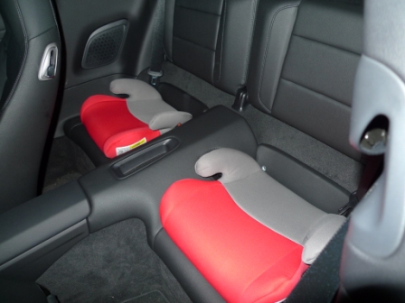

Recaro Vivo does not fit in the rear seat of the new 991. I bought a Harmony for $20 and it works great. Fits all the way back and belt is perfect positions on my 4yo. Ordered a Recaro Vivo because I thought it would be great to have the extra side protection. Will not slide all the way to the back of the seat. The seat narrows so much that the Vivo is off the back of the seat by 2-3 inches. The new 991 rear seats mau have LATCH but they seem to be more narrow than the 997.

I use the Harmony booster. It fits perfectly. Puts the seatbelt on my 4yo in the perfect spot.
Britax Marathon does fit for forward facing. The seat back keeps it out a little far but it is stable. Would be great if you could figure out how to remove the rear seat back. This would allow the seat to move farther back. It does make the front passenger seat completely unusable.

I also tried out the Harmony booster. Although it fits perfectly, I found two issues with it:
1. The handles on the side cover the seat-belt latch.
2. The harmony rises quite a bit, which is normally great, but in this case my kids heads were over the seats back.
After trying multiple others, I like the Cosco No Back Booster (http://www.target.com/p/Cosco-No-Bac..._qi_detaillink) from Target the most.
