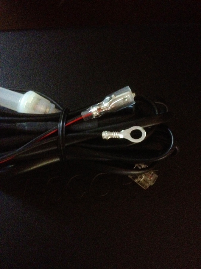

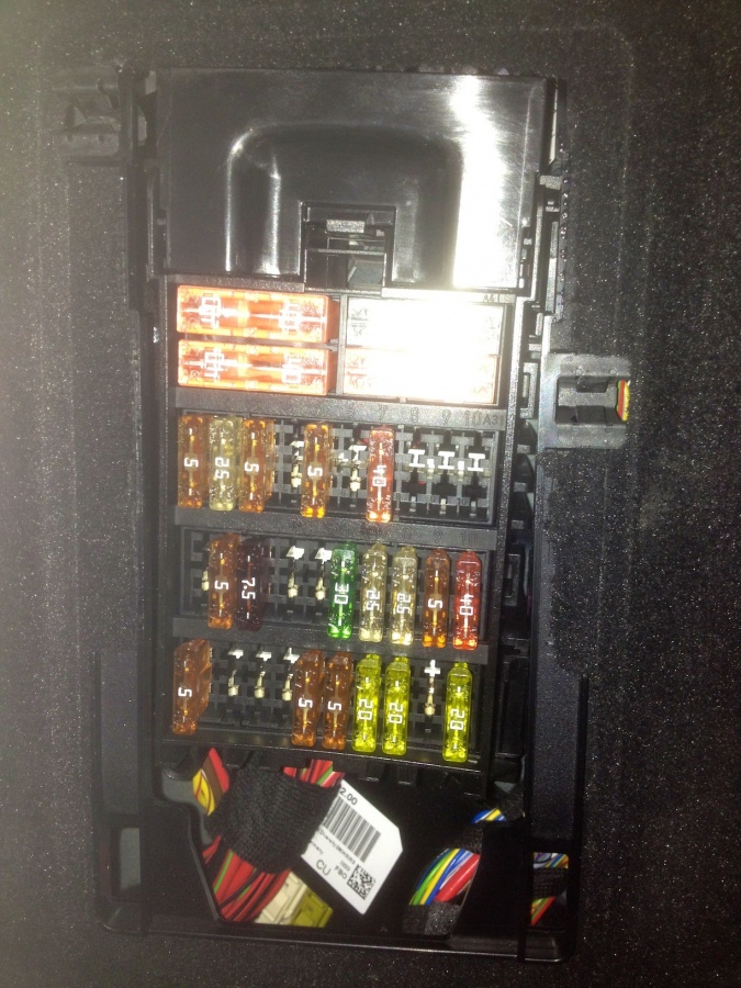

How to Hardwire Radar in 991
Please help, I have a 9500ix and would like to hardwire it. Attached are pics of the passenger side fusebox, and the optional hardwire kit I purchased from Escort. What do I plug in and where? My original intention was to have the dealer do it, but I was quoted $355. Another member Omaha991 suggested I do it myself as it takes "20 minutes"! I don't know where to start. Any help would be appreciated and no detail would be too minor (trust me). Thanks in advance.

991 50th Anniversary - Switched Escort 9500ix Hardwire EASY INTALL
Could not have been easier. Note - I used passenger side fuse box "D2" slot for "switched" - You may not be able to use D2 if you have a 4S.
Ran the 9500ix "Smart Wire" from passenger side of rear view mirror to passenger footwell fuse box.
Tucked wire under headliner (w/fingers) and then used a stiff rubber kitchen spatula to tuck wire behind/under weather stripping down to fuse box.
Used "gaps" where interior trim pieces met to make horizontal turns (top of A pillar & right of fusebox). Pop off carpet surrounding passenger fuse box to fish wire to fuse box.
Use the "Fuse Tap" to join Smart Wire. Cut off male end on Smart Wire and crimp into Fuse Tap. Cut off small round ground end on Smart Wire and crimp in a large enough end to fit over Ground Post that's on left side, middle, of fuse box.
Add 10amp fuse to top slot on Fuse Tap.
I used the D2 (all-wheel control) slot to run my 9500ix in a Switched Mode.
Since the 50th Ann. car is 2S in a 4S body the D2 slot is un-used.
