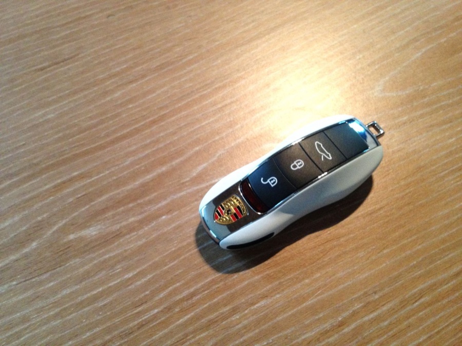

Hi, I always wanted to paint my car key in white to match with my new 991S (factory optioned is way too expensive). However, I tried to search from the internet forum but I could not find the info anywhere how to disassemble Porsche key case.
However, a few days ago, I accidentally washed my car key (it was sit in my pant's pocket). The key was not able to operate... then I opened a battery cover... sad news, the battery was leaked with brownish liquid. I decided to repair it, and I will need to disassemble the key case without knowing of how to do it properly (anyway, it is already broken).
Luckily, I did it a pretty good job to disassemble the key case then using the hair dryer with brush to dry and remove all messes from the electronic parts/chips.
Thankfully, my Porsche key is alive and working again.. save me a lot of trouble (Porsche's quality is water proofed).
Since i was able to disassemble the key case with else so i decided to paint it with matt white spray then re-coat with matt clear lacquer. The result is fantastic and I really excite to show it to your guys, enjoys. I will write DIY soon.

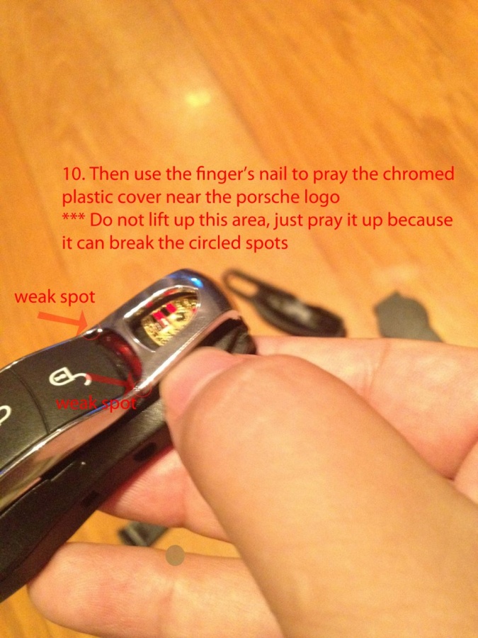

Diy
Here is DIY. It is very simple. Cheer! You only need to do step no. 1-6 in order to remove the side covers, to paint.
My matt white paint has
1 x times primer coat
4 x times matt white base coat
4 x times matt clear coat
The paint has a very strong scratch resistance. I drop it to the floor and no sign of any scratches, I am a very happy Porsche owner.

The extra steps is what i did to repair my key.
