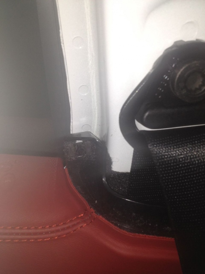

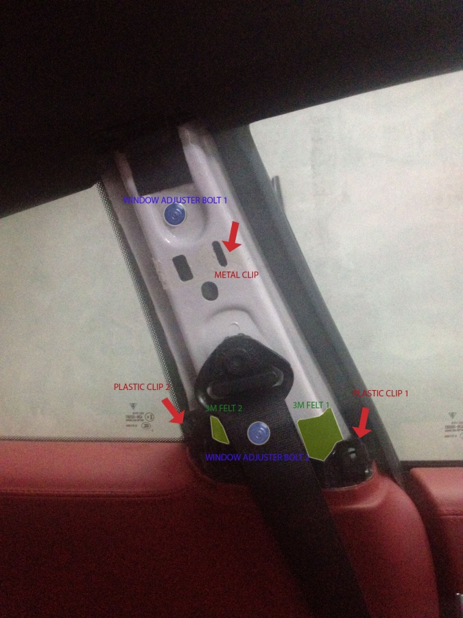

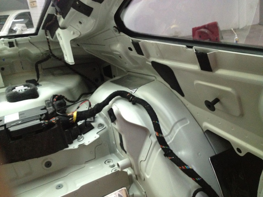

Hi,
I did fix it on my car, please see the pictures. I do not know if it will work for your problem or not but it does work for me.
1) Remove the seat belt retractor's cover (it is a rectangular black plastic cover), simply ply it out.. very easy by hand.
2) Remove the B pillar cover, just simply pull it out starting from the right&left bottoms (2 plastic clips) then pull out the upper part (1 metal clip).
3) Then I put 3M felt on the side panel as shown in the pictures to prevent it from flexing and hitting the car's body. You can see what else that might need to do to prevent the rattles.
PS. It always good to check the window's adjuster bolt to make sure that it does not lose, my ex-cayman usually have the creaking noise from the loosen window's adjuster bolt.
I have removed it several times, should be no problem for your guy to DIY at home. I also covered the seat belt retractor's cheap plastic cover with Alcantara so it will match with B pillar cover.
Cheer!

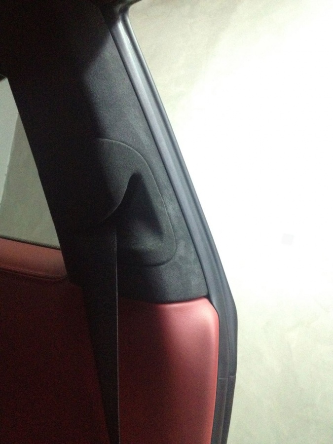

Here is my alcantara seat belt retractor's cover.
