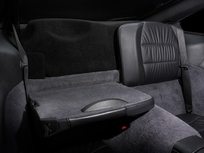

hello
it 's a french "PORCHISTE"
for your information
http://intl.jlaudio.com/car-audio-st...ox-porsche-911
2000 euros
it s possible for 991 ?
and simply operation
http://www.focal.com/en/plug-play/25...059750129.html
small contribution for you
thanks
bye
