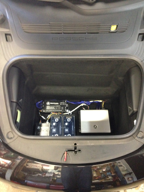

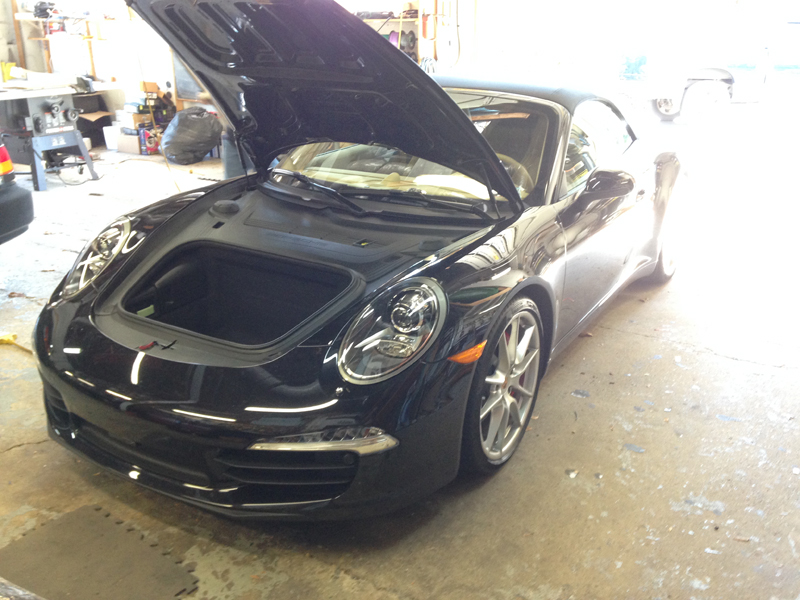

Apologies for lifting an old thread back from the dead, but I recently did a full system in a 991 if you're still interested OP.
Used a JL Clean Sweep to re-equalize the factory radio, paired with a JL Audio digital amp and German Maestro speakers all around. Mounted all of the components underneath a false floor so the owner could still utilize the trunk space. Check it out:
If you don't like the factory radio, I also did one of the first 9X1 headunit swaps, with this Cayman S preferring Alpine over factory.
So yes, these cars CAN have aftermarket sound integrated w PCM or with a replacement radio

Nice to see another aftermarket system. I just did mine recently but haven't had a chance to create a post. I'll do that soon.
I have the factory PCM (everything works), Audison LRX 6.9 amp, Arc Audio 125.5 mini amp for sub, Audio Control DQ-61 for summing the factory amp (Audison Bit One didn't work) Focal Utopia Be 5" sub in factory location, 165 krx3 front, 100 krs rears. The system is super sweet! Some of the crappy Sirux/XM songs sounds really good too, I was surprised. The HD radio and my lossless recording on an ipod are nothing less than spectacular.
