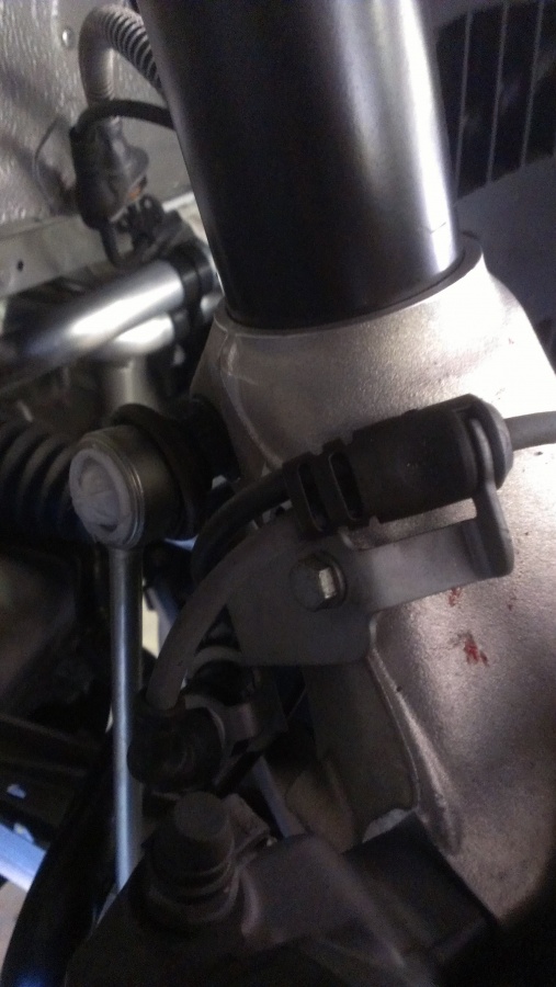

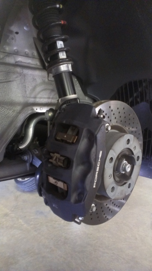

I had the front pads replaced today with the low dust Centric pads (couldn't do the back ones as they were the wrong size). They get replaced by removing the two bolts that hold the caliper to the strut and a small bolt which holds the connection of the flex tube and stiff tube to the strut (see picture). There appear to be two locating bolts with odd heads that go through the pads (the silver looking ones in the first picture), but they do not get removed. Once the caliper is removed, it is simple to remove the pads. The bolts that hold the caliper were torqued at 42 ft. lbs.
The 25 mile ride home was uneventful. I only noticed a very slight reduction in initial grab during braking (it might even be better as I personally think the OEM pads bite too much on initial application). The other characteristic I found is that there is a noticeable reduction in drag during coast-down. This means the gas mileage might even be better!
ChuckJ
