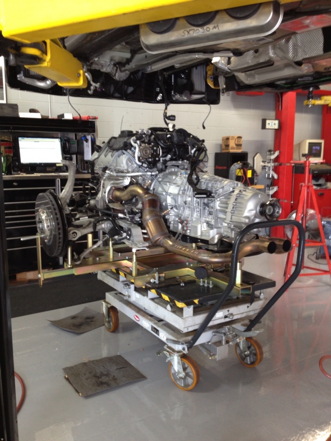

Finally picked up my car todayand received a detailed explaination. There was a defective oil pressure regulating valve. Oil was found wicking on the engine wiring harness. They replaced the harness, the "DME" ( anyone know what this is?), the generator, oil level sending unit, oil pressure sending unit, the valve itself, anda coolant pipe. They had to drop the engine and transmission and run the engine totall detached to discover where the leak was. They had to do a complete rewire to all sensors and replace a number of those as well. They had to clean the engine and compartment
The service manager was saying that this is very rare. They have never seen it happen in another 911. Oh well, I am the winner.

I'm glad the car is back in your hands. Your car is stunning and all is fixed. Just shed a tear for the fellow whose 2012 Panamera Turbo was in for a recall to replace both turbos! They had to drop the entire engine out and it'll take 2 weeks before he'll get the car back.... Eeek! It was at the shop on Monday when my car had an oil change.
