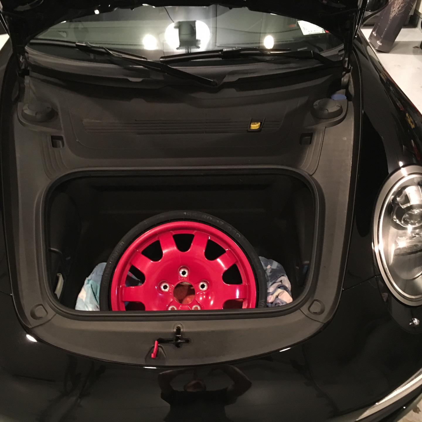

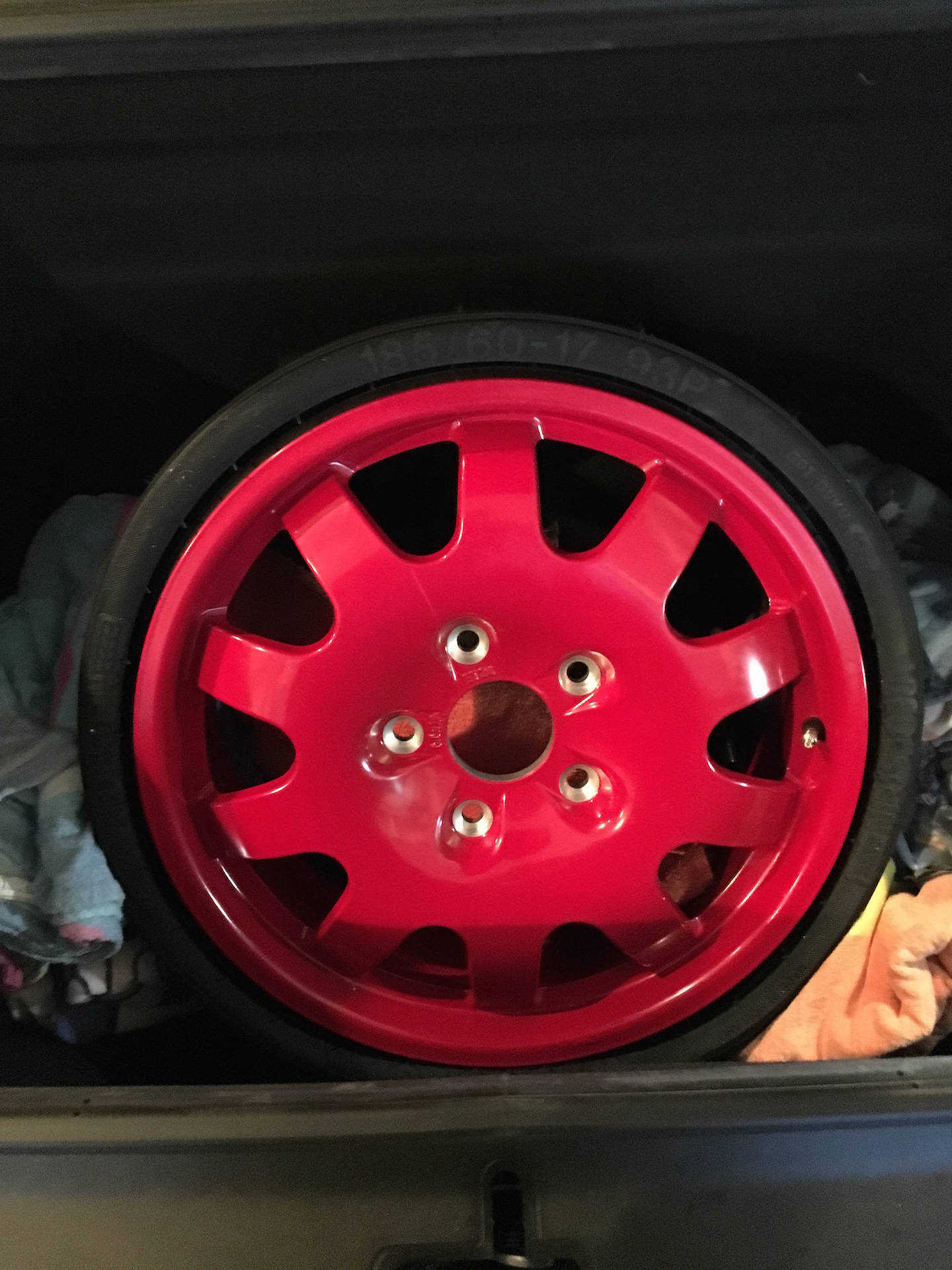

I bought it from another 991 over who bought and sold his car very quickly ... I forgot where I think it was on eBay and cost me quite a bit of $$ but I wanted the peace of mind of having a spare. Also I remember trying it out on my front wheel when I first got it and it fit on my car and it cleared the brakes. I will try it again when I swap out my summer wheels for the winters.
Here are some pictures of it in the frunk with a close up of the part number.
I didn't use the part that is supposed to fit in the frunk to hold it because it takes too much room, I just put some old towels around it and jammed it in so it doesn't move.
If you need any other info let me know ...
EDIT: Woo ... I just googled the part number and it is for a 996 Turbo ... I better check to see if it works I never actually tried to drive with it and I just checked the tire calculator and it is off by 1" in diameter, meanwhile the OP of this thread has the same exact size so I hope I am ok ... I'll keep everyone posted.
