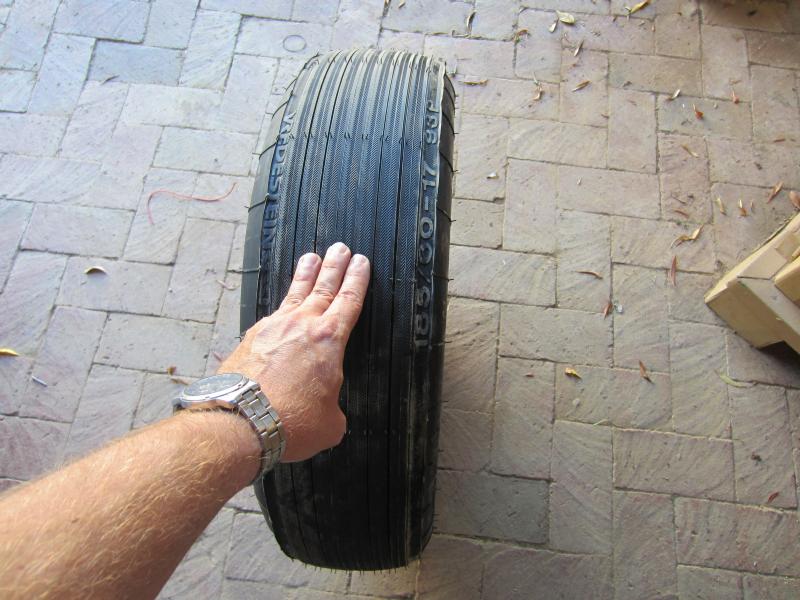

My Porsche dealer phoned my last week to tell me that my spare tire had eventually arrived. I went to collect it and
proceeded with a "dry run", duly documented here for your information.
The inflatible spare tire is a regular, orderable part from Porsche. Check with your Porsche parts advisor. Cost here in
South Africa was around $760 using todays exchange rate.
Here it is, deflated, standing up in the trunk. It is a comfortable fit and leaves plenty of space.

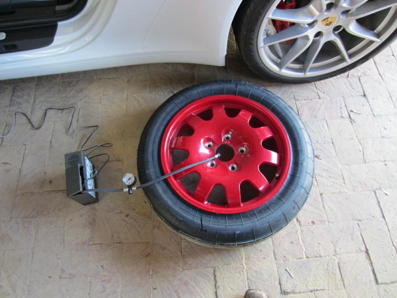

After inflating it for the first time using the electric pump from the 991...

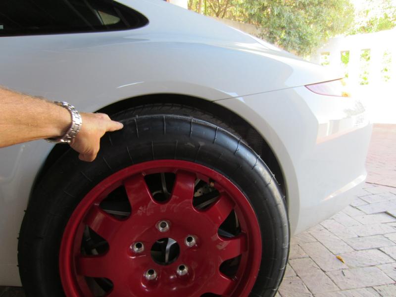

Next to the 20" rears. Nearly the correct diameter, it will do in an emergency.
On first inflation it's a bit lopsided. The Porsche electric pump is a little, ah, shall we say, "not quite up to the task".
I recommend the tire be pumped the first time to it's full maximum pressure of 3.5Bar and held there for a day or so. The
rubber settles into a more agreeable shape.

Fit is perfect, no issue at all. It fits either upright as shown or I put it at an angle so it wedges itself. Either way, it leaves plenty space for a good bit of luggage, easy enough for a weekend trip.
Price is only for the tire itself. The higher price you mention includes some additional, highly overpriced bits and pieces you don't really need or can get at a small fraction of the price from your local car parts shop...

Great info, have you done a actual trial fit on the front to see if the caliper clears?
It clears, no problem. Rim looks smaller but the inside diameter is pretty similar to the 20" wheel.
