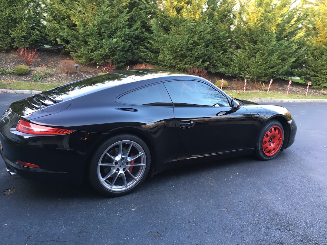

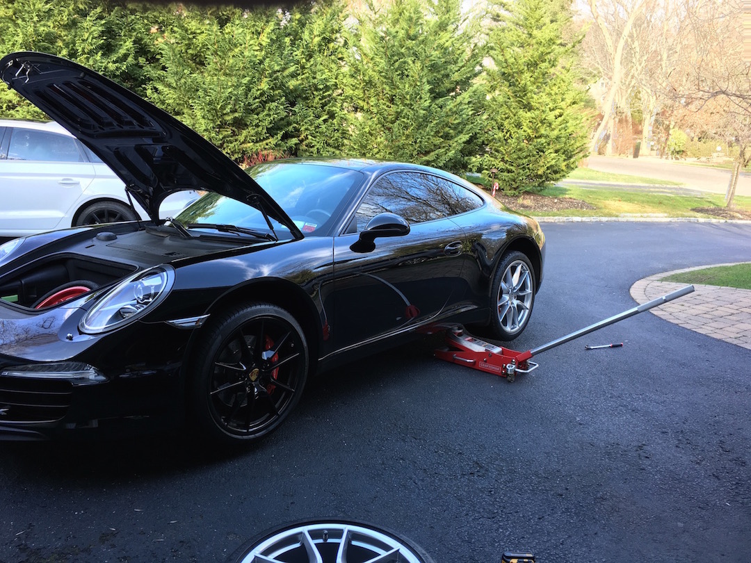

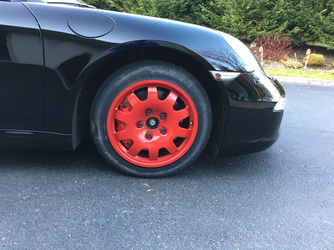

First I apologize to anyone who was waiting for me to try out the spare, the weather has been so warm that I just kept putting off switching out my summer wheels/tires to my winters ...
So no more waiting the answer is yes it works ... I did a test fit when I first got it so that was already know but it also drives with the spare with no issues that I could detect.
I took my car for a quick 2 to 3 mile drive around my area hitting speeds up to 50 mph and I heard nothing strange, no warning lights, nothing kicking in like stability control or traction control, etc.
I took a couple of pics and boy is this thing ugly !!!
