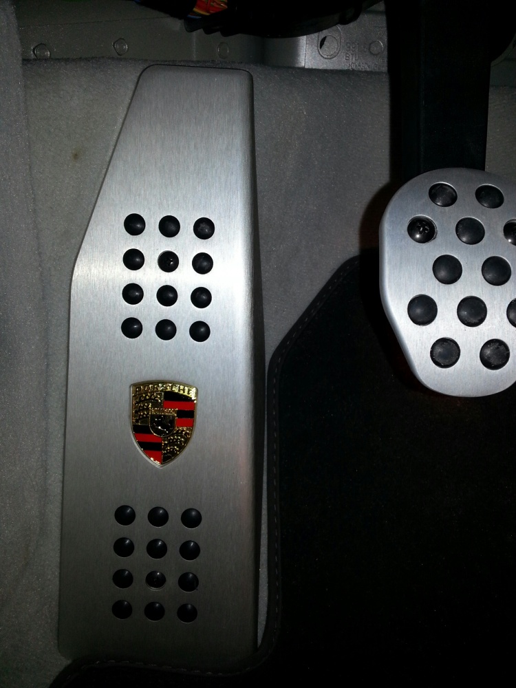

pic#2: the installed deadpedal comes in several variants. this one has a recessed center for an authentic oem metal 356 hood badge ornament (available on the rennline website (and really does comes from pag)--be careful as there are 2 variants of this deadpedal, the other type uses a $9 3-d sticker of the porsche badge, not an oem metal badge. nothing wrong with that one, just giving notice). for anyone interested, the metal badge has a locking washer that slides onto a protruding stud in the back. while it cinches down easily enough, it doesnt get as super tight as a locking screw/nut might, creating concern for a slightly mobile (and possible rattling noise) part. so i used some slow curing, metal compatible epoxy adhesive on the part right along the stud and washer right before cinching. that solidly affixed it. then i just followed the instructions to screw it down solidly.

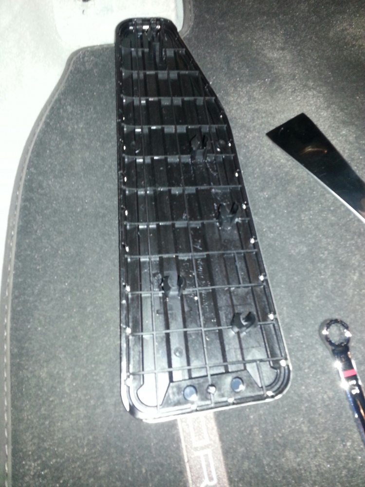

pic#3: this is the backside of the now removed oem plastic deadpedal. if you look closely it has 5 plastic ***** that snap into the corresponding holes. there are no other hooks or pieces that hold it in place. so basically you just need a trim removal tool or some thin right-angle type tool to crow bar the thing off. i slid a metal trim removal tool under the middle and bottom part from the LEFT side of the pedal and gently worked it off one **** at a time. a properly positioned screwdriver from the RIGHT side probably would have worked just as well. it just requires the right mix of force and finesse, nothing fancy.

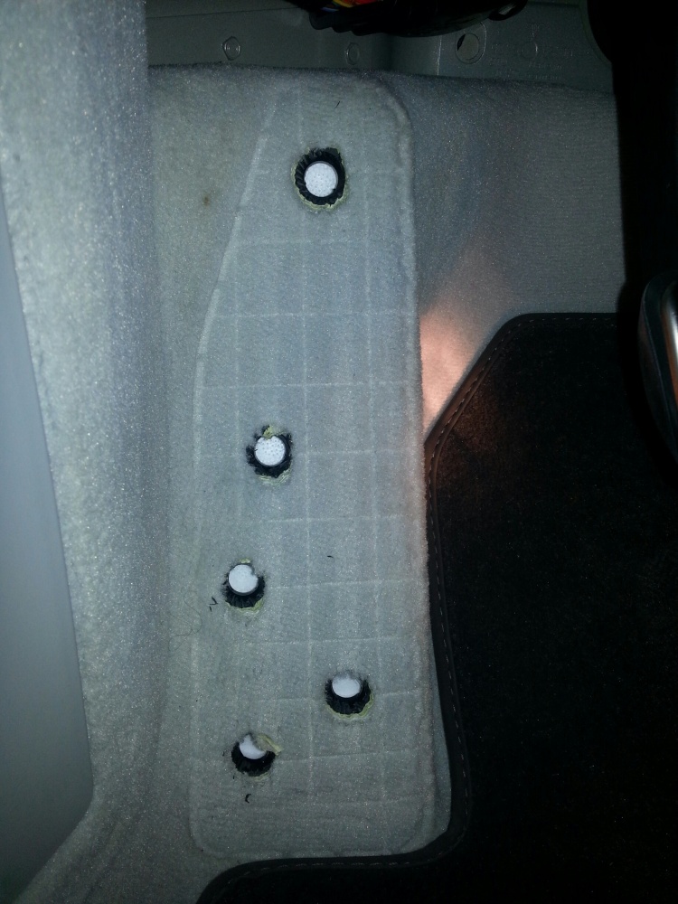

pic#4: this is the deadpedal area sans deadpedal. the layers are: carpet, thin plastic membrane that contains the 5 holes for the pedal's *****, then styrofoam. i didn't look underneath the styrofoam layer since the screws that come with the pedal are not long enough to pentrate beyond that surface.

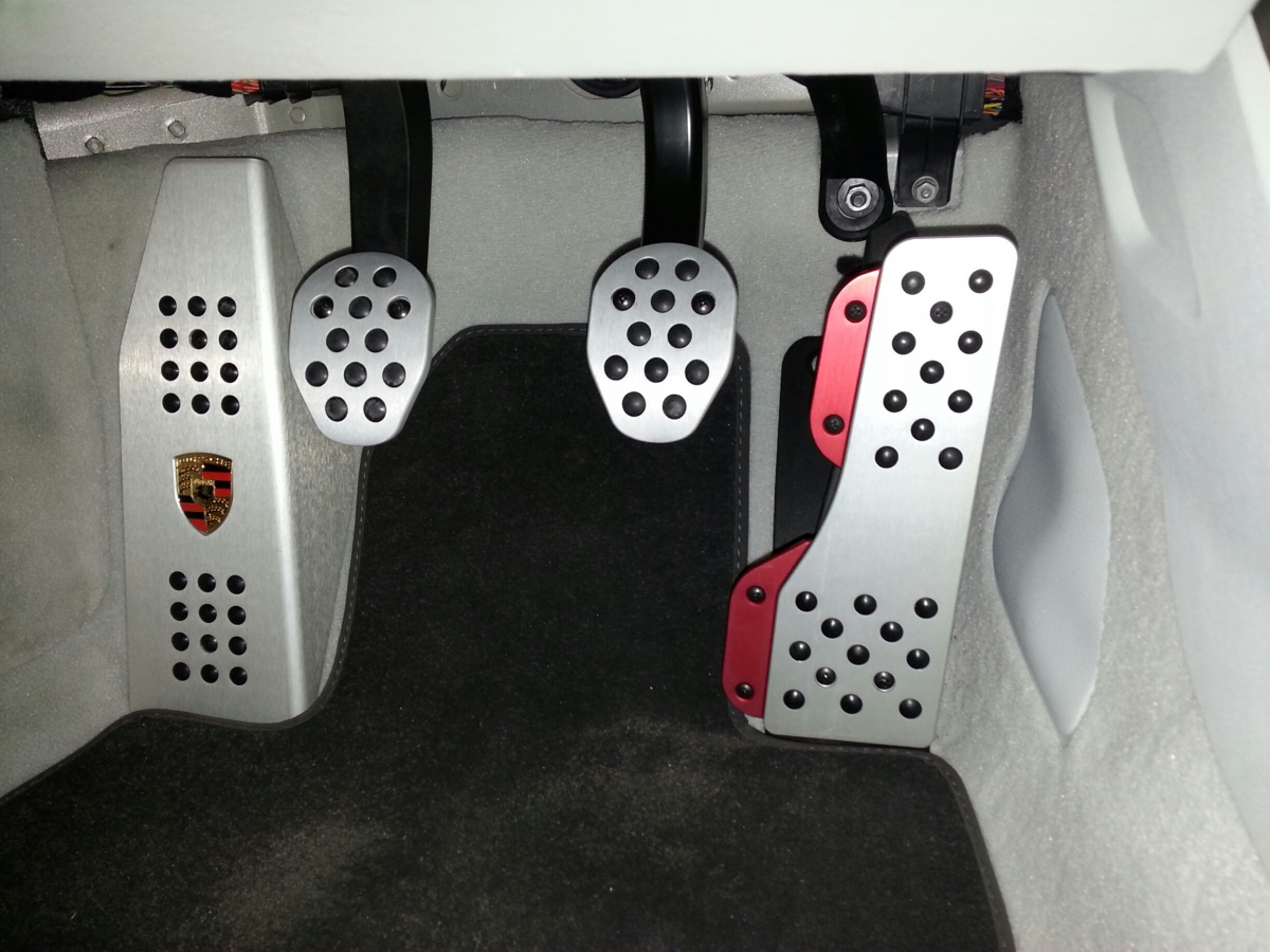

pic#5: side view of the throttle lifter plate on the existing oem throttle and the extension plate and throttle pedal sandwiched on top of it. easy install, it can raise the throttle pedal surface up to 1 inch. i found the oem configuration awkward for daily driving heel/toe downshifts due to the extreme height differences between the brake and throttle. this has helped tremendously! before installing this, i was worried that the throttle extensions (red pieces) would be too close the brake, and possibly producing a dangerous situation where pushing on the brake hard could accidentally push the throttle too. after different degrees of "spirited driving" (but not tracking), i am happy to report that this isnt the case at all. 2d images don't reproduce this well, but note that there is still a good 1 to 1.5 inch difference in height between the brake and throttle and there is good lateral spacing still between the left edge of the throttle extensions and the right edge of the brake pedal.
