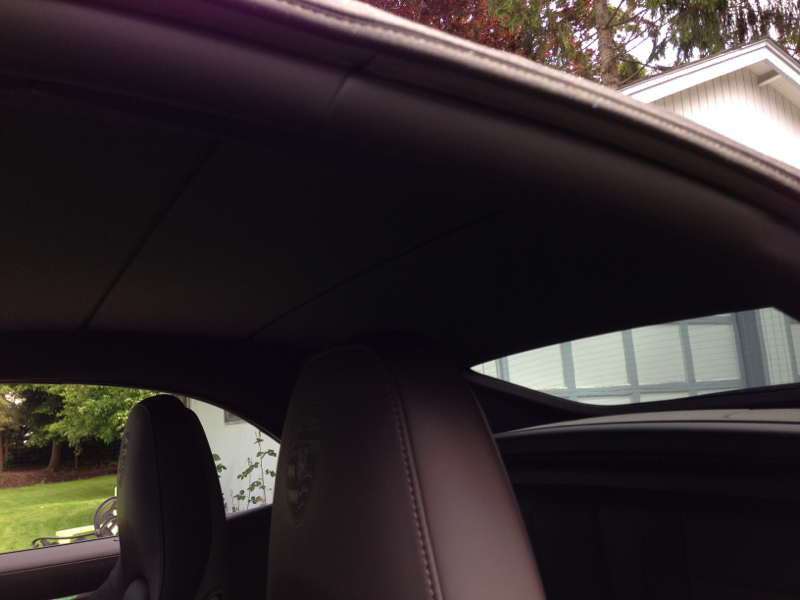

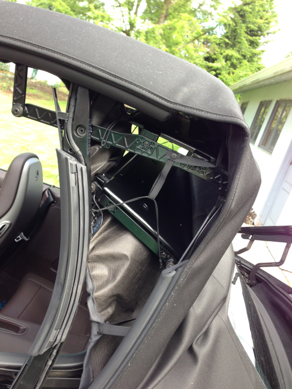

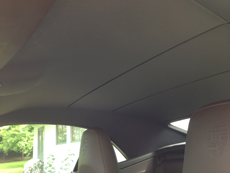

We are talking about a 991 cab roof right? It's quite a bit different than the 997 cab roof (I've owned both). The new cab roof is fabric over magnesium plates and doesn't come open at the sides between layers of fabric like the 997 cab roof did. There are nice solid plates in there now. You can't knife through it.

Hi,
thanks for the pictures, I will try to get a picture up here later to let you guys see what I mean. Tried posting but apparently the file size is too large and I do not know how to resize it.
