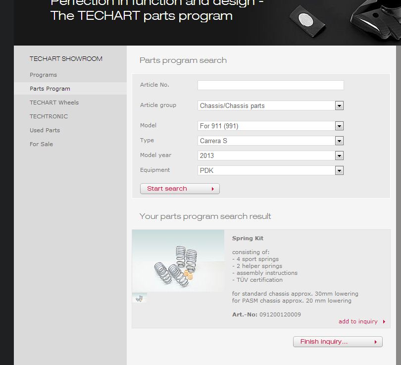

I don't have Sport PASM on mine and the wheel gap is starting to bother me. As much as I wanted to leave this car stock I think the mod bug is starting to bite. Starting with springs, I know H&R has a kit and TechArt as well. If you have any of these and can post pics it would be great. H&R is probably the route I will go since the TechArt is only 20mm and I would want a little more than an inch up front.

Im glad you started this topic--- I have a S-Pasm car and it sits pretty good, I could use a small drop. To the OP I know you said Techart has 20mm springs but I cant seem to confirm this on any vendor sites or even via the TA website. One vendor emailed me and said 30mm which is too much...

It's right on TechArt's site when you select parts program. It says 20mm for PASM and 30mm for nonPASM. I assume that means if you have a regular 911, not the S and without PASM the total drop will be 30mm but if you have a 911S then it's 20mm since it has PASM standard. With SPASM you will not notice much a difference since it's already sitting lower.
I'm leaning towards to H&R at this point, I did message a few other owners and they all said the ride wasn't affected much.

Thank you I went to that exact site and did see the specs weird.
Ok so this is odd to me since the springs set the height not the dampeners... if they drop the non pasm 30mm how can it not drop a pasm car 30mm? Its the same spring right? So the spring is going to change its rates or amount of coils depending on whether the car is pasm or non pasm right (which makes no sense- a spring is fixed)?
Or are there two different part numbers?

With PASM you already get springs that set the car lower from the factory compared to a base model. Therefore putting the same aftermarket springs on both cars will have a different impact on height since one is lower to begin with.
