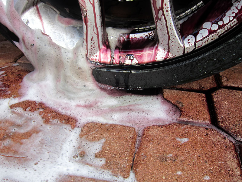

Originally Posted by lunarx
Rotor Contamination is the only thing left, that I can think of. Is there some chemical getting sprayed on the rotors that interferes with the even transfer of pad material to the rotor?
I never had any issues with my brakes until I started using this stuff:
Soon after I started using it my brakes developed a squeal when I stopped. Eventually I stopped using Sonax and about a month later the squeal went away. I'm not saying the two were connected, but I was always suspicious it was somehow the cause.
