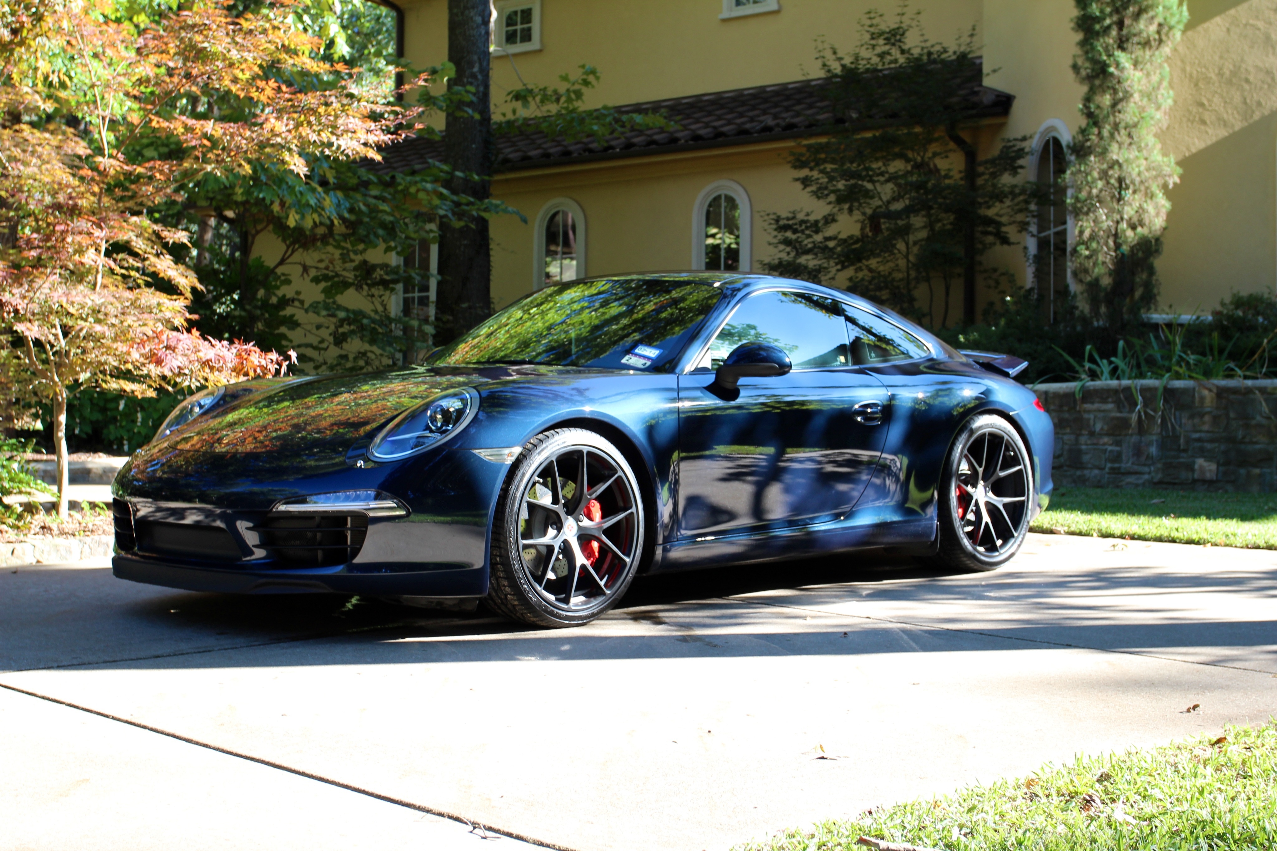

I recently changed my wheels to the HRE P101's. I had wheels boutique send me wheels with tires and factory TMPS. Since mounting the wheels, I get a tire warning error code. I was told the car may take awhile to recognize the change. It has been well over a week and no change. Any advice? I've read the owners manual and can't seem to find a solution. I don't have a local dealer. Thanks in advance

Sorry to hear about your sensor problem, but man your car looks incredible with those wheels on! Wow nicely done. I hope you resolve that issue.

Hope you figure it out. Car looks absolutely smashing with those wheels.
