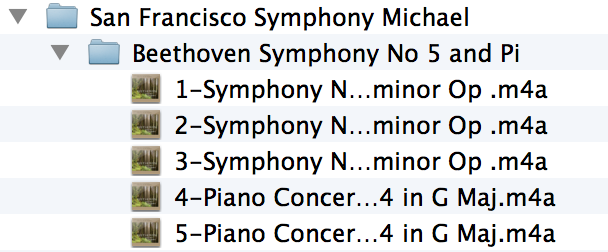

My tracks have track numbers in the names. See attached picture. When I play that album the Piano Concerto plays before the Symphony.
So now I'm thinking of appending a T (for track) in front of the file name which should prevent the PCM from stripping them as it builds its database (at least I hope.)

The symphony album is in FLAC format on my laptop, downloaded from HDTracks. I used XLD to reconvert it to AAC 320kbps this afternoon. I reformatted my USB thumb drive. I loaded the album (enclosing folders of SF Symphony and then Beethoven's 5th) on the thumb drive.

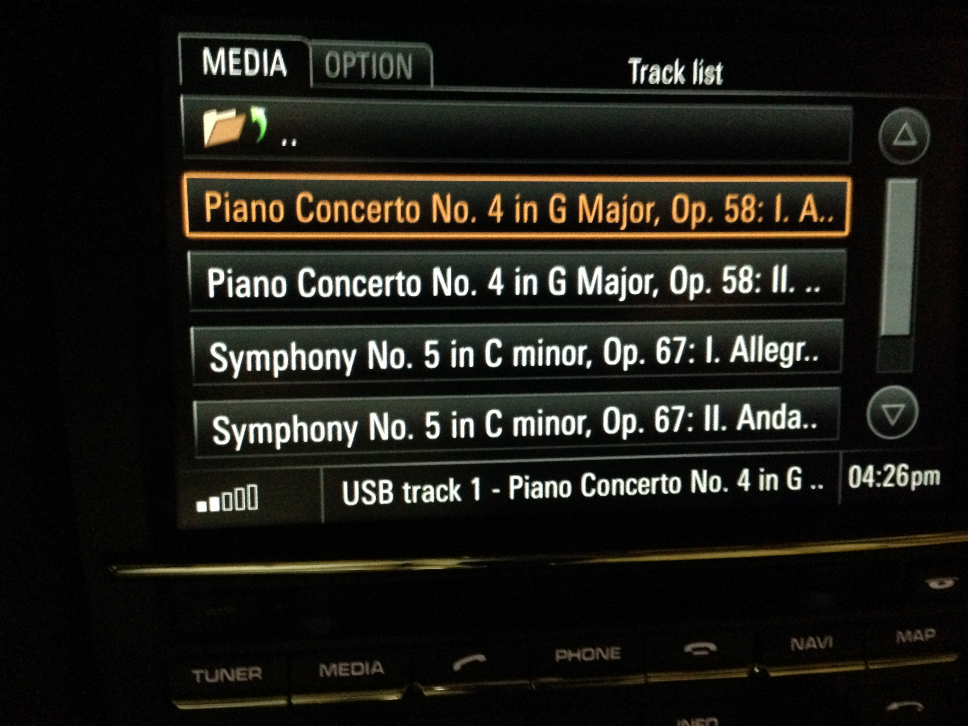

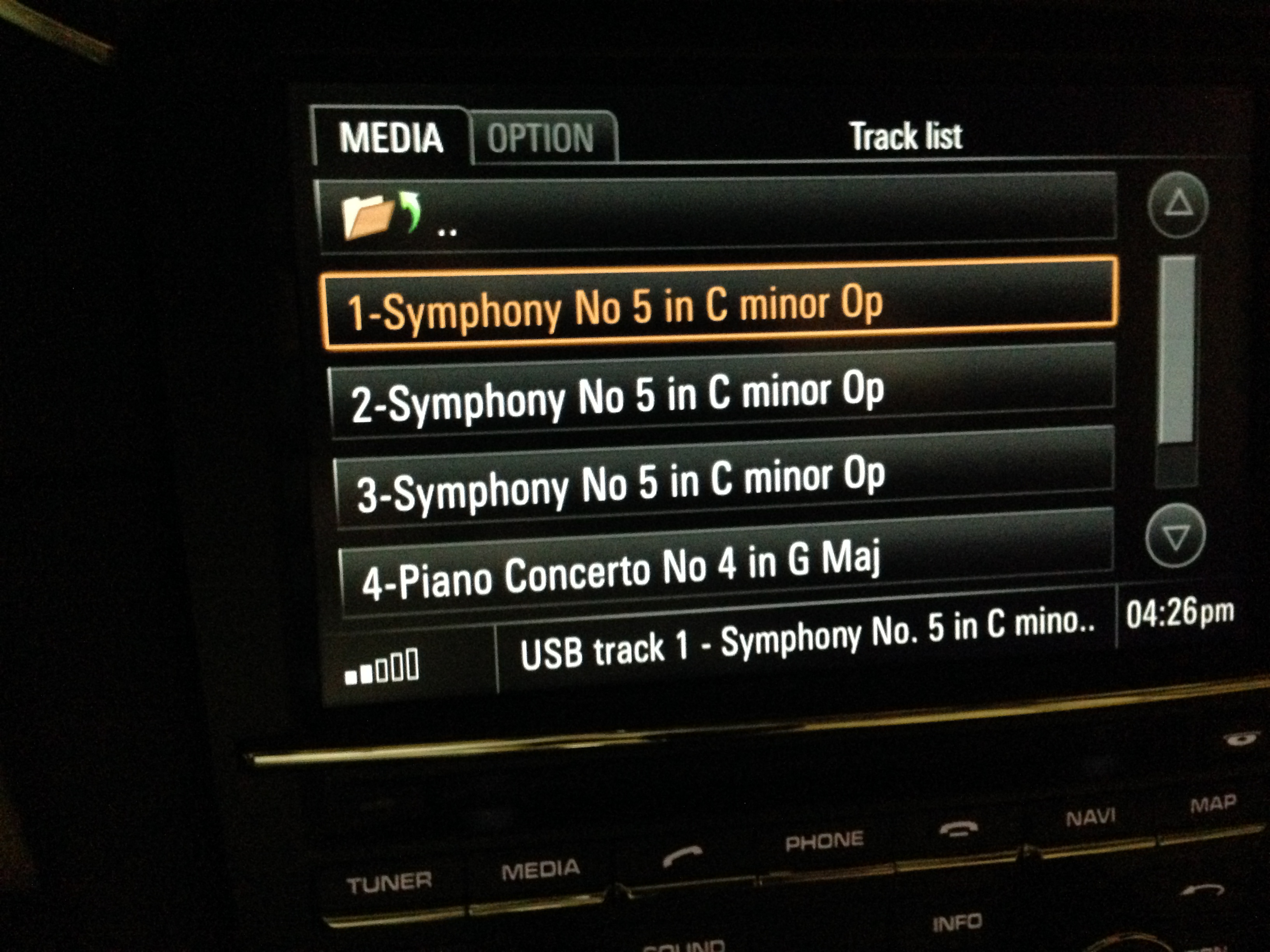

As I plugged in the thumb drive, PCM recognized it and told me it had a USB device connected. I switched the source to USB and got the first track, with the 1- in front of the track number playing. This is shown in the first attached picture. Brilliant, I'm thinking, I just have to reconvert all my music (easy) and I'm golden. At the bottom of the PCM screen it tells me it is "building music database" (or some such.)
I decide to go search for music. I search for the album, select it, start playback, and what comes up but the Piano Concerto. No 4- in front of it. See the second attached picture.
So now I know that it's the searchable database that is the problem. And from a data indexing perspective, I get that. (For those who weren't database administrators in a prior life, indexes are small searchable lists which can be parsed quickly to find key values, then have pointers to the actual data you need. If the software didn't strip the numbers in front of the tracks, the index would be "bunchy" with lots of values starting with 1, 2, 3, etc and not much dispersion in the key values.) I just don't know why playback can't use the original file name rather than the stripped track name. So at this point, I know what happens, I don't know if I can change it (I suspect not.)
I'm going to try a couple of other things, but I am not hopeful. More later this evening.
I wouldn't go as far as to say I'm upset, rather just confounded that the Porsche engineers think it's ok to serve an album's tracks up in alpha order rather than in recorded order.

Given that you got step one to work correctly I ask you the following but with more specificity than before-- is the ID tag track name in the metadata preceded by a numeric, is the ID tag track number in the metadata the same as the numeric of the ID tag for the same track, and finally, is the track name of the file itself (for example what windows file manager "explorer" sees and shows you on your PC) preceded by a numeric and is the same as the Id tag metadata track numeric and the ID tag track number? I can use dbpoweramp, windows media player, or itunes to rip my music with the above and music plays correctly on a USB drive of any kind, my phone in drive access mode, and a USB hard drive.
I hadn't checked this until this morning, but you are right. The metadata track titles did not have preceding numerics. I had doubted that would be the case, but I was wrong. I've found Mac software to edit the tags. I have converted a small set, tested it, and it works great. Thanks for the follow-on question, it turned out to be the right place to look. I'll post a detailed write-up of my process sometime soon so nobody else will have to bang their head against this particular wall.
