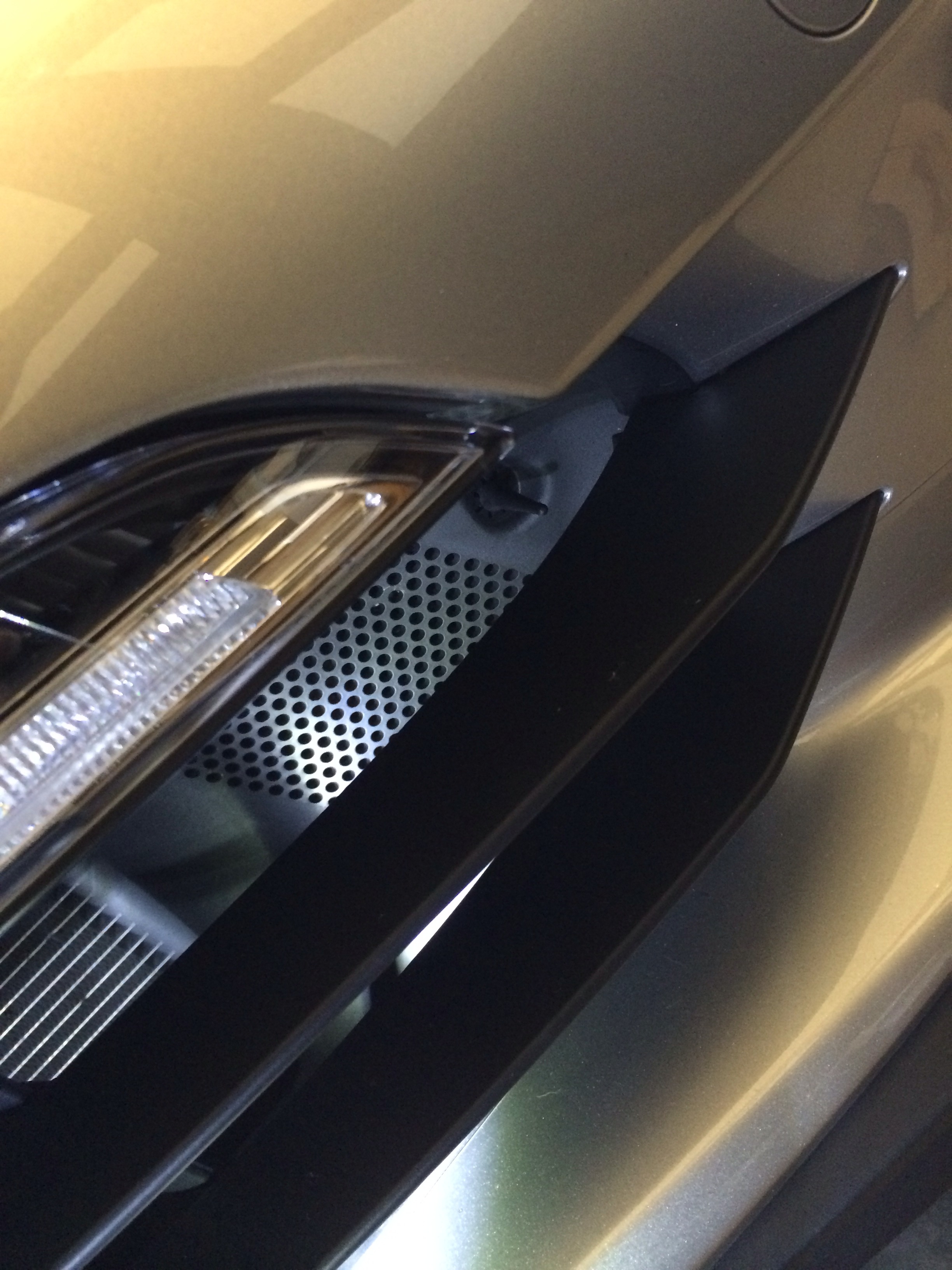

Hey guys, any chance sharing a photo of this sensor ? Where's it exactly located. I know mine is slow as well...thx

Here it is... Little pointy thingy on front.

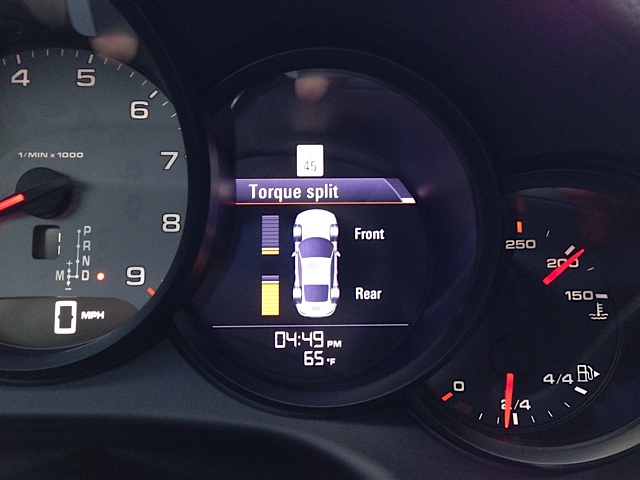

I got that car back today, they confirmed the sensor was reading 10 degrees off. They ended up recalibrating it and reprogramming the instrument cluster. An interesting change I noticed was in the all wheel display.
That's a sweet feature. Did you not have it before the dealer reprogrammed the cluster?
I had the feature, but before it said allwheel, now it says torque split.

Yes mine says all wheel too. They must've updated the pcm program. Wondering what's your version now?
Not sure how to check the instrument cluster software version, its different from the PCM version. Im thinking its the 2014 model software.
