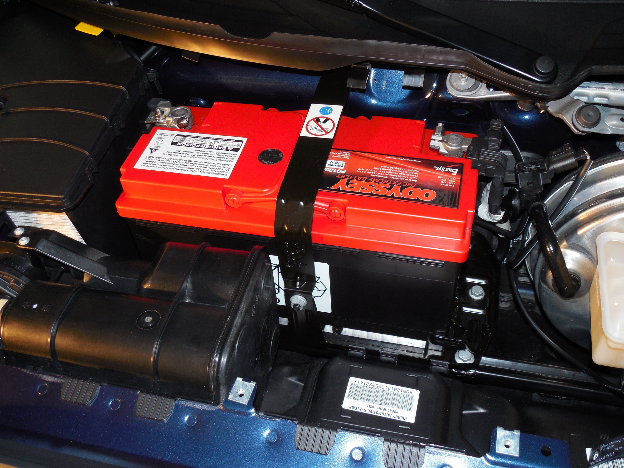

Add 15lb for 25Ah?
Original Battery:AGM 70Ah 45lb.
Odyssey PC1350:AGM 95Ah 60lb.
If fits
With all the electrical on these cars I thought it was worth the weight penalty.
Plus, I always had very good luck with Odyssey Batteries, they are one the most dependable batteries you can buy and not that expensive either.
If you do get one make sure it's the newest model (w/ plastic handles) as the old model (w/ rope handles) won't fit.
FYI - You might need an 8M-1.25 tap to clear out rusty threads at the outer clamp location.
ID:	315639   Click image for larger version
