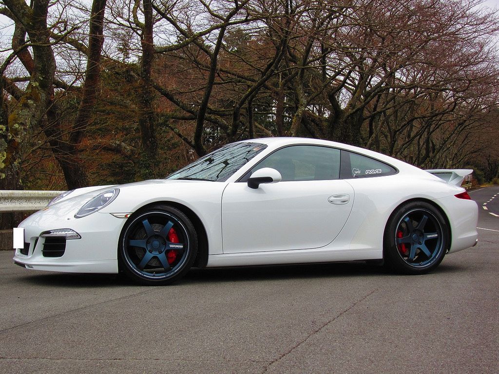

20s are not ideal for track use, but the Volk TE37 Ultras would be my first and only choice.
If I can't find a better solution or custom Forgelines(19s and still searching for the right tire sizes) I'll get these and throw on the new Sport Cup 2s, same set up as the 991 GT3.
You don't get a better track wheel then Volk TE37s, used several sets in the past.
