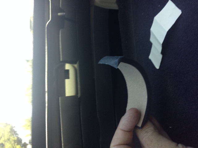

I have a Turbo S with an exhaust, and as much as I love the exhaust sound and performance, interior drone at idle and cruising along is a bit much. So I followed this great DIY, and also then added a bit more insulation since i had the rear cover off. After stuffing the tube with sound deadening material, I bought a roll of 1.25 inch wide, tape back insulating foam. I lined the entire rear of the area with the foam tape, and then re-installed the cover. Soooo much better now! Can hear the radio when cruising, etc. Plus, still sounds like a beast under WOT with the exhaust.
ID:	396524   Click image for larger version
