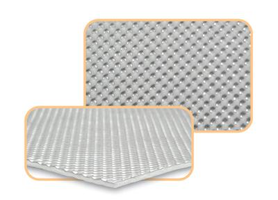

Boom Mat Floor and Tunnel Shield Insulation. High heat, stick on, looks good, and doesn't weigh much. Also, maybe some closed cell foam in back, just not sure how it would look under the carpet.02 T

Originally Posted by drcollie
That is really my one and only gripe about the 991, the road noise from the rear tires - its a bit annoying on the interstate. I'd buy a full set of insulated wheel liners if there was an aftermarket vendor that offered them (Opportunity!). I may just pull off the partial front liner and line it with some Dynamat when I need a project, that might reduce the tire/road contact noise some
I did that to the front and partial rear liners. The results are good and the noise definitely has been cut down. But the lack of full rear liners still allows for stones to hit the mufflers and it is quite annoying.
Good tip then, Brad. Any idea how much material you used? I think I'll order some up...
I don't remember exactly, I did it last summer. I think I got around 10 or 12 sq ft and had plenty left over. You can easily estimate it by holding a piece of notebook paper around the wheel well and count off each as if it were one sq ft. This will give you plenty of margin for error.
Be sure to get the thinner, semi-solid stuff, not the super thick foam, since it is in a place that could get wet. As an extra precaution I sealed the edges of mine with a sliver of duct tape.
I peeked at mine recently when doing some brake work and it's all holding on quite well almost a year later.
