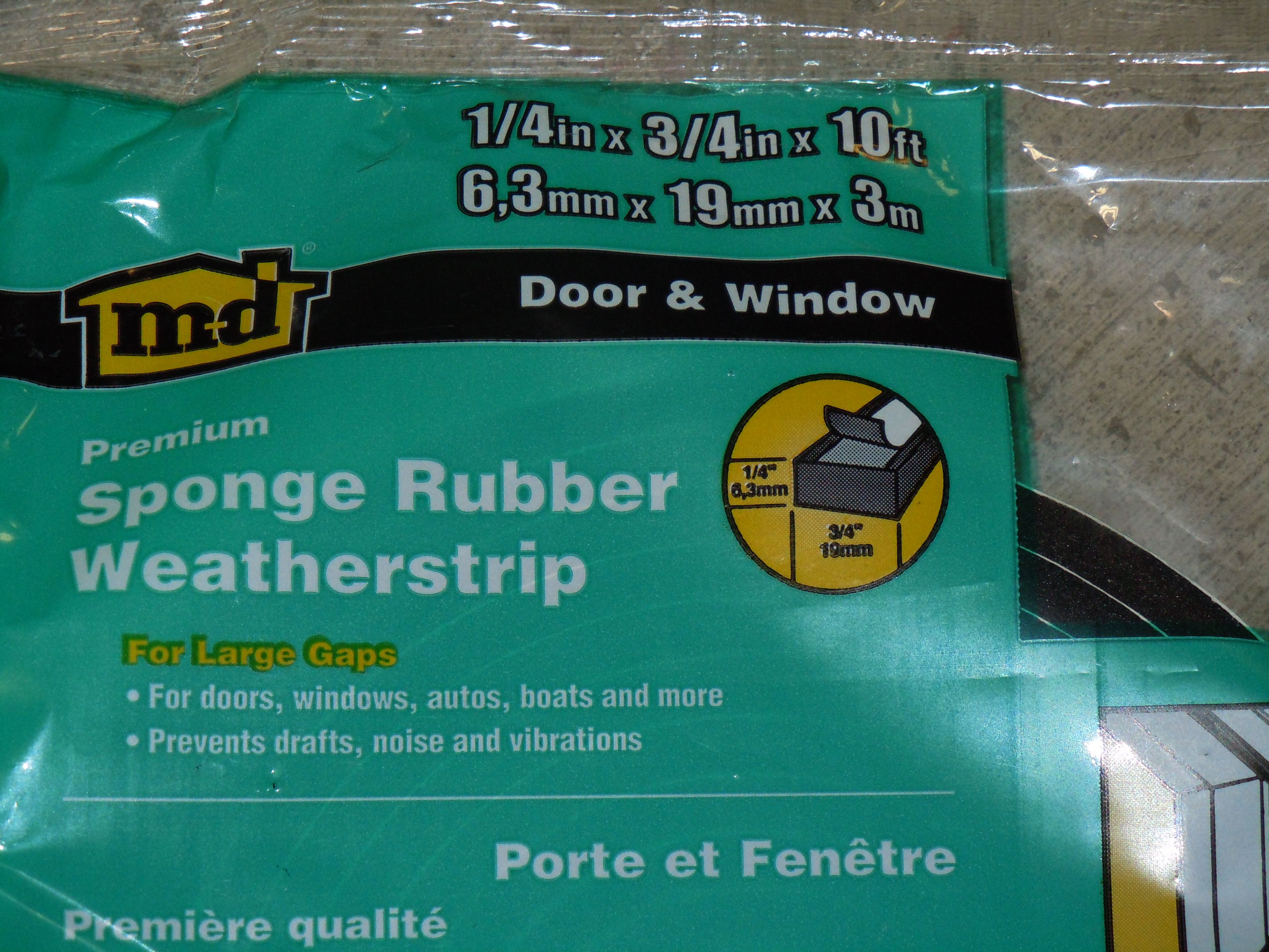

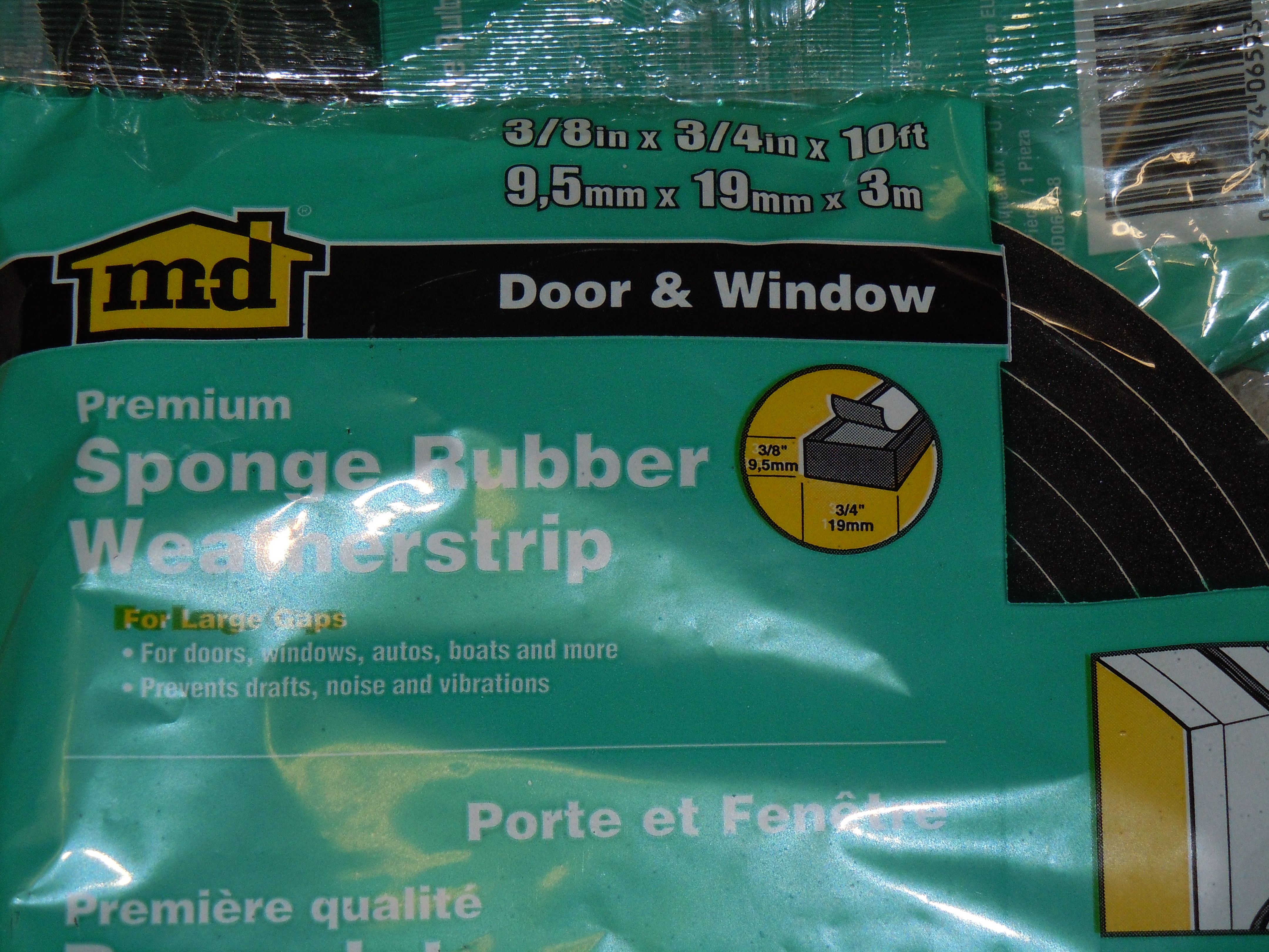

I picked these up at home depot and was able to eliminate some of the trim rattles, especially around the rear windows. I was able to push and place small pieces under the trim with my trim tool.
ID:	360686   Click image for larger version

Self sticking Velcro (fuzzy side) works great as a rattle cushion, too!
