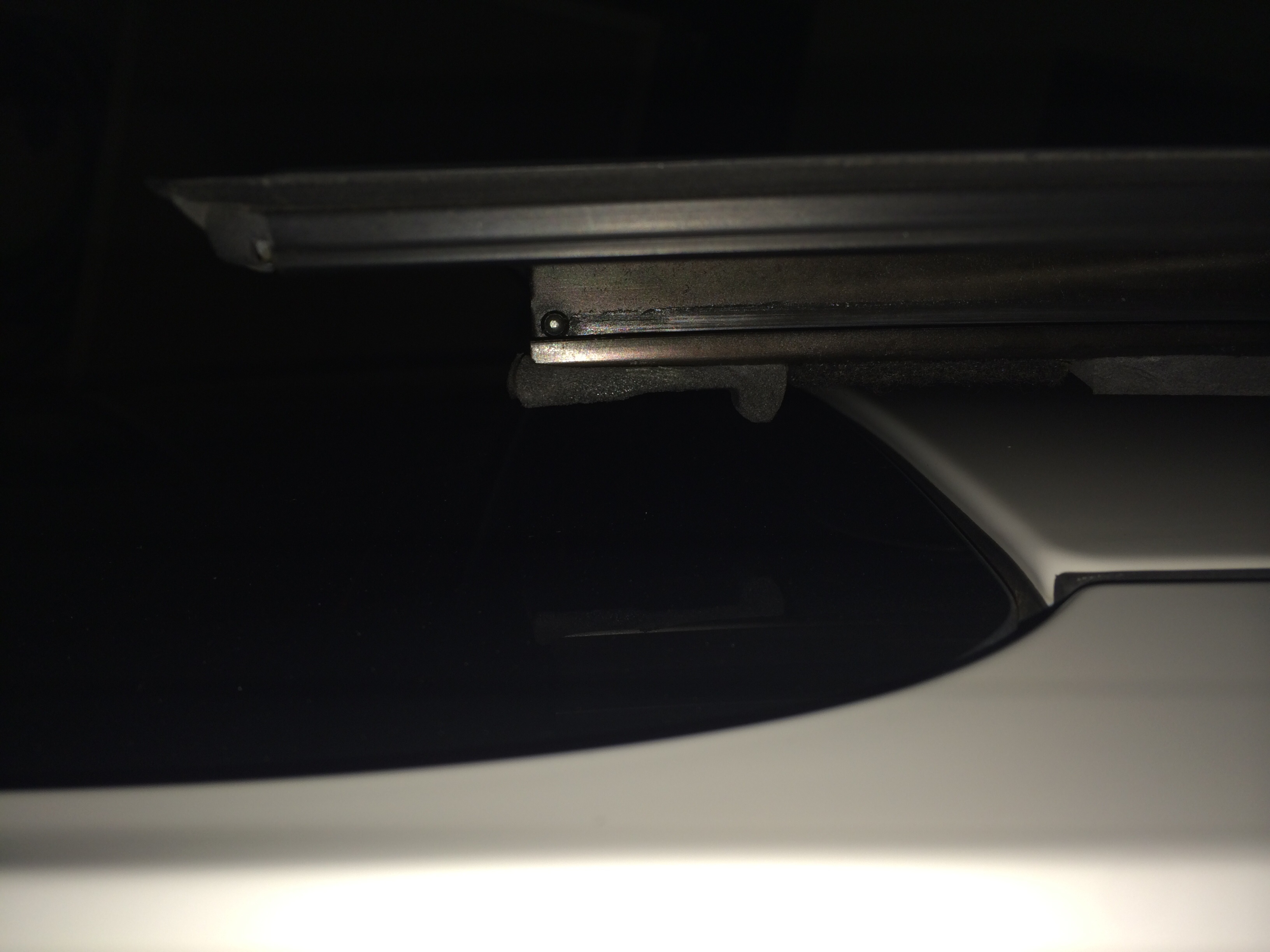

@last's Avatar
Joined: Mar 2014
Posts: 14
From: South africa
@last is infamous around these parts
Originally Posted by mdk888
If someone doesnt mind and knows how to do this, can you post maybe a video or pics on how to do this? I am not exactly sure what needs to be done here, and I would like to try it myself to fix the sunroof rattling. I tried poking around and had no luck. Thanks.
Here we go. Pics of the sunroof. Felt and the sponge tape I used. No problems since I did this and the dealer took a week and it came back ... Been good for a while now.

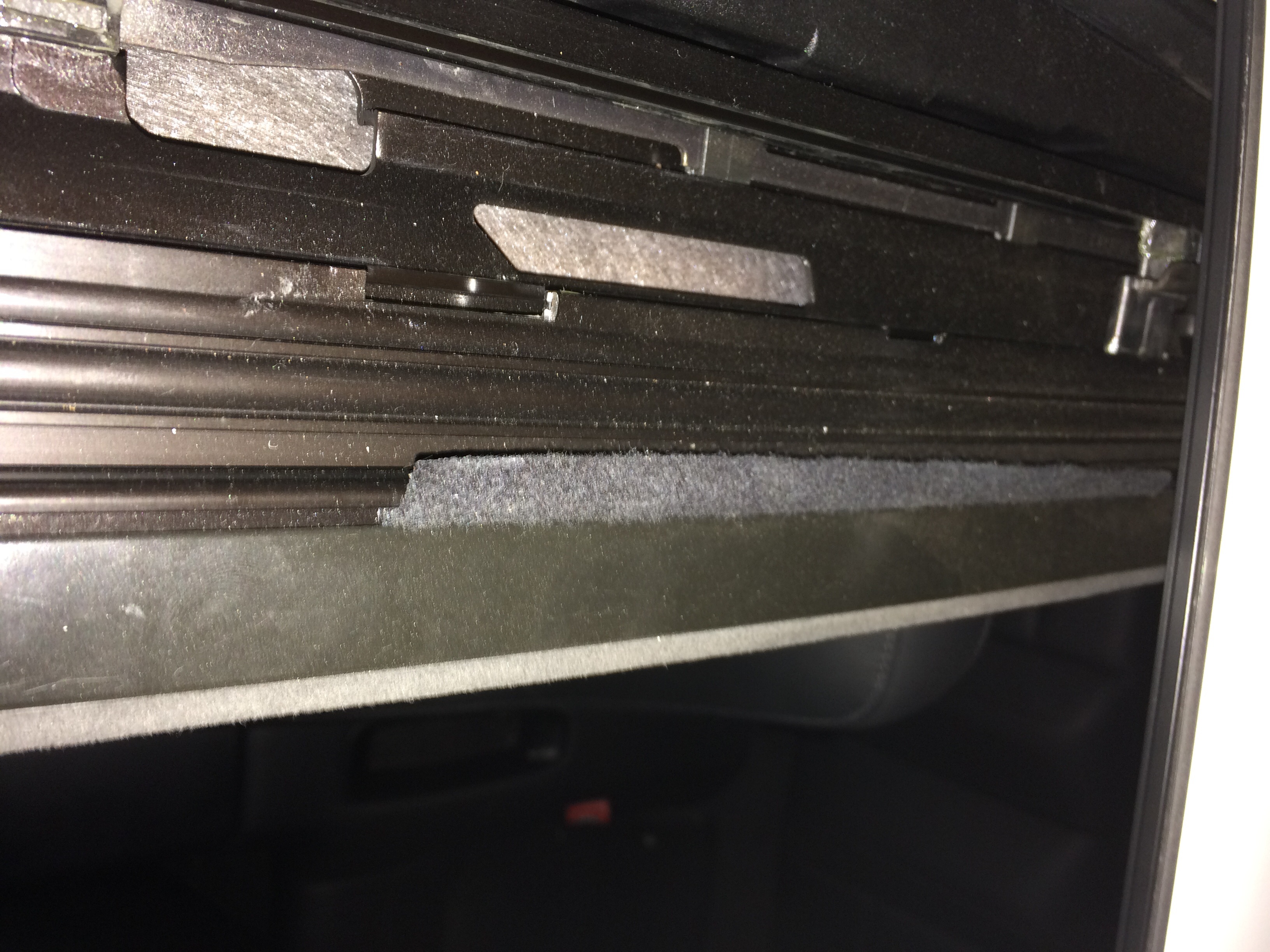

@last's Avatar
Joined: Mar 2014
Posts: 14
From: South africa
Sunroof pics
A pic if the sponge tape. This was the main contributor to solving the rattle.
