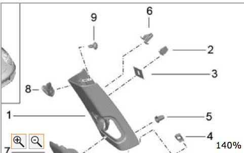

I am having problems with a buzzing sound from the seat belt mounts in the B pillars. Are the b pillar covers easy to remove without snapping clips?
yup its easy. there is a clip on the top to middle area on the left inside of the pillar you just need to be careful with this one, you actually need to pry it out i found or try slide the cover to the right when all the other clips are loose, the others come out super early. i had the same buzz turned out to actually be the clips buzzing in the housing stretched them open put a bit of prestik to help hold them in place in the housing and rattle was gone.
don't know if you guys have prestik in the US i remember when i was there in the early 2000 you did not have it. its a south african product i think, i know the UK has it too.
it clip no 6 in this pic, that the one you have to be careful with.
