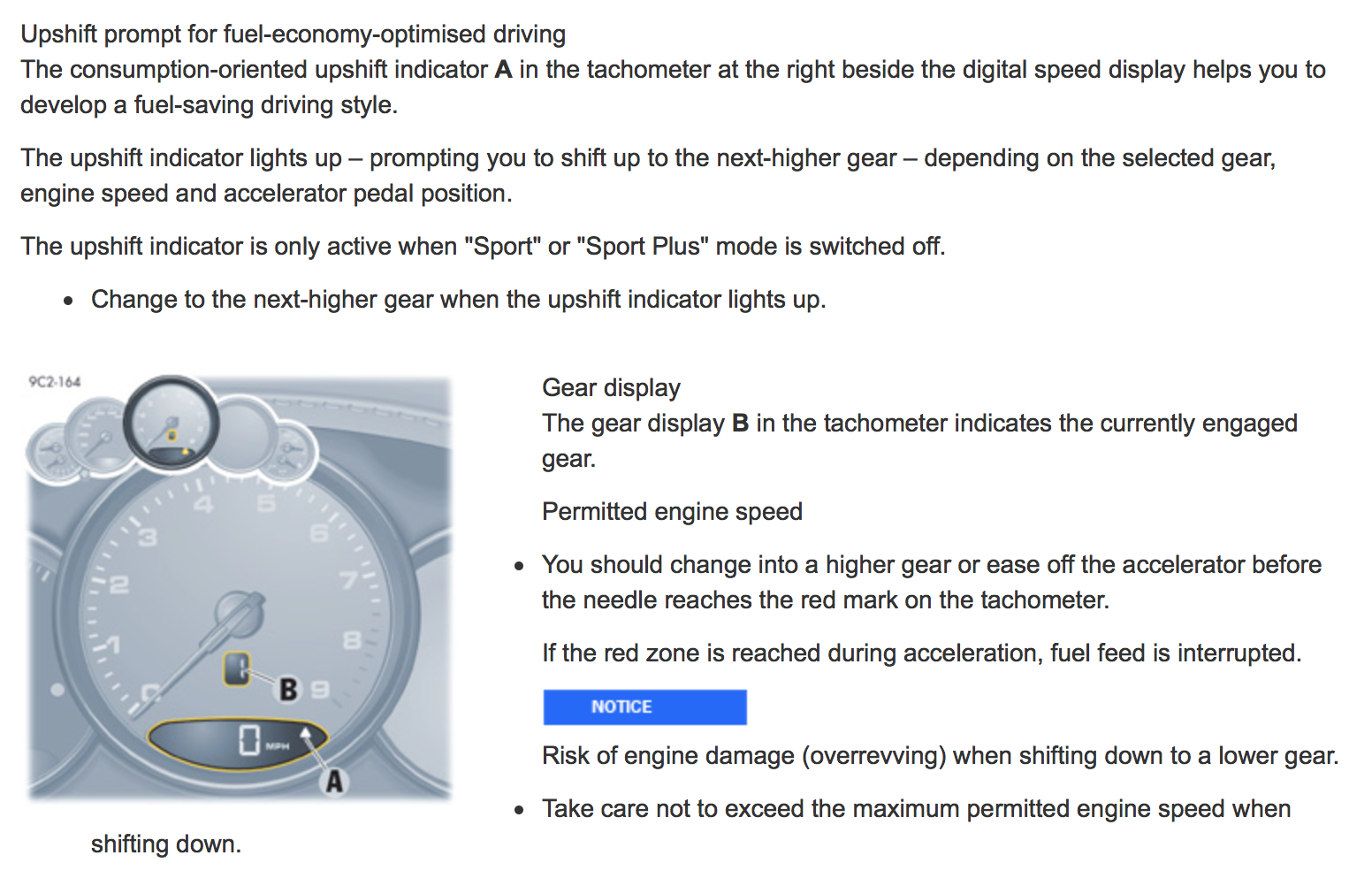

So this wasn't annoying me for a while, but it is again. The upshift indicator to save gas is supposed to come on in "Normal" mode. But based on the manual, it should not come on during "Sport" and "Sport Plus" mode. Mine is active all of the time. I've attached the picture from the manual.
Have others noticed this? Mine is a 2014 C2S. Others have mentioned they can turn it off through the PCM. If so, how?

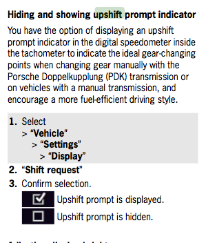

There we go:
Vehicle -- Settings -- Display -- "Shift Request"
Taken from a Panamera manual, but applicable to 991s:

Originally Posted by Christophosphorus
There we go:
Perfect. Will go through this when I go home today.
There we go:
The menu in mine doesn't have that option. I just sat and went through every menu. I'm pretty tech savvy, but hopefully I'm just missing something. Or maybe I have to live with the fact that the 2014s have the annoying little triangle on at all times. It will be especially important for those of you who track your cars in Sports Plus to know when to save gas.
