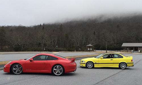

A good old E36 M3 is a ton of fun on the track. In order not to get a dedicated track car that requires a trailer, I bought one for my son (who also started tracking). Cheap option, but I still mostly track the 991
