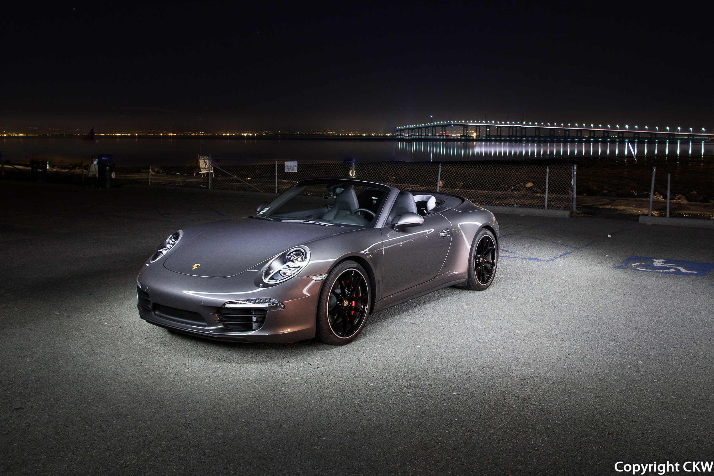

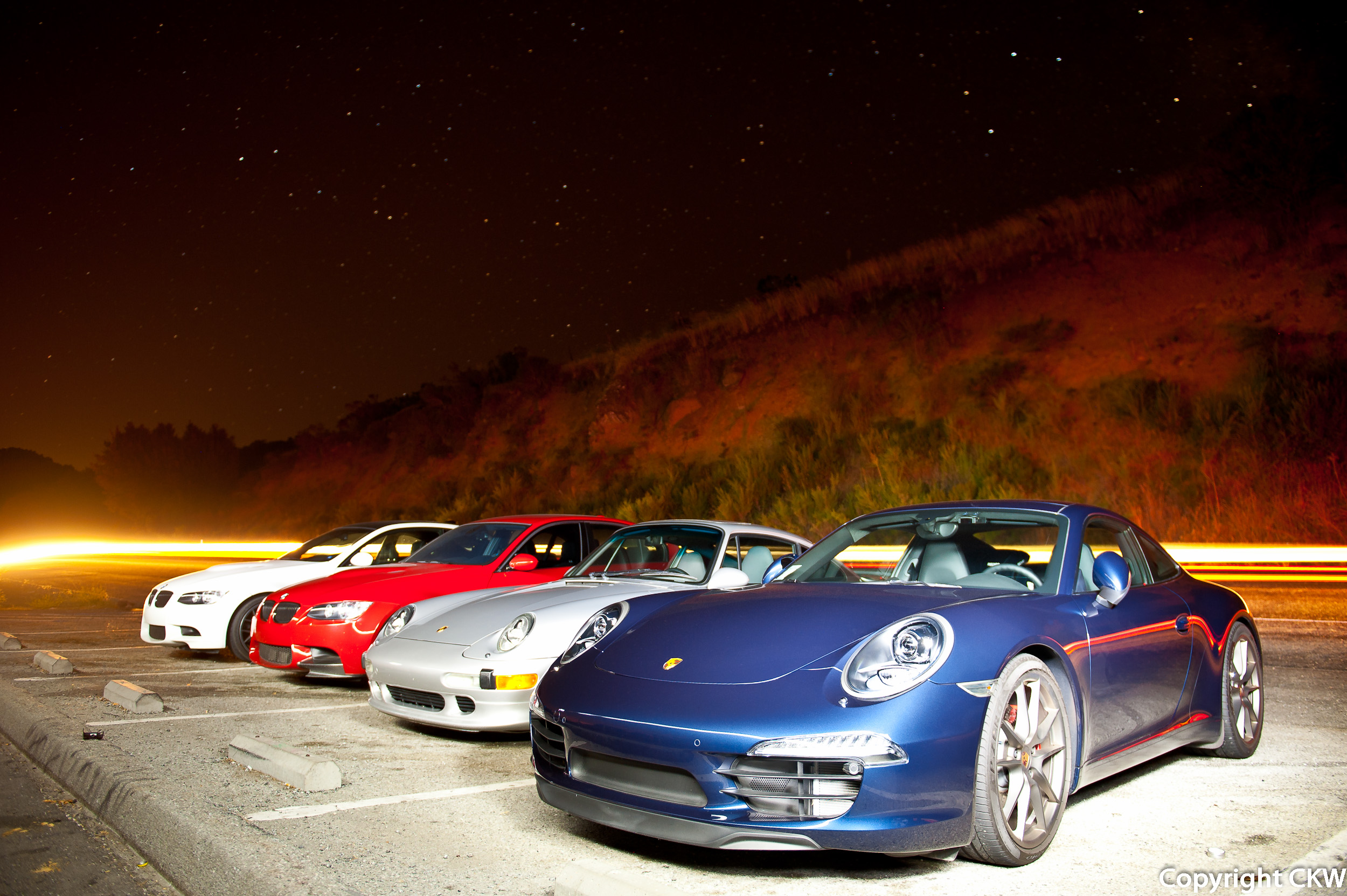

Does anyone have pictures of their PASM (non S-PASM) 991S with 7/15mm spacers? I'm about to pull the trigger on a set of these, but I'm afraid that 7/15 may look too aggressive on a non-lowered car.
Also, anyone with a 7/15mm setup tracked their 991? Tommyboy's comment makes me think twice about running this setup since I track the car.

I ran the 15mm rears on my C2S and loved them. (Sport PASM)
My C4S has 7mm front (Brey Krause so they have the split centering ring) and they're great. I re-used the same hubcentric 15mm spacers on the rear. (Regular PASM)
