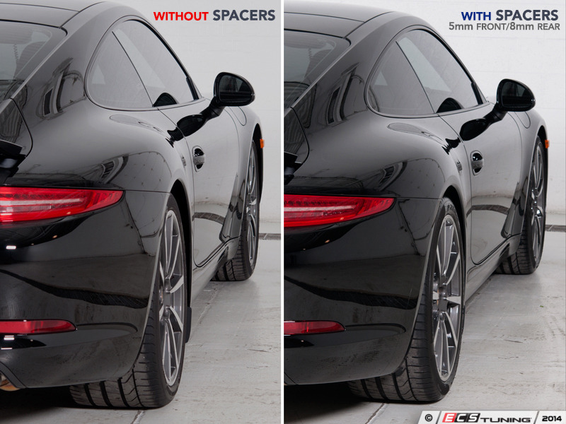

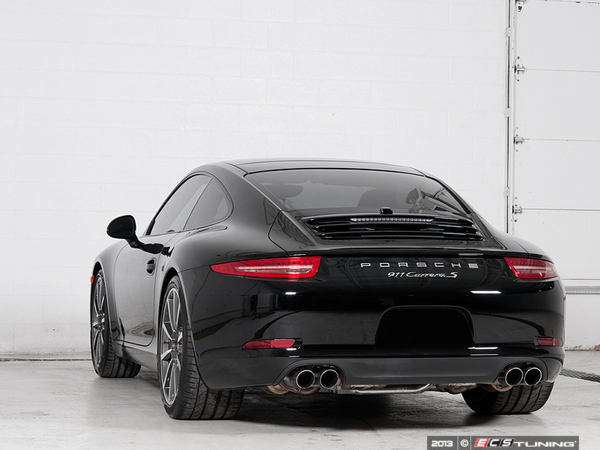

We installed 5mm on the front and 8mm on the rear with no issues at all. It all depends on personal preference. Here are a few pictures we took to give you an idea. For more information on the Spacer Kits Click Here.

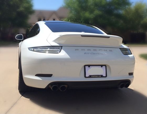

Originally Posted by shaytun
I have H&R 7mm front and 15mm rear on my C2S. Perfect stance. Doesn't stick out. Hubcentric. There is no difference in driving feel and also no vibrations whatsoever.
Same here. Agree that 7/15 is the perfect set up! Rear at 15mm fills the arches perfectly with no rubbing issues on stock (S) height. I will be upsizing to 305's SuperSports when the Pirellis wear out and MAY drop back (10 or 12 mm) if they look too wide.

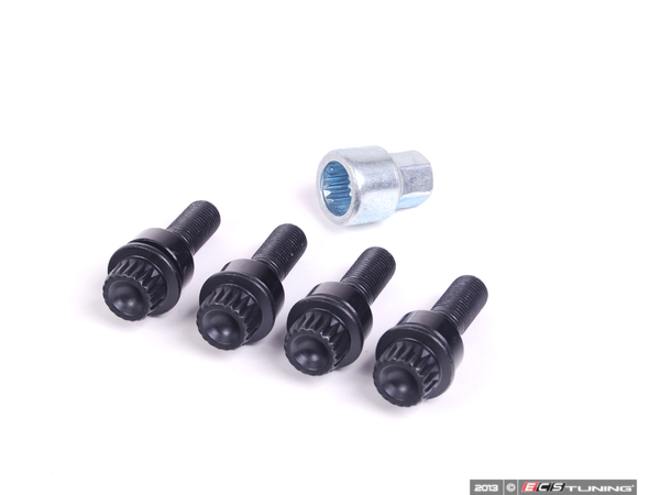

Any idea where to buy locking bolts that fit the spacers given that the oem locks won't fit or do you go without.
We do offer the extended wheel locks from Porsche for lengths of 3mm to 7mm spacers. I haven't seen any longer then that though. For more information Click Here.
That's great, I've been looking for them. Can you confirm that they are 14x1.5 with R14 ball seat? What's the shank length? I can't find that info on the product page. Thanks!
They are 14x1.5 with R14 ball seat, as all Porsche bolts are. Shank length is 50mm (35mm threaded length), which is 5mm longer than the original 991 bolts for vehicles without spacers.
Perfect! Thanks. Placing the order now.
