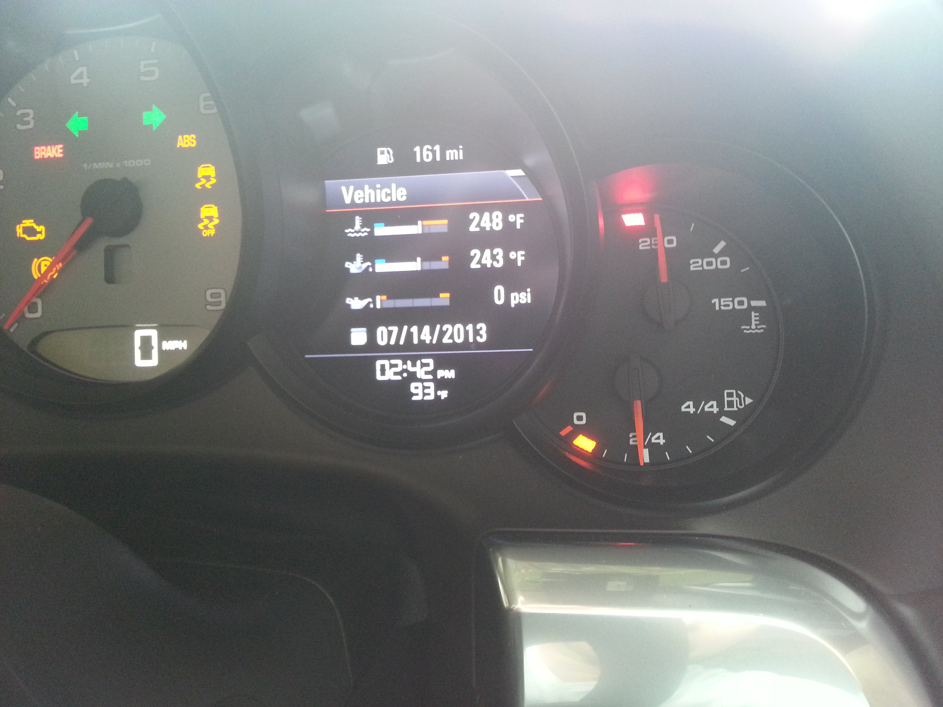

Very interesting, Fester. We both were part of the first batch of US-bound C4S builds and both have had the same problem! Maybe it's our scaldingly-hot espresso interiors!
I had this happen to me a year ago when on a long highway drive from Boston to NYC in high ambient temps (100degF-ish).
I turned the car off on the shoulder and let the temp drop back down to normal. Restarted the car and temps stayed perfect.
I brought the car in for service the next day. They said that they saw the code and insisted that the problem was software related. They did an update to the software for the instrument cluster and said that would take care of it.
I was (and still am) skeptical of the "fix", but to this day (5000+ miles later) I have not had the problem return.

Originally Posted by Fester
I have appointment on 6/2...I guess will find out more...

It's one of those things that they need to "reproduce" to prove it out.
First thing they do is to "look" for any "fault codes" by hooking up the computer. Nothing found.
Then they checked the coolant line for "leaks" - no traces.
Then they drove the car and the coolant stayed pinned at 194F.
All of this after showing them the photograph and call at the time of the incident.
The only thing I got out of it is PDCC and PCM software updates and perhaps loaner Hybrid cayenne S.
Well in 15 months of ownership it heated up to this level twice...so I don't know....I'm beginning to wonder how "reliable" these cars are????
May be as per Brianja, the software could fix this issue...but they couldn't find any fault codes

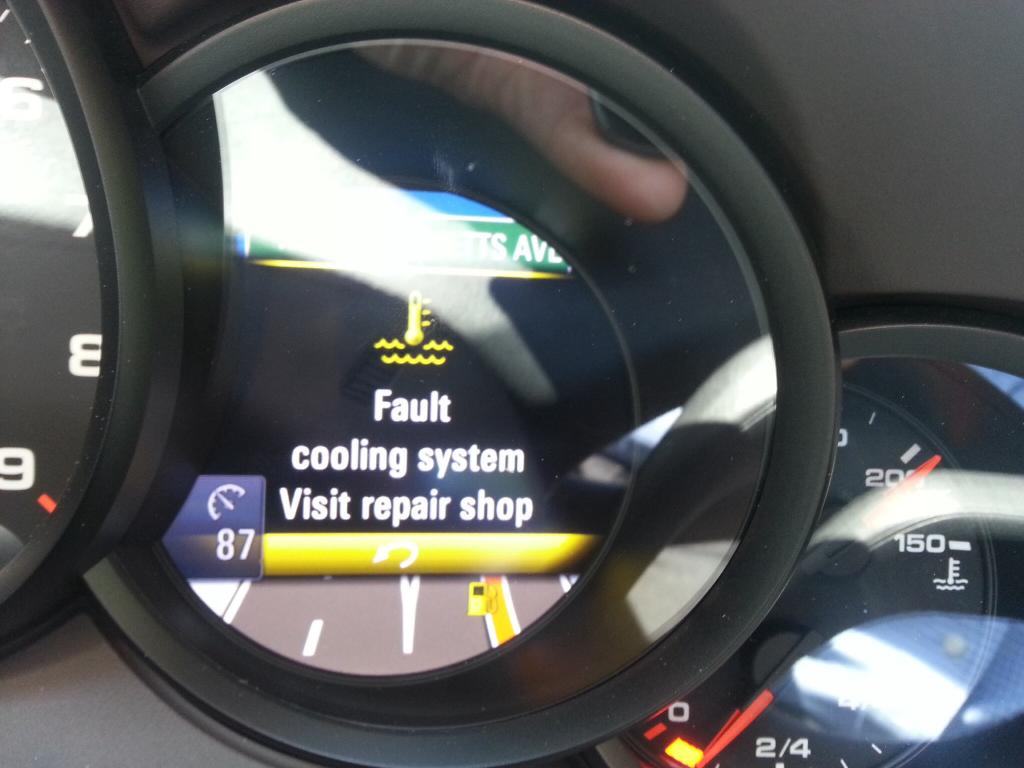

I had my car go over 194 a few days ago, the low coolant warning popped up. I drove home and added some coolant after it cooled off, thought that was the end of that. Started the car, same warning popped up and kept popping up. Took it to the dealer, they tell me it's one of the vacuum tubes that has gone bad and is tripping the sensor. They kept the car for a couple of days to figure out which one and replace it. Next time it happens to you have them check your tubes.

Originally Posted by wanderfalke
Do you think the car is actually overheating, or just incorrectly reporting overheating? My digital readout never moves from 194f. Are both the gauge and digital readout reporting the same temp.?
Yes it overheated. Both gauges showed, heat was radiating out and fans were going 30 minutes after while it was parked with car completely turned off
I guess next time I just let it go all the way with warning light (just like Brianja) so it actually throws the fault codes. Then get it addressed - makes sense what you guys are saying...vacuum tube or sensor ....may be..
If the temp sensor periodically malfunctions for whatever reason and sees the temp as higher than actual temp, both gauges will show the wrong temp. It will also tell the car to keep the fan running because it thinks the temp is higher than it actually is. Do you have coolant boiling over when this happened? I found my car is always hot when you walk around the back even with normal driving.

Here's the message I got. Again, the coolant was low but the message stayed even after I topped off the coolant. Dealer told me it was a bad vacuum tube, I wonder if he meant a change over valve. My car is still at the dealer, I'll update this thread when I get the paperwork with the details of what was done.
