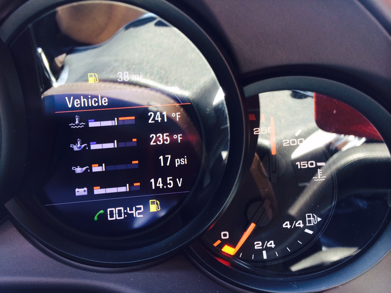

I have about 9K miles on my '13 C4S - I was driving back to work after running an errand and noticed more engine sound than normal while at the traffic light. When I checked the engine temperature, instead of 194F coolant it was over 240F (close to red zone, see picture). This happened once before but as I restarted the car, it went away, similar to yesterday.
I'm very worried about this intermittent heating issue.... what if I don't notice and engine breaks down or even catches fire!!!!!!!!!!!!!!
I have appointment on 6/2...I guess will find out more...
Anyone had similar issue??

You should worry because overheating can be extremely hazardous. Check your coolant, your radiators and your engine fan. If you have debris blocking your radiators they won't cool. Likewise, low coolant can cause temperatures to rise. If they both are fine, get to a dealership and have them troubleshoot the problem as you seriously don't want to overheat one of these.

It's all clean and the coolant levels are alright. The car is practically new.....I do understand that front radiator fans didn't go off when I had the issue for the first time...

When I had this issue for the first time, it was right after the first oil change on my way back from the dealership , I noticed strange (jet engine like) noise, noticed temp creeping up and called the dealership workshop manager immediately. They were closing their workshop, yet he stuck around for me to drive back, hooked it up to the computer (car had gone to normal temps) to look for the fault ...NOTHING!!! That was at around 3K miles... 6K miles later (at 9K) now this got repeated. I really hope it's a thermostat etc issue at they can fix quickly!!

I agree with Denversteve, Check the fans at the front radiators. May have junk, pebble etc sticking in fan preventing their operation
Seems to me that if the car is fine while moving and overheats when stopped, probably the fans or something blocking the radiators.

I'll check it again tomorrow when I wash it. Don't think there's anything blocking the fans as all the other times in last 16 months (also now ) it works fine with exception to these 2 incidences.

Weird! A friend of mine had an issue with a front radiator fan but he got an alert showing up in the instrument cluster.
Let's see what the dealership finds out...
PS: BTW, I noticed on your gauge pic that you had been on the phone for 42 minutes when the issue happened. Maybe the car felt jealous and wanted more of your attention

You're hitting the disaster alarm button for no reason, there Fester. 240F is not even close to max operating temp which is 150 C or 305 F. 991 engines are designed to be more thermally efficient as it helps with fuel mileage and emissions, so they will run higher operating temps than older generations models. What you are seeing is perfectly normal.

Haha...it's 42 seconds Serge and I guess it shows up every time I'm trying to use phone functions while it's connected to PCM via BT (like phone's Maps/Nav) ...not sure if this time it was just camera that caused it...my guess is "yes" but I will try again tomorrow to verify.
ok thanks for the info - yet, why would it get to even 241F is beyond me...I've thrashed it many times in sport+ consistently for 30 minutes or so, it never heats up to this level but driving around town in sport+ and not exceeding 5K rpm or so while shifting in manual puzzles me. There's definitely something not right IMHO....

That's normal temp range, you're not going to get anything from your dealer if you take it in but 'there is nothing wrong' so may as well save yourself the trouble. A vehicle is always going to get hotter driving around town (especially in traffic) because there is not as much air going through the radiators as if you're out somewhere driving aggressively. Don't worry, you're good to go unless you crest the 300 degree mark.

Not sure about your logic here ...the instrument panel doesn't even have 300F mark...it stops at 250F with redline/danger zone indication .

I think what Fester is saying is that something is abnormal. And, it sounds that way, Mine sticks around 194 when fully warmed up and it always stays that way. And, I live in Sunny Southern California. When he sees 240, he is seeing something that is abnormal and out of the range from what he is used to. I'd agree with him on why suddenly it would go to 240.

its not logic, its the factory spec on the car. Google it and you will discover the tech about the engine operating temps.
