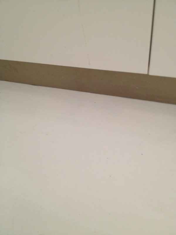

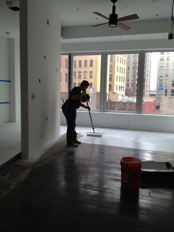

I wanted to chime in and add my 2cents.
I'm an architect and epoxied my living room floor.
If you want a concrete looking floor, you would first put a self-leveller, mixed with dur-a-tec bonding agent (so it won't crack) down over your structural concrete and then put a clear poly over it. That way the concrete finish is consistent and you won't see any aggregate.
If you wanted a solid color, roll a couple coats of epoxy before the poly. Look at decocrete.
With drying time it would take a minimum of four days, two days of application.
It's simple enough to do with a friend, a bucket, and a mixer.
Otherwise you can have your concrete sealed for a more industrial look.

Appreciate the feedback Moje, I've seen a few techniques that produce a granite / marble appearance, which would be my first preference. Are those hardwood floors you're epoxying over??
I guess my concern remains the 4 day timeline, as I'd need to find somewhere to keep the 991 out of the elements during that period.
