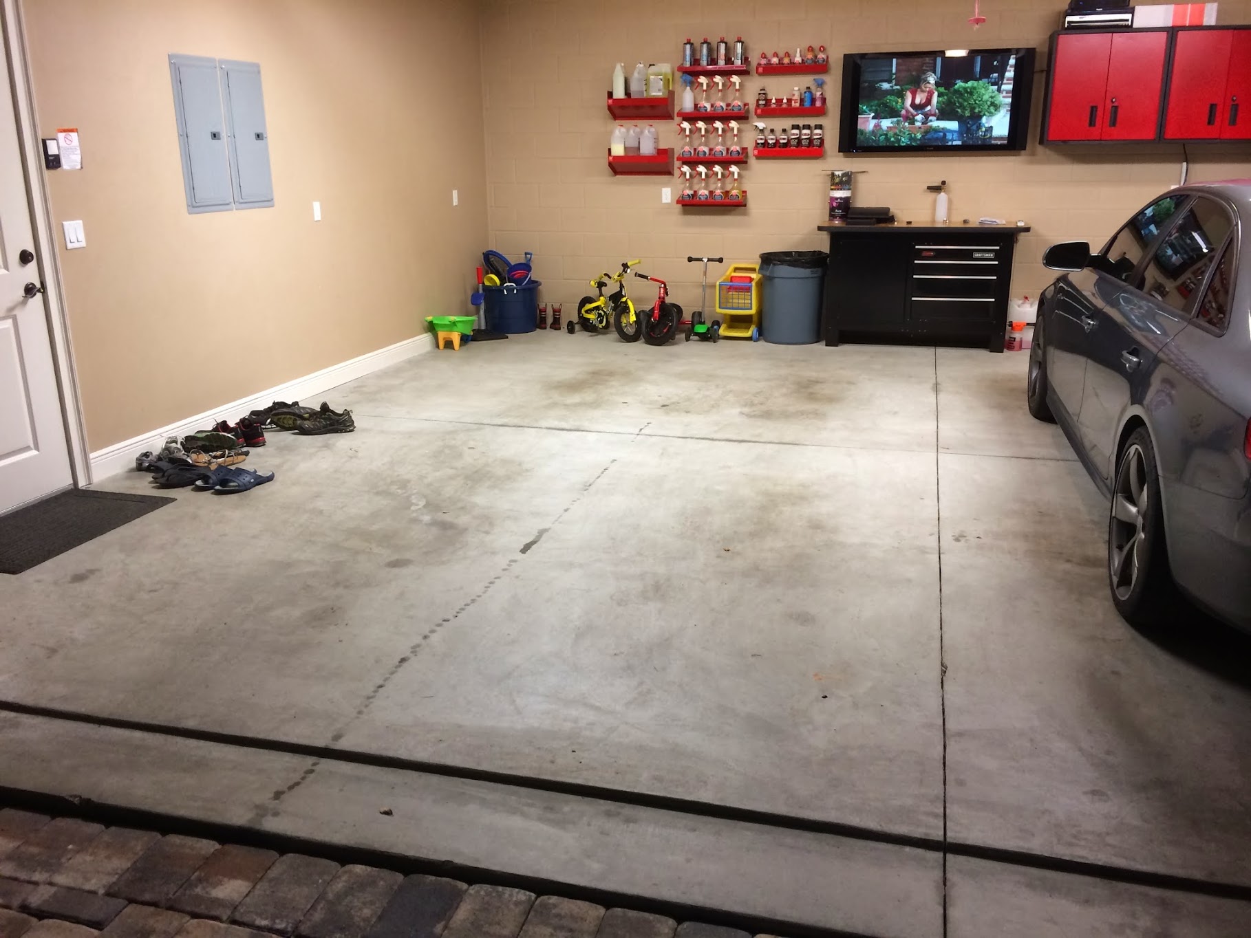

I've been going back and forth with what to do with my garage floor. I like the look of some epoxy coatings, and certain RaceDeck flooring options. The "runway" bay (where the boys seem to like to leave their muddy cleats and clothes) gets a lot of traffic, so I want something durable, yet "finished" looking.
While researching the epoxies I noticed a pretty broad range of options, prices, and project times. One professional quoted $3k (site unseen) for my double bay garage, and told me the process takes about 4 days start-to-finish. Assuming my car gets here this week, I really don't have 4 days to leave it outside for. Not to mention, I don't think there's any way to keep the family out of the garage that long. Other sites I have visited claim a "same day" process. Seems like a pretty big gap, and I assume there is some performance benefit to the elongated application?
On the RD flooring...I like the easy install, and the fact you can pretty much be done in a few hours. No chemicals, no waiting. I'd love to do a checkerboard in either Red / Black, White / Black, or UT Orange / White (she'll never let this one happen), but I'll probably end up with a more subtle Graphite / Black if I opt for the RD.
I realize this isn't specific to the 991, but wanted to stay "in community", as I have received a ton of great advice already. Thanks in advance for the feedback!

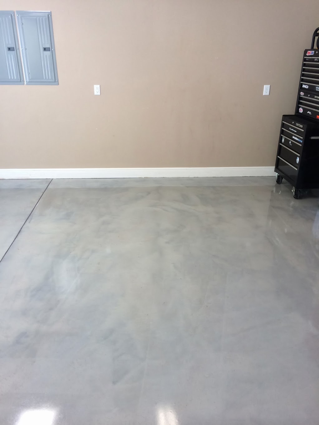

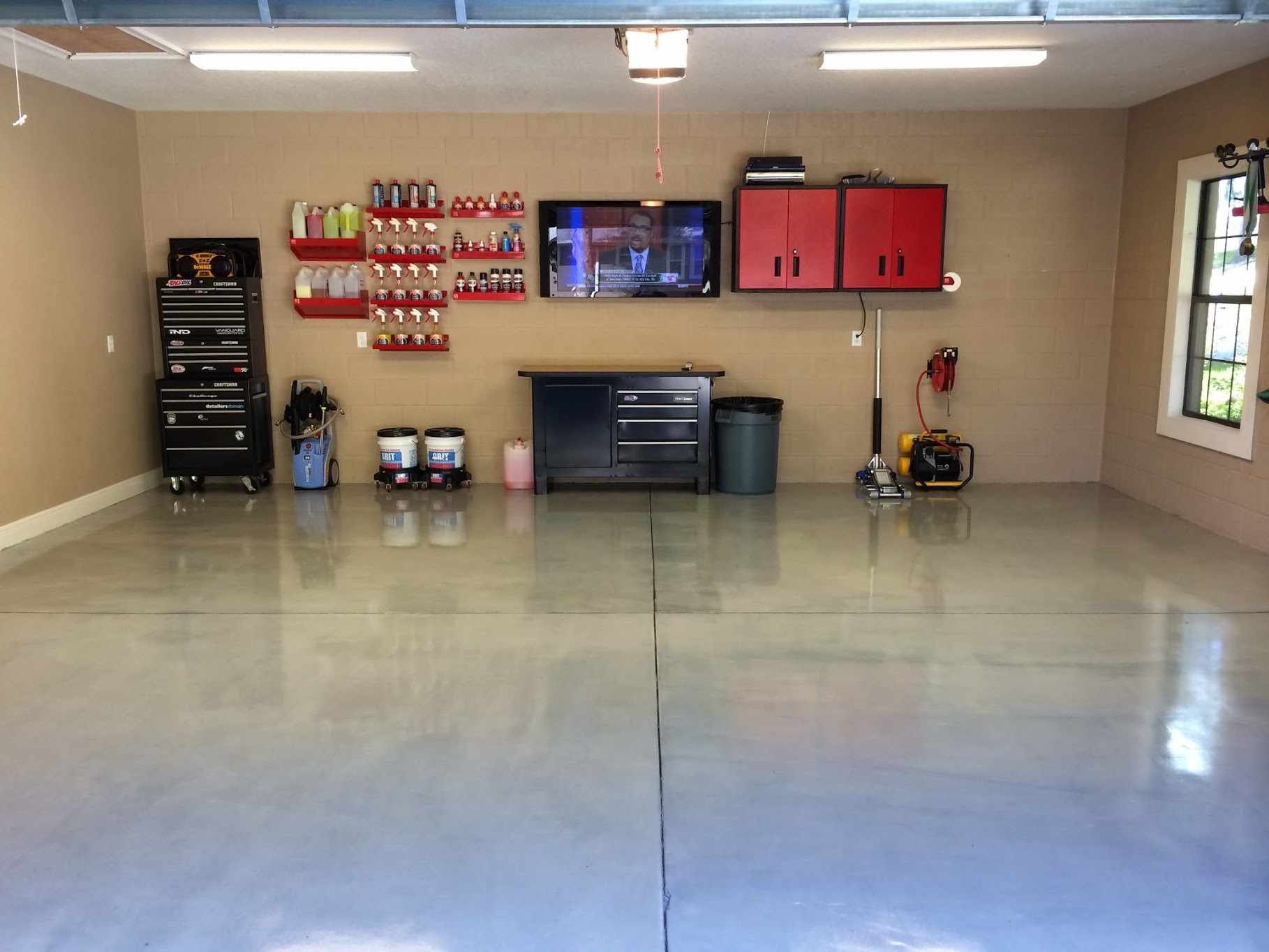

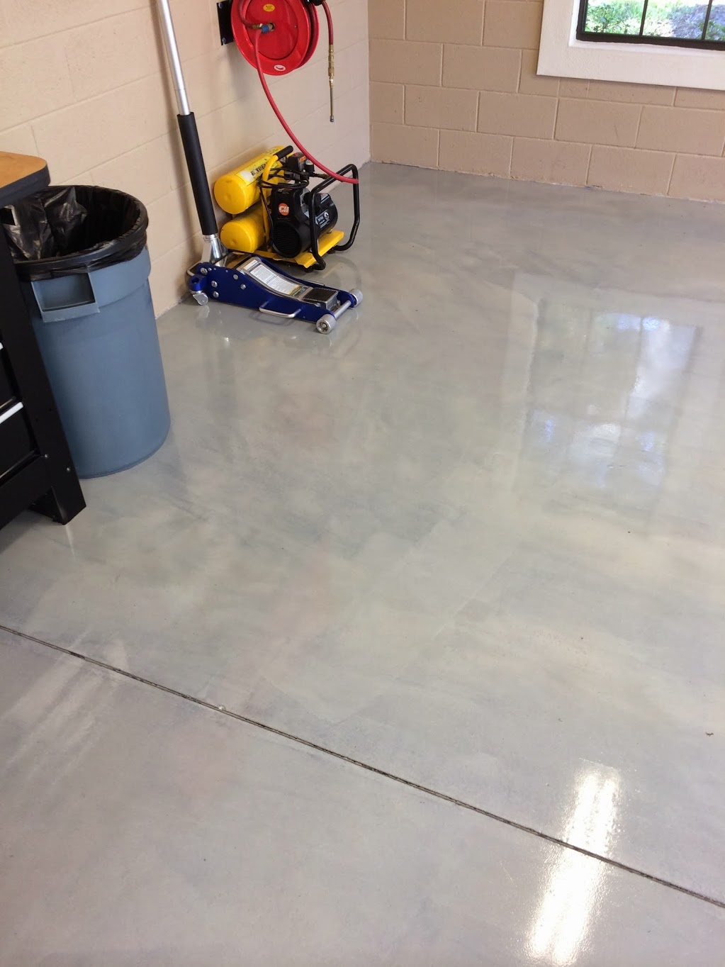

Where do I start? I really screwed this up, so I hope I can help you not make the same mistakes.
I wanted my floors to look like the ones in Home Depot. I posted on Garage Journal and asked how to get that done. Most everyone suggested I not due polished concrete. The problem with it is that it will still stain. Also, the big box stores have their floors touched up very often to not show wear.
I was recommended a local concrete company. He agreed that polished concrete wasn't the way to go and suggest we do a clear epoxy topped with a clear urethane. I thought that was a great idea. He said he couldn't do too much sanding to the get every last stain or blemish out as the sanding marks would show through the clear. When he rolled on the clear epoxy it turned the concrete to a super dark gray and amplified every last blemish. It looked terrible.
I hate the chip systems, or so I thought. It reminds me of my grandmother's garage. He suggested I pony up the extra cash and do a Metal Epoxy System. The clear and urethane was to cost $1,900. The metal system would cost $3,800. I decided to do it. It is supposed to look like Aluminum. It took about 4 hours worth of work and probably about $500 worth of product.
The result is that I hate it more than anything on the planet. It is super slippery. I now know why everyone uses the chip systems. I can see every roller mark and blemish. What a waste of money!
It looks great in pictures but not in person.
The chip systems are easier, can be done in a day or two and hide all of the roller marks and blemishes. I'm going to have premier garage do it again.

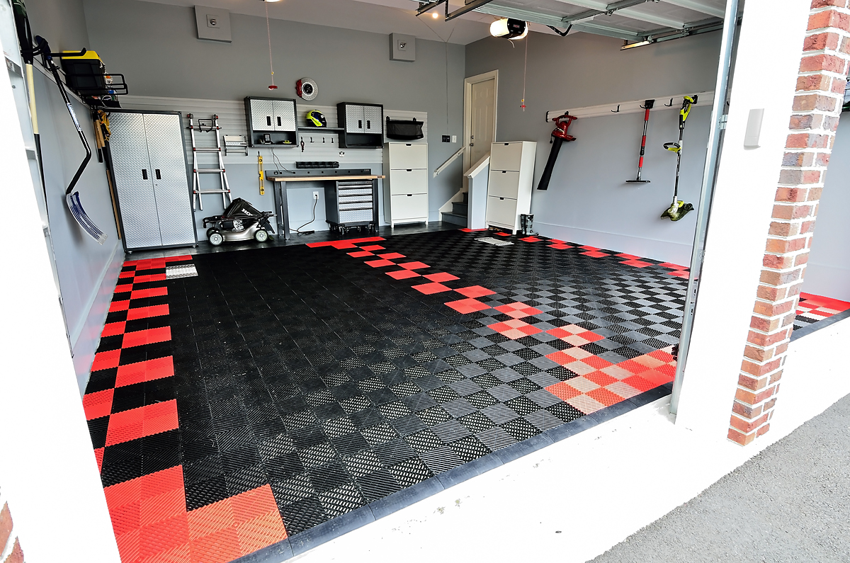

Six years, six cars and two houses later, my RaceDeck floor is still looking and functioning like the day it went in!
For an existing garage setup, it is easy, cost effective and attractive.

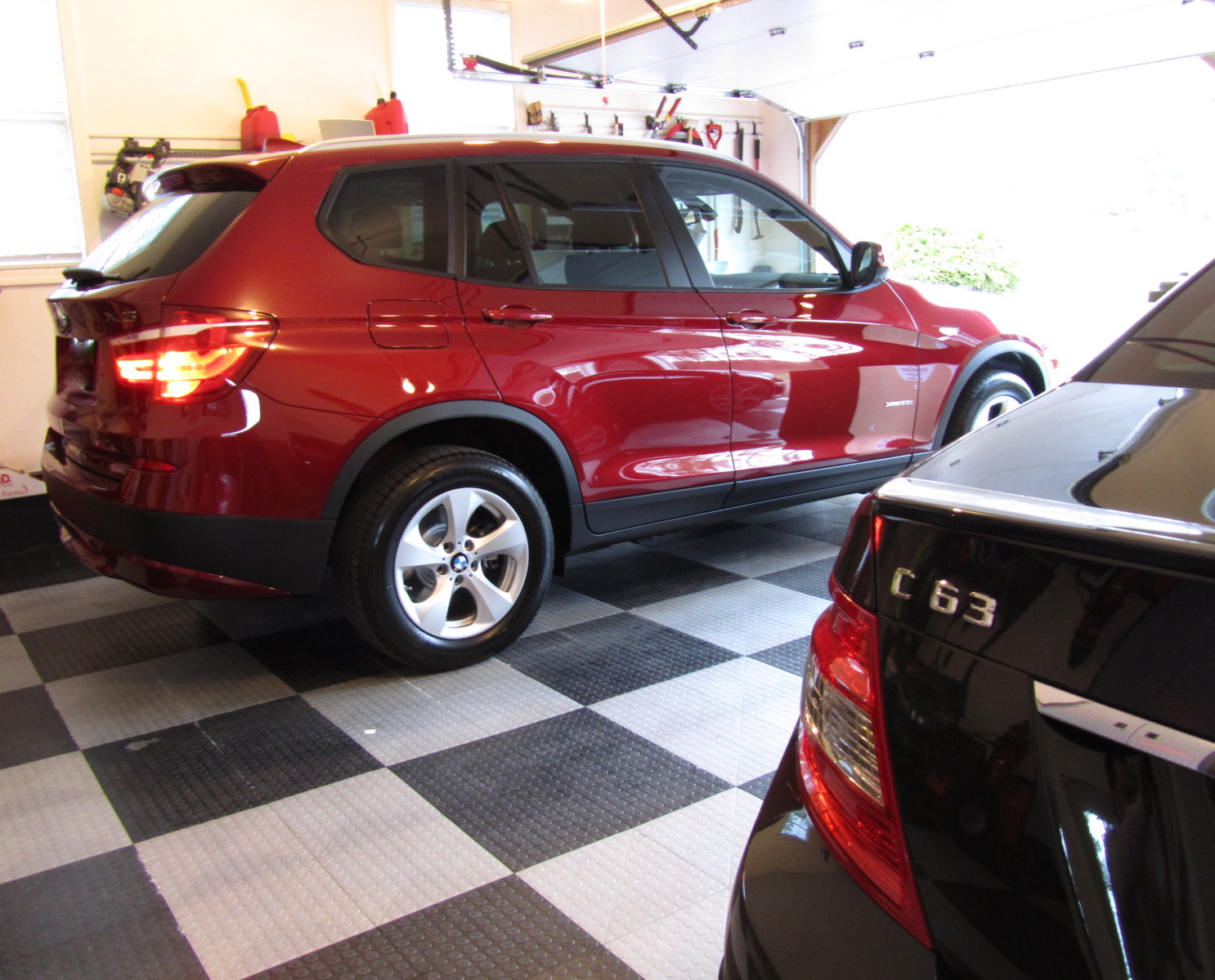

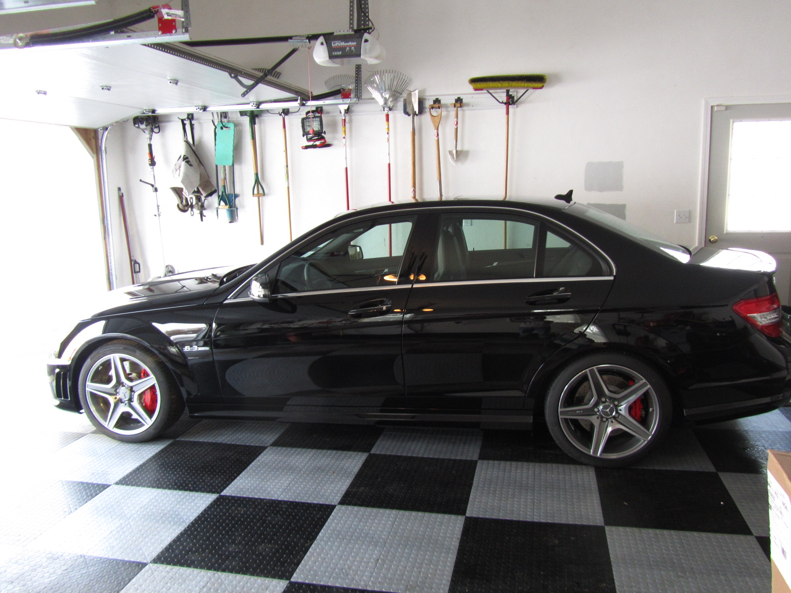

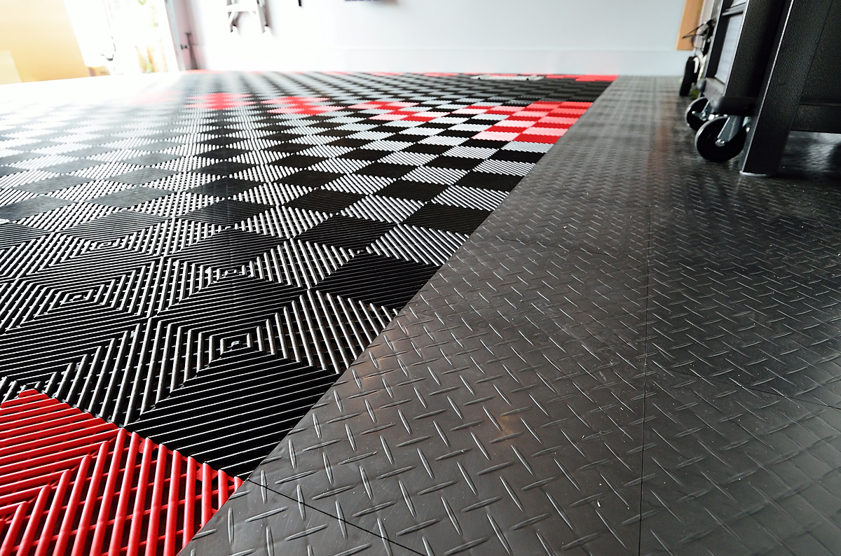

The paint systems will all show more wear over time than tile or race deck. We went race deck 5 years ago and it looks absolutely great today.
Race deck or tile gives the longest lasting most consistent looking surface. Race deck is now available with rubber isolators underneath that remove that hollow sound when walking on the surface.
With race deck or tile everyone initially thinks black and white checkered. We went with silver and dark gray with a red border. The silver and dark gray don't show the sand and dirt as badly as white and black would. Surface sweeps easily enough with a shop broom and can be vacuumed, swiffered, or mopped. When putting down the race deck floor buy some powdered insecticide and spread it lightly as you install the floor - we had ants try to move in under one section and ended up pulling a section of the floor up and spreading insecticide before putting the floor back down.
Race deck is a great choice for a garage where you store cars and do light to medium mechanical work. A section of 3/4" plywood should be used under any jacks or jack stands to spread the load. The tile must be protected if you are doing any welding or serious torch work.

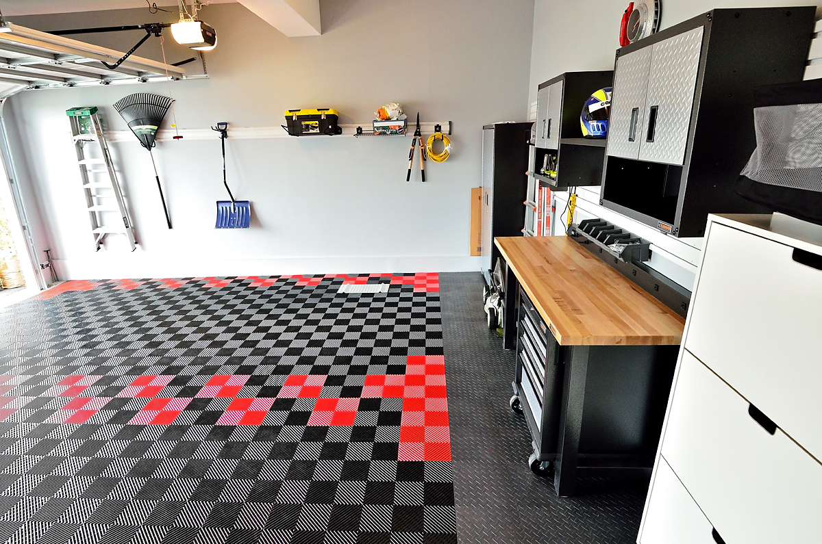

I have RaceDeck for about a year now, and both me & my family love it. I opted for the Freeflow version for the majority of the garage due to the fact (and recommendation from RaceDeck) that I live in the snow band. After this past winter, I could tell you I just love it! The water, sand, mud, salt, just fall under the tile and your garage floor will always keep dry & clean. A couple weeks ago, I just hose down the floor and wash out most of the sand/mud that are trapped underneath the tile. And I'm planning to "wash/rinse" the car during the upcoming winter months when it's too cold outside.

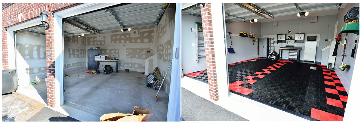

What a night and day difference! I think based on my area I'm going to need to go the tile route regardless. I probably should have guessed this with the cupping of my HW floors in the formal areas; I'll be redoing this with bamboo in the weeks to come. Is shipping on the RD tile expensive? I assume, based on weight, it has to be close to the cost per sq. ft.?
