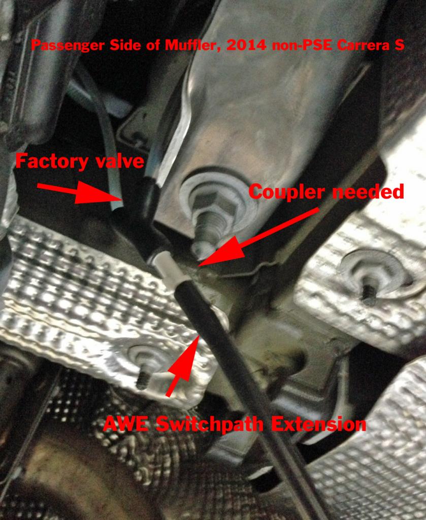

Installed the AWE Switchpath today
I see reference in this thread (and PM's) that perhaps I didn't install this system correctly, or that I misrouted lines or I have defective factory parts on my car (2014 Carrera S Cab with 1,200 miles on it), because I find the AWE Switchpath too loud for my tastes. I believe it was installed correctly and that my car has no defective factory parts. I know my way around a toolbox pretty well, and worked as a professional mechanic for several years in the motorcycle industry. Putting a new Automatic Transmission in my Daughter's BMW 323i was a lot more challenging than doing a simple pipe install on a Porsche. I have a loaded Snap-On box in my garage and recently restored this rare Moto Guzzi Daytona 'barn find' motorcycle to its former glory.
Also attached is a photo of the factory passenger side valving on my car, with the additional coupler that I needed to hook up the AWE kit. I took this shot this morning as I was removing the pipe. As you can see, the additional coupler is required for the line extension so I continue to believe that (2) line couplers should be included in the kit.
I think all the videos I've seen for the AWE Switchpath have been done in Coupes, and mine is a convertible - I believe that might be a factor in the loudness levels. With the top down on the car, the sound wicks right into the interior quite dramatically, perhaps the coupes not so much. I did put the top up on my car and rear windows rolled up during the tests and it cut down the loudness considerably - could be the convertibles just need a quieter unit.
The AWE unit is basically a conjoined straight pipe coming off the cats and running through a blocking switch valve that goes to the inside mufflers on each side. When I look at units from Capristo and Akropovic, they have kept a center muffler (of their own design) so I think that's a key in keeping the tone to a lower level. I'd like to see the guys at AWE Tuning develop a center muffler system for us Porsche owners that want something more than stock, but less than what the Switchpath system delivers.

Duane,
First, I just want to make sure you know we’re not trying to be confrontational here. Since our SwitchPath exhaust flows through the stock side mufflers when the valves are closed at part throttle, the sound volume should in no way be “straight pipe loud” or like a loud subwoofer if everything is functioning properly. That’s the beauty of our system.
So, the fact that yours was so loud when it should not have been caused us to scramble the R&D team here to get to the bottom of this.
In the end, this is a case where we needed to make our instructions more clear. We ultimately found that we have some of the wording backwards in Step 2 for Non-PSE install.
It should have read this way:
So, it seems that you left the elbow in place on the driver side, and used the coupler we supplied to attach the hose to it.
With that extra elbow and coupler in line, this is probably what happened:
Anyway, our SINCERE apologies for this error in our manual. Let’s discuss with TAG Motorsports a suitable solution with your return of the system.
It’s a shame we could not have worked with you to discover this error on the car, before the exhaust was removed! You really would have heard that the exhaust is very similar to factory when you want it to be, and nice and aggressive when you call for it.
- Insert the supplied hose coupler in the end of the factory passenger side tee fitting, at Arrow A in Figure 1.
- Attach one of the supplied 10.5” long hoses to the end of this coupler, at Arrow B.
- Remove the driver side factory valve hose elbow from the hard line and install the other 10.5” long hose, at Arrow C, to hard line outlet.
- The coupler you bought could have had too small of our internal diameter, affecting the vacuum flow to the passenger side valve.
- The coupler you bought could have deformed/melted from heat, affecting the vacuum flow (we use a high-temp spec with the ones we supply).
- The coupler we supplied but was installed on the driver side elbow, could have forced the elbow to flex straight, restricting flow to the driver side valve.
- The extra length of the line installed on the driver side, due to the elbow and coupler that were in there, could have allowed the line to pinch when installed.

One of the problems with the non PSE Carrera S is that bizarrely, the valves are open under 5 mph. As soon as you go over that they shut, until 3300rpm or so. But, it means at idle they are full open.
My first C2S did this (with the Cargraphics X pipe) and was kind of annoying - you can get the PSE button and software to fix this (no additional vacuum hardware needed, just coding and the switch)
PSE remains shut at idle and only automatically opens at 3300 rpm or so, or when you hit the button.
I'll be honest - I find the AWE to be on the border of too loud as well. I can switch it off with PSE, and I love the sound but it is pretty aggressive.
