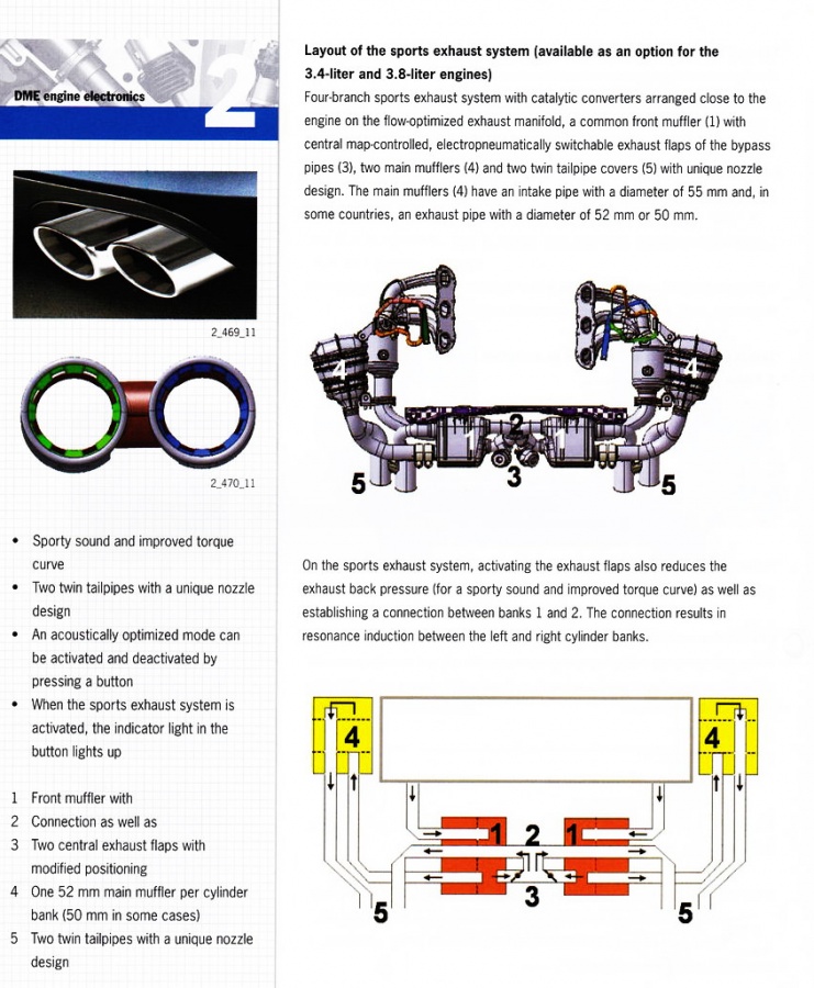

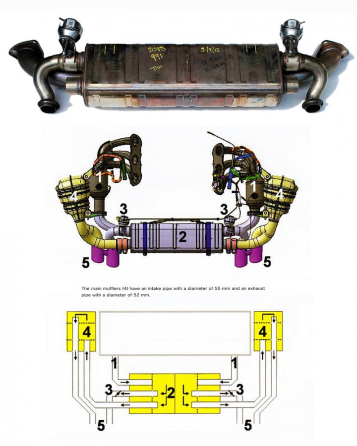

Originally Posted by beemer guy
Thanks for the info. So, I got PSE for free, except that it's up to the car to decide when it works, not me?
No, the exhausts are different. One of the attached images is PSE, the other isn't.
Name:	991 C2S stock PSE exhaust.jpg
ID:	383152   Click image for larger version
Name:	! 991 exhaust diagram.jpg
