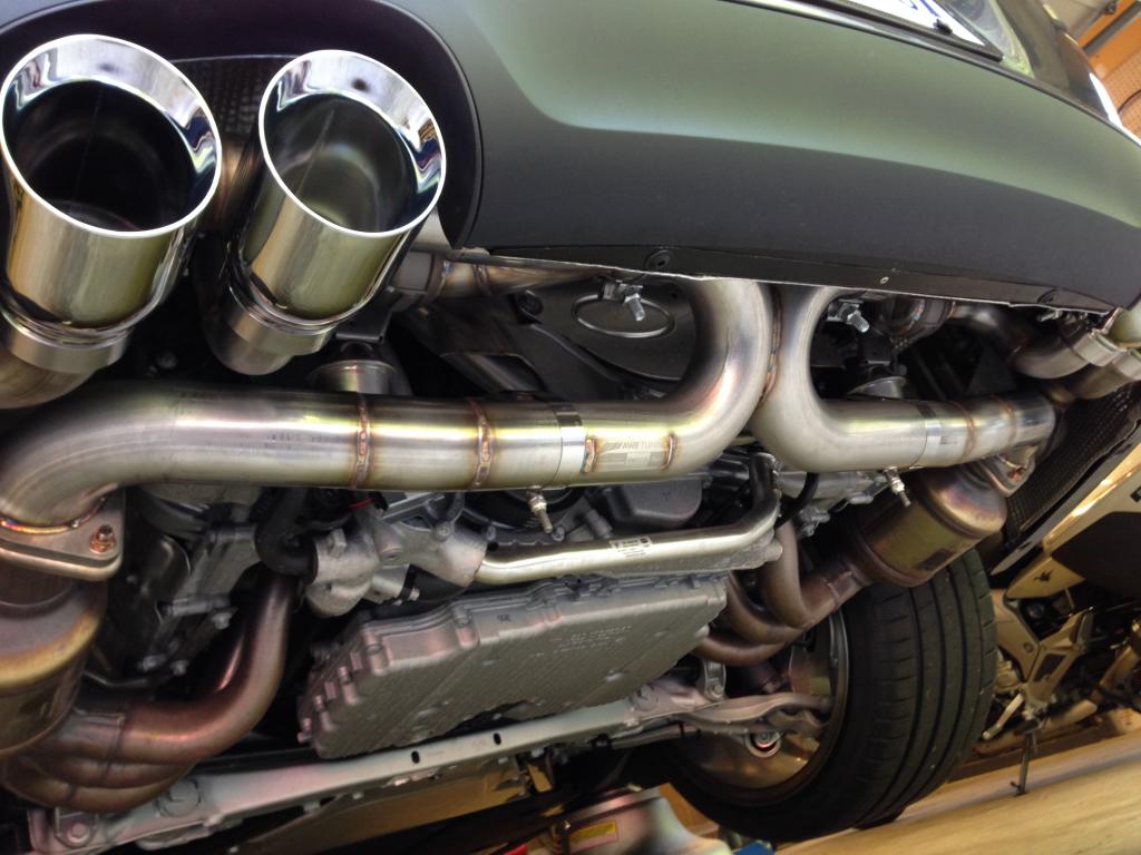

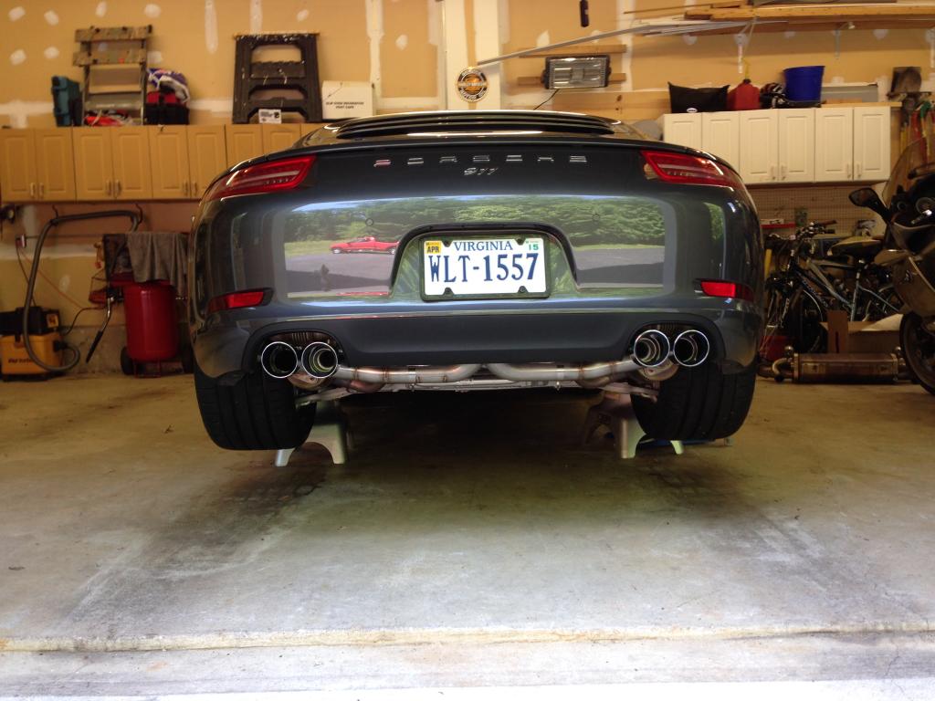

Installed the AWE Switchpath today
This is a very easy install, all you need is some basic hand tools and to jack the back of the car up. I've had motorcycle exhausts harder to do that this and it was only 90 minutes work, start to finish (most of that time was spend fussing about on the tip alignments). Rear bumper cover does not need to come off, but you will need a female TORX socket, a hex head socket, a long 3/8" extension and a short 'wobble' extension to do the work in addition to standard metric sockets.
It's a well made pipe and fitment is excellent. Welds are all good. The kit they send is not quite ready to install on 2014 991 S. You will need to supplement the kit by having a 1/8" to 1/8" vacuum hose coupler to supplement the one they do supply. On the 2014's two are required and they only send one. Its a $ 2 part, just have one handy.
The pipe is louder than I expected This is far and above the PSE exhaust and I have to try it out a few days to see if its going to be acceptable. You can keep it fairly civil at low revs but once you hit the gas the valves open up and its a screamer. It will draw attention in full song, that's for sure. If it was 20% softer in tone it would be perfect for me. Doubt I will go back to the stock pipes, but I may try to baffle this one down a bit .... we will see!

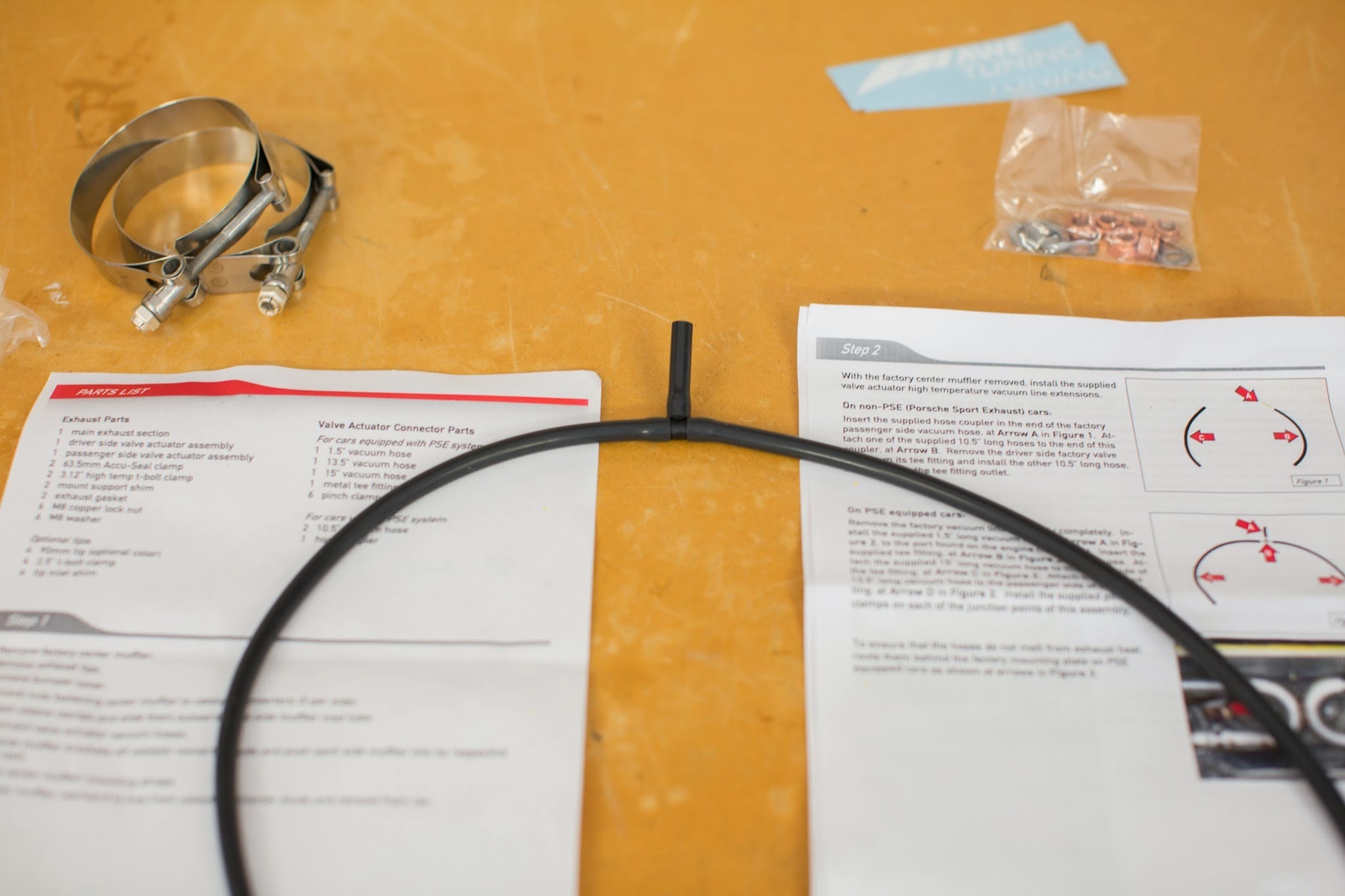

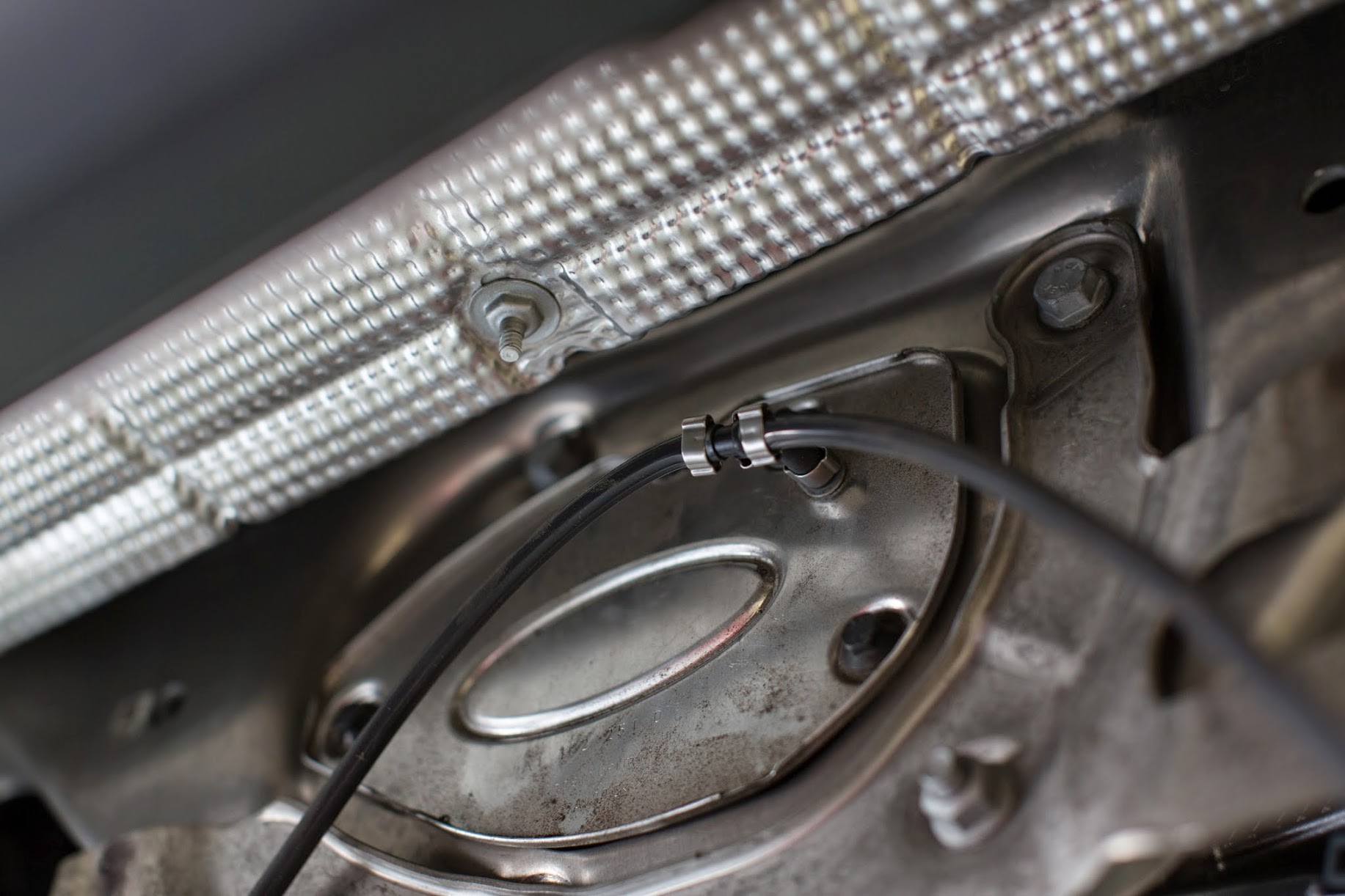

No "squirrel farts" once you install one of these! It roars... I don't have the PSE, but the stock exhaust still have the vacuum valves that actuate, just done automatically by pressure instead of having a switch control. I know that if I find it too loud, I can simply go in there and plug off the valve actuator on the AWE Switchpath with a simple rubber plug (5 minutes) and keep them closed.
Zack, on the 2014 S 991, the one coupler they include with the kit goes on the driver's side, but they need to include a second one for the passenger side setup, as there is no 'T-junction to tie into as per their directions, a coupler is mandatory to hook it up. Perhaps they changed the design at Porsche for 2014? Not a big deal as a coupler is $ 2 at the auto parts store - it just saves the hassle of having to hike out for one.
My 2014 looked the same as the directions.

I believe I was sent the right unit (Non-PSE) but I needed an additional in-line vacuum coupler for each side to connect the hoses, There was only one in the cello-wrap, and no other connection parts (such at a T-Connector). The instruction print-out diagram would not work on my car regarding the line hookup. Like I said though, a very simple fix, I just required a second coupler and they are readily available at any auto parts store.
Ah, that makes sense. Mine came with these parts. It sounds like you indeed did get non-PSE version.
