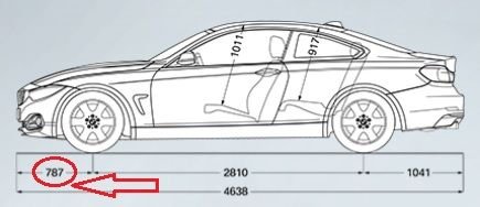

Hello all.
It is my first post however I have been reading it for a lot of time. Great forum.
Can you help me and tell me the lenght between the front wheels and the front bumper (standard and sport design) on the 991 C4S? The picture is an example from a BMW 4!
Also could you tell me the ground clearance of the standard front bumper and the sport design one for the C4S?
I am trying to evaluate the angle of slope in this car because I have a steep garage entrance.
Thank you and best regards.

I have a steep curb and take it at an angle with my C4S with standard bumper. I also did a not overly scientific measurement in my garage of the distance you specify and got 37" or 94cm. The ground clearance of the bumper is about 6.5" or 16.5cm. Remember also, the underside of the bumper is black plastic which is designed to wear away and may be replaced if desired without replacing the entire bumper.
