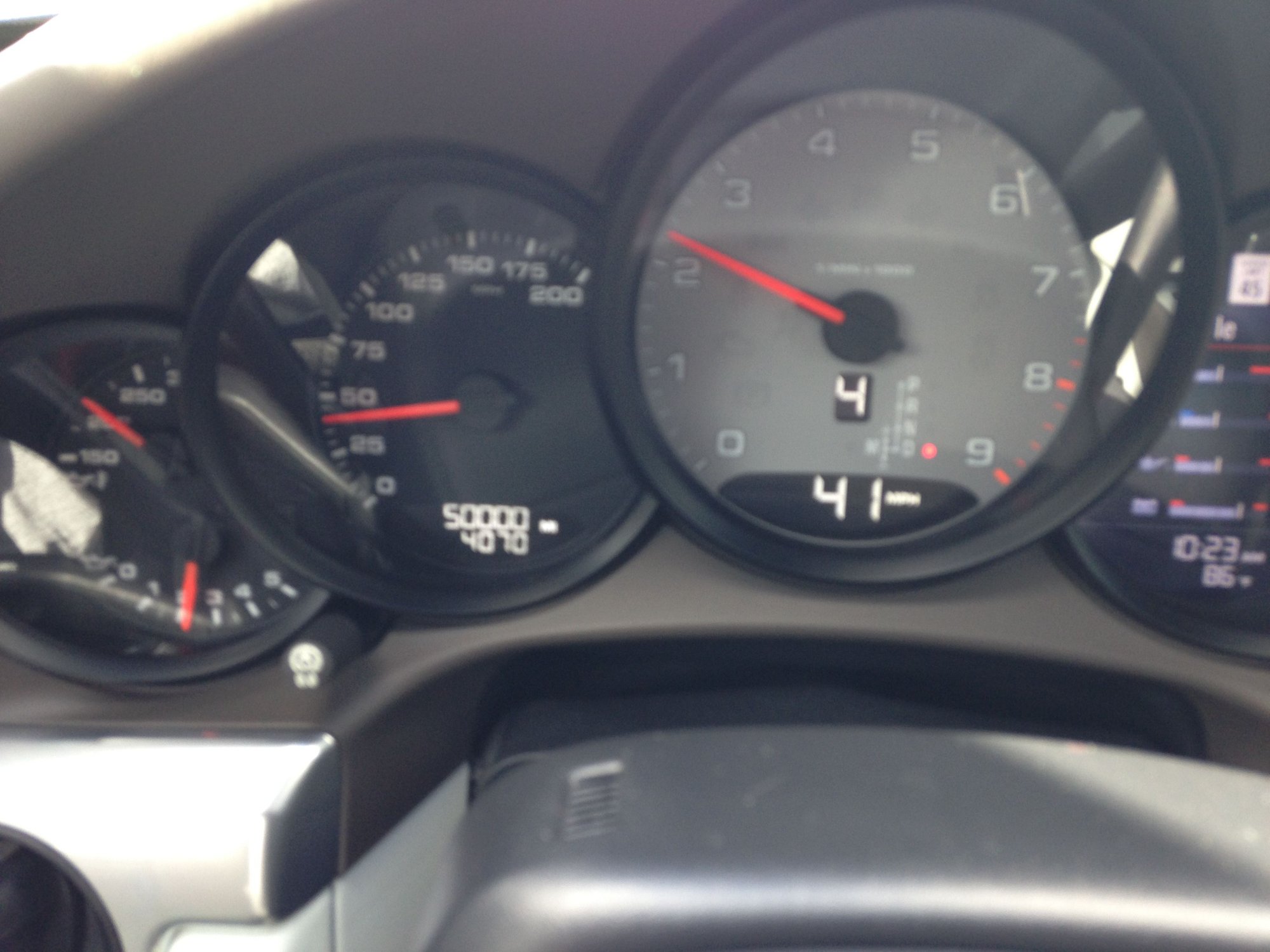

So, what's been happening? While traveling through the mtns of North Carolina with Navi on leading home to Florida, the PCM would continuously reset! Never had this issue previously. Even while taking off again from a Georgia has stop, the navi finally came on and was about 100ft off target. It thought we were still at the station, and again would keep resetting, starting up with us at the station even though we were far from it. Each time, I would turn the car off/on to no avail. I had to just turn the navi off to keep it from blanking and restarting.
Believe it or not I completely forgot about this issue when I took the car in for my free 50k oil change, thank you PCNA! When leaving, I called the wife via Bluetooth, about 3 min into the conversation, the PCM rebooted again. The call was still connected. When it finally settled, down the phone call was still connected and our talk continued for about 30 sec or so as I complained about the issue. This resetting happened three times before I ended the call. Anyway, I have an appt set for Monday for the dealership to look into this. They say there is a software update (as I've seen on this forum), but they don't have it yet... We'll see. I'm thinking it's hardware as I've never had the problem for the last 30months.
Here's the funny part, sitting at 49600 miles, I had a track day at Sebring set up. 100 miles or so there, the same back, leaves me enough for three sessions or so before the warranty is over. Well, near the end of the second session, the low fuel light comes on, yet the gauge says half full. Day over and headed home. Another thing for them to look at!!
