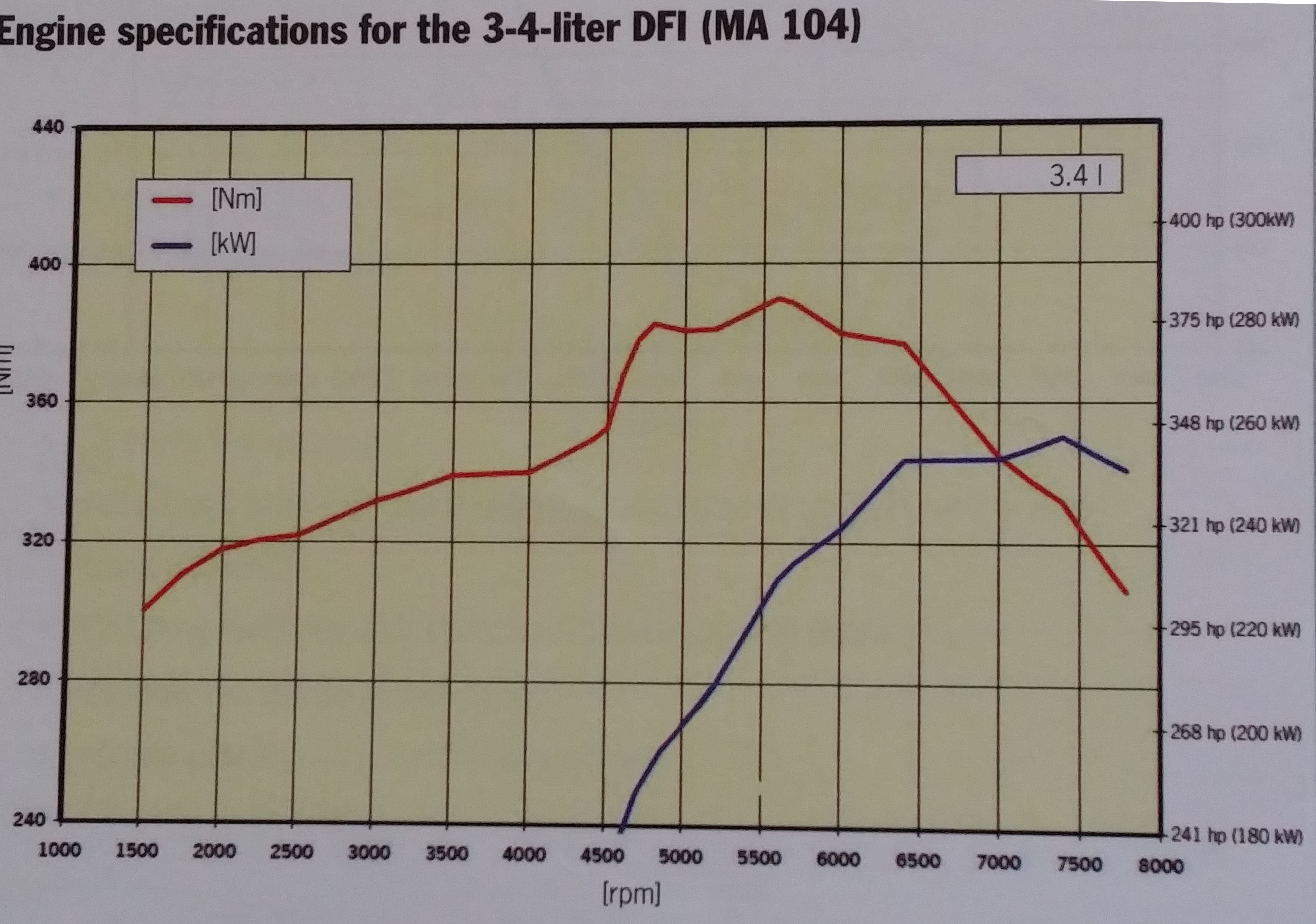

That's what I call mini-launch control. In launch control the RPMs go to the 6000 area. It does slip the clutch just like in launch control and I'm assuming the reason they do it is to get on the torque and HP curves. You don't quite get the power of launch control, but it does the job just fine.
The power curve indicates that after it shifts into 2nd, RPMs should be at 6400 or above to be on the peak of the HP curve (6400-7500).
ChuckJ
