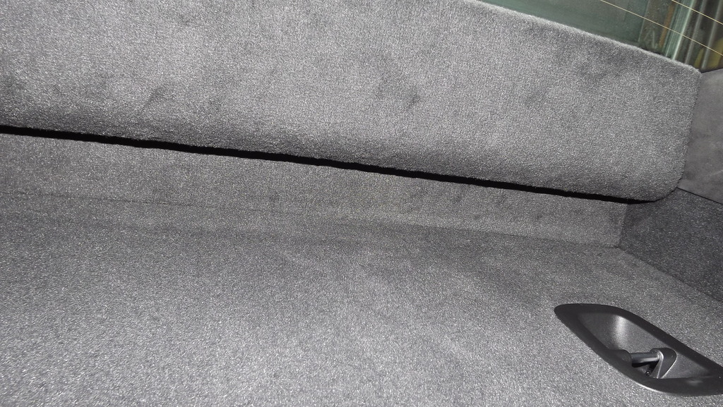

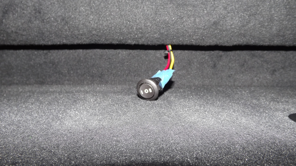

So I put the 3rd brake light modulator on my new GTS. All the wiring and everything is the same, however did find a better and more inconspicuous place to place the switch. Instead of placing it behind the driver side passenger seat, (see last picture in post 2) I hid it behind the rear window trim piece. The piece has "handholds" to pull the trim out and I tucked the switch right inside the handholds. All you need to do is pull it out when you need it, and tuck it in when you don't. No one knows the switch is there but you!
