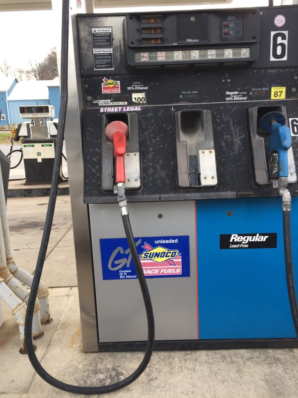

I've used Sonoco 260 GT Unleaded 100 octane.
Look up Sonoco to see where your nearest dealer is. Unfortunately you might have to buy 5 gallon pails. The place I found has the one I listed above on a pump thank goodness. It has ethanol and they are allowed to have it on a pump in my great "ethanol mandated" part of the state.
The difference is very noticeable! The car sprints, way more responsive, and takes off like a rocket. I plan on getting it whenever I can even though it's like a 30-40 min drive from my house.
Haven't priced it since last fall, since the car is in winter storage. Was over $7.00 a gallon last time I filled up.
