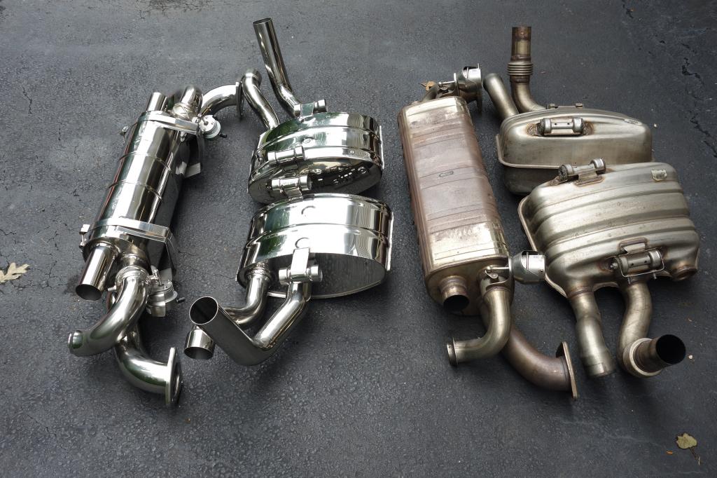

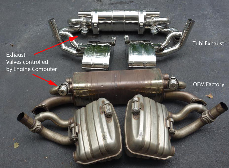

Lots of choices out there, John.
The AWE Switchpath is plenty loud, if you want to make noise that will do the job and it has decent workmanship on it, but not at the level of the pricer pipes. The valves are open at idle, close when you drive off and then re-open at 3,600 to 3,700 rpm. That's done to give you some peace when driving moderately and talking on the phone or listening to the radio. I found the AWE too loud and returned mine in favor of a Tubi exhaust ( $ 4,500) which replaces the pair of side mufflers as well as a center muffle. Its perfect for me - reasonable tone at low rpms and it rips when the revs go past 3,700. Everyone has different sound levels they want, you'll have to explore them all. For me, I don't like drone at highway speeds or draw attention as a street racer, so it was either Akropovic ($ 9K) or the Tubi.
The less costly pipes such as AWE are replacing just the center muffler, they leave the factory side mufflers in place. These are commonly referred to as "X-Pipes" and there are a number of makers of them.
AWE comes with a Satisfaction guarantee so you can try it to see if you like it, and return it if you don't. They told me at AWE I was the only return they ever had on one, so that means most do like it.

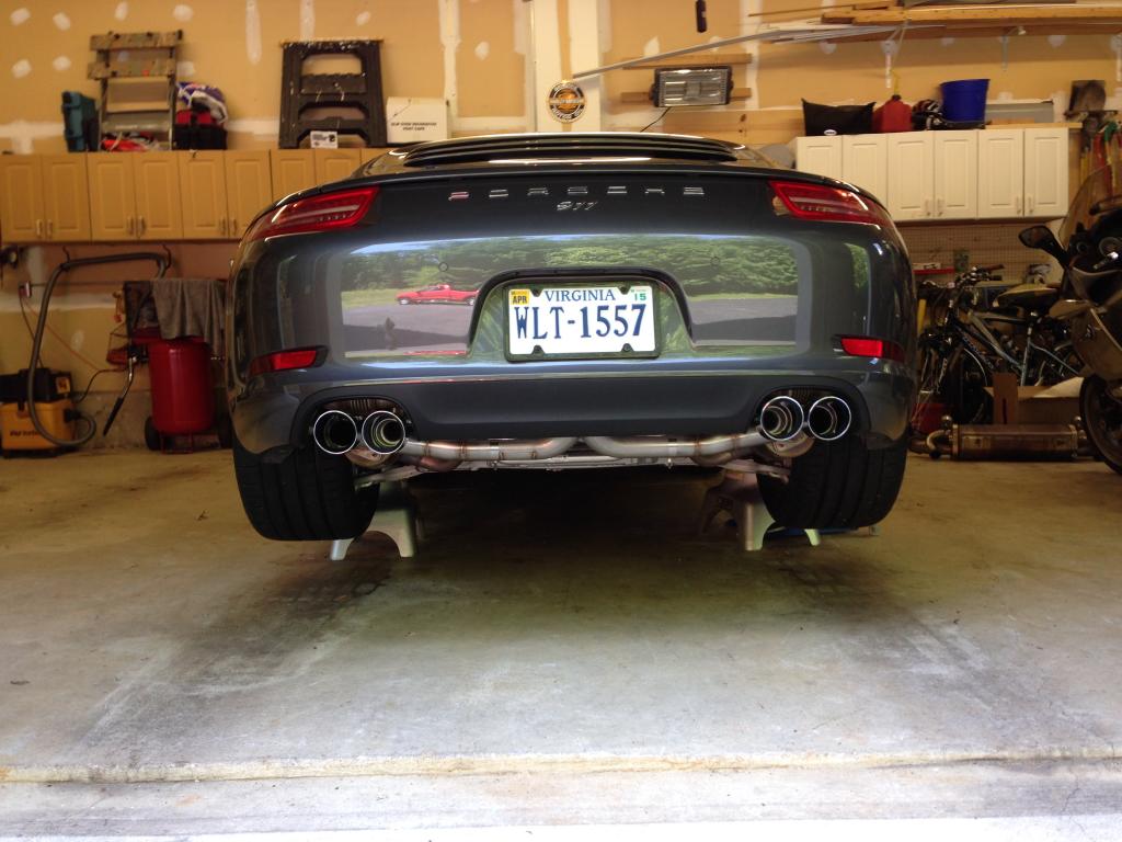

AWE Switchpath on my car for 1 day:
