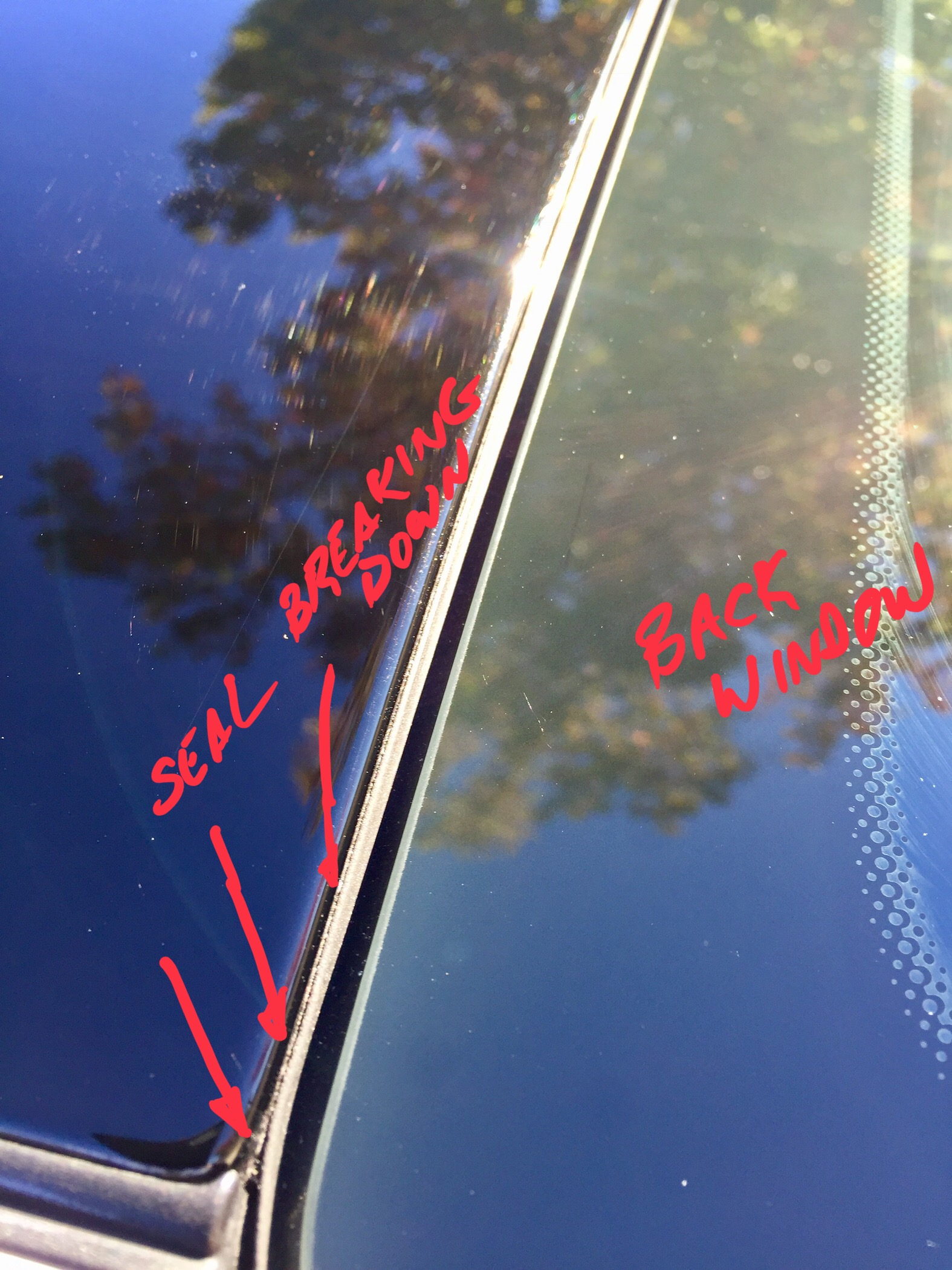

I pursched a 2013 Carrera S back in April and I also have this black substance, most noticable around the back window.
The car was from TX and I have to imagine it was garaged since the paint and interior look virtually new (it has 40k miles).
I never thought this was an issue - but I should bring it up.
It's at the dealer now due to an airbag light coming on that they traced to a leak in the windshield. If it's an original windshield it should be covered (the repair of airbag light). If the previous owner had the windshield replaced by somewhere other than a Porsche dealer, I may be screwed.

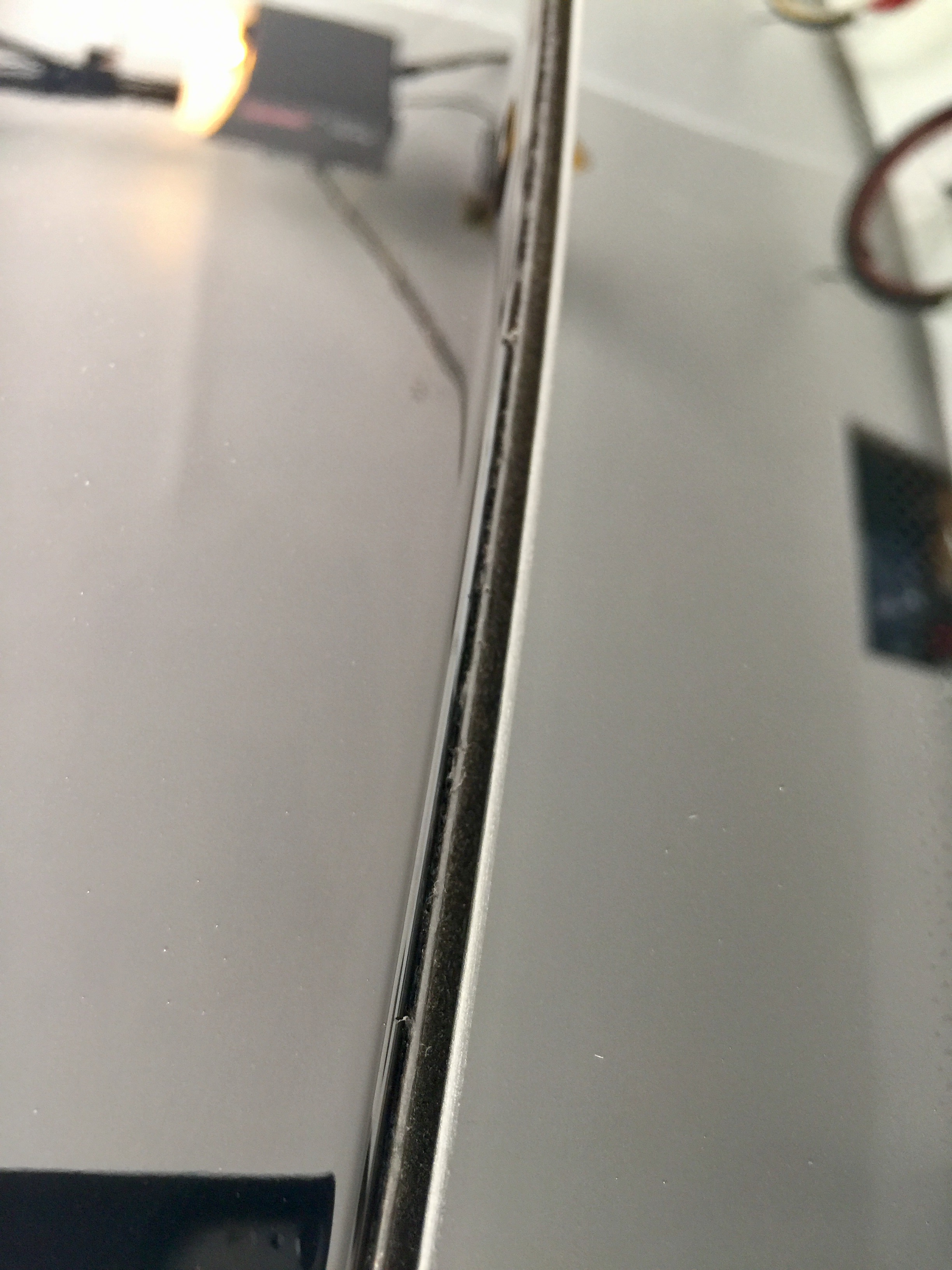

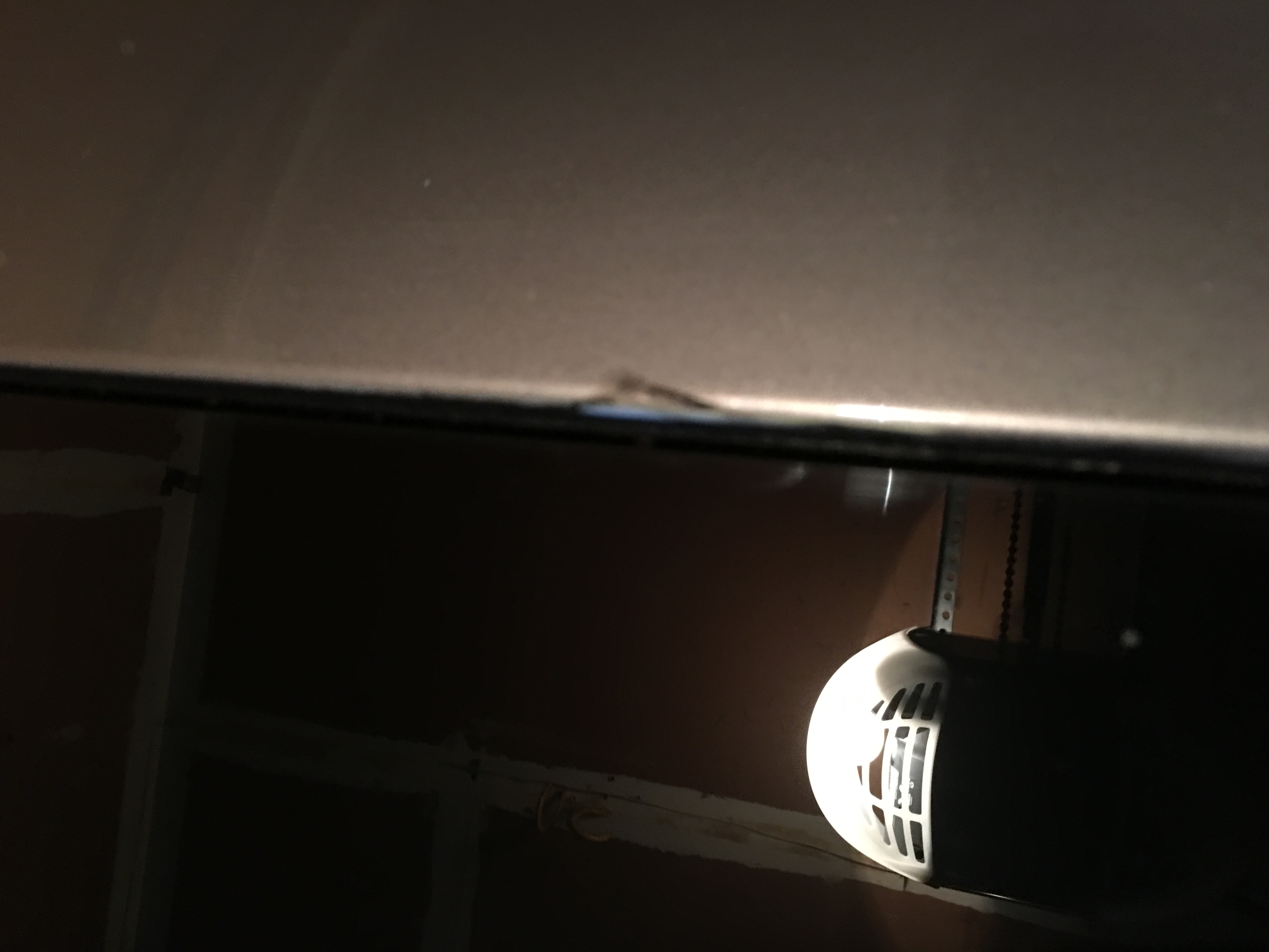

Defective Weather Seal
Originally Posted by Skyfire
Thanks for your reply. Does it mean they put too much adhesive? Is it from the Porsche rep?
My 2014 50th Anniversary car had the same issue. I drove it to the dealership and was informed the weather seal (rubber) was breaking down. I was asked what product I used to wash my vehicle. I answered his question and have not used the popular car wash soap since then. My windshield, rear window and weather seals around the perimeter of the glass were replaced with Porsche products covered under warranty. I also contacted PCNA when my local dealership failed to return my calls. The rep from PCNA also informed me Porsche did not have a recall on this issue, and this occurrence has been addressed by other Porsche owners.
In my experience it was not due to excessive adhesive, but the actual weather seal that was breaking down. The seal had the consistency of sticky gum. What is also interesting is the low mileage, (approximately 4K) on my car when I noticed the problem. My car is always parked in the garage and/or covered. I suspected it was not due to my washing and detailing products, but a manufacturer defect. Porsche honored the warranty November of 2016 and to this day all is well.

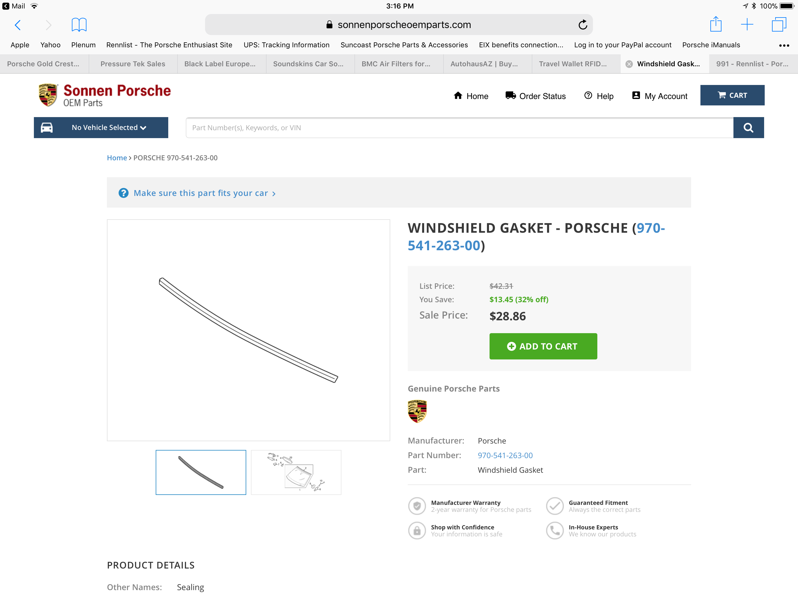

I disagree with their response.
When my windshield and rear window were replaced my work order sheet had three specific items.
1: Windshield
2: Rear Window
3: Adhesive Kit: This includes a number of parts. This included the rubber gasket or weather seal that sits on the top edge of the glass.
