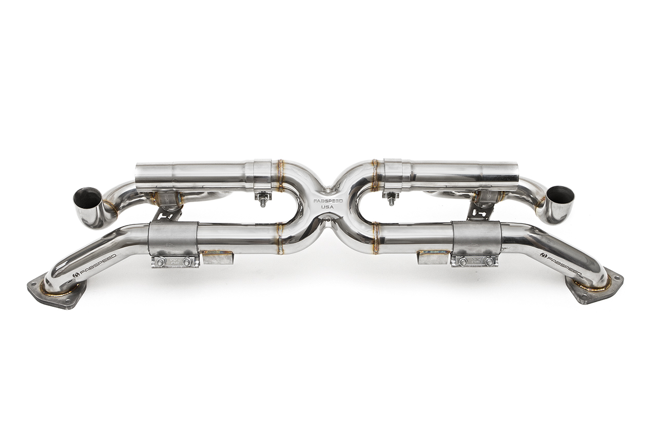

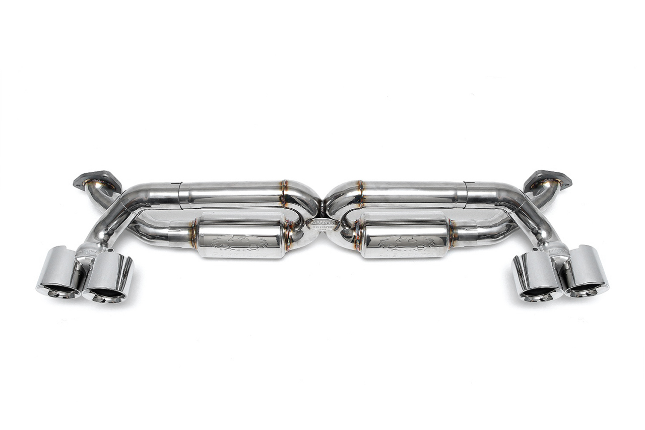

Fabspeed Motorsport's Avatar
Posts: 3,894
From: Fort Washington, PA
Fabspeed Motorsport Is a GOD !Fabspeed Motorsport Is a GOD !Fabspeed Motorsport Is a GOD !Fabspeed Motorsport Is a GOD !Fabspeed Motorsport Is a GOD !Fabspeed Motorsport Is a GOD !Fabspeed Motorsport Is a GOD !Fabspeed Motorsport Is a GOD !Fabspeed Motorsport Is a GOD !Fabspeed Motorsport Is a GOD !Fabspeed Motorsport Is a GOD !
Arrow
Originally Posted by jmbmm
i do have the valves open currently by capping the lines and they do sound lot louder and better.
I can offer you two great options, depending on what your ultimate goal is.
1. If your car is not equipped with PSE (which it sounds like it's not, given that you've capped your factory valves as opposed to just pressing the PSE button), then our newly-developed Valved Center Muffler Bypass X-Pipe would be a great way to go. This replaces your factory center muffler with a precision engineered valve-controlled x-pipe, giving you the bump in sound quality that you're looking for when the valves are open, while still allowing you the ability to remotely close the valves and route the exhaust through the side mufflers for a quieter ride when desired. Our X-Pipe includes a keyfob remote that gives you full control of the valve functionality from inside the cabin of the car while driving.
2. If aggressive sound and power are your primary goal, then your best option would be to shed the dead weight of the side mufflers and heavy center muffler and go with our Supersport X-Pipe Exhaust. This replaces your full exhaust system from the headers back with a beautiful quad-resonated stainless steel x-pipe, providing a nice horsepower and torque bump along with a fantastic exhaust note. The Supersport system is not valved, however, so you'd be singing at full song at all times.
Please PM me for more details, pricing, etc. We offer discounts for forum members!
